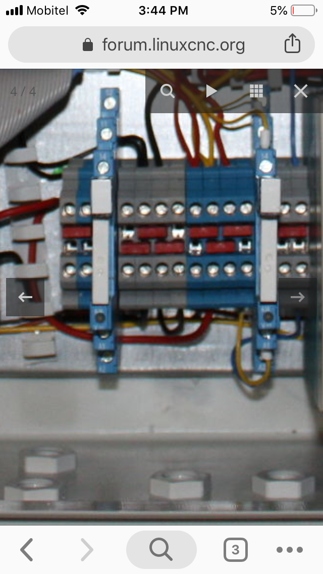

What is the name of this?
To find on eBay to buy it?

To drive a motor Fwd and Reverse, if it is a 3-phase motor, you can use 2 3-pole relays.
1 relay is on-off.
The other is used to reverse the motor.
Off Off = Off
Off On = Off
On Off = Fwd
On On = Rev
Is it a three-phase motor?
The same is probably true for a single phase reversible motor, but might need more poles to switch. You need to emulate what the reversing switch does with a relay.

Yes,it is a 3 phase 1.1hp motor.
From where the on off signals came?

motion.spindle-on
motion.spindle-forward
linuxcnc.org/docs/2.7/html/man/man9/moti....html#SPINDLE%20PINS
(or on LinuxCNC 2.8+
spindle.0.on
spindle.0.forward
linuxcnc.org/docs/2.8/html/man/man9/moti....html#SPINDLE%20PINS )
