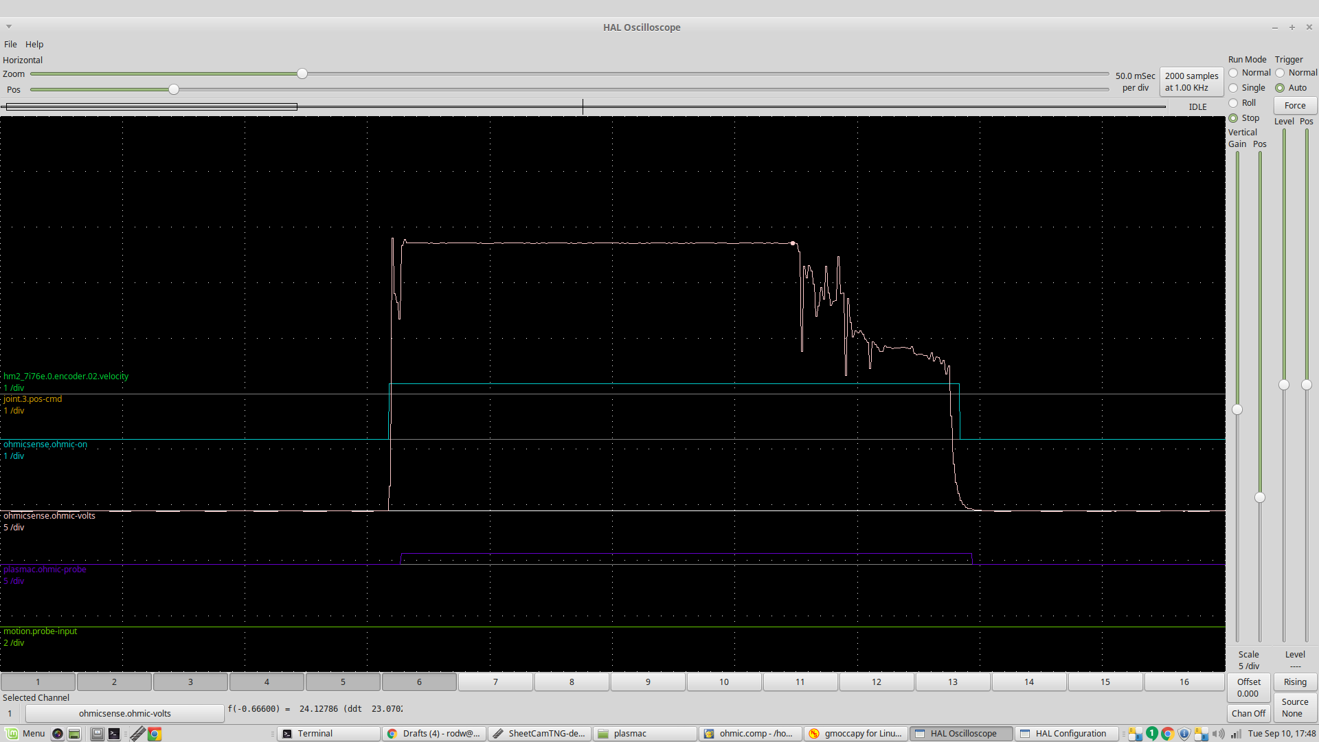

10 Sep 2019 08:27 #144683
Replied by rodw on topic Ohmic enable relay lopgic
Tommy, I think so. This is a plot I just did of an ohmic sense event. Pin to watch is ohmicsense.ohmic-on which is the probe signal. But the blue plasmac probe follows it as well
Here we turn the signal on at 18 volts and off at 5 volts. Plasmac probes back very slowly until it breaks contact so the off threshold is the important one and you can see its not triggered until all the noise subsides. I think it would be interesting if you set a low on threshold and smashed the probing at high velocity to speed up job cycle times.
I am getting a spurious probe signal reported by Plasmac on the first probe after opening a new file. I suspect either Phill or I are not setting a default value correctly. It does not bother plasmac, it still continues but I need to look further.
