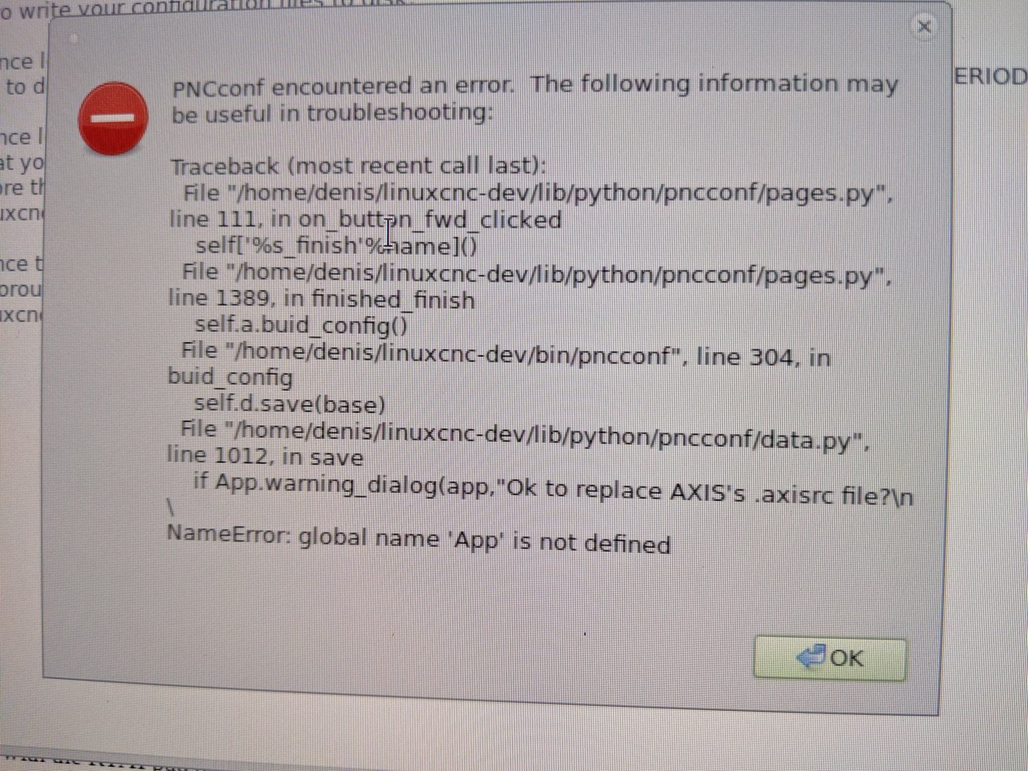

Pncconf error when pressing Done was created by bevins

There was another topic regarding this error today, Cmorley already pushed a fix for it and by now it should be ready to download or update.

I just installed Lcnc and it does it.

during one of the first windows in pncconf it has a checkbox for Starting Axis maximized. I checked it and got the error. When I rerun poncconf and made sure it was unchecked, it worked.
So this brings me to question where in the axisrc file allows you to start axis maximized?

Replied by cmorley on topic Pncconf error when pressing Done
i found the error in pncconf and will push the fix soon.
in the .axisrc file adding this should set AXIS maximized:
root_window.attributes('-fullscreen', True)
