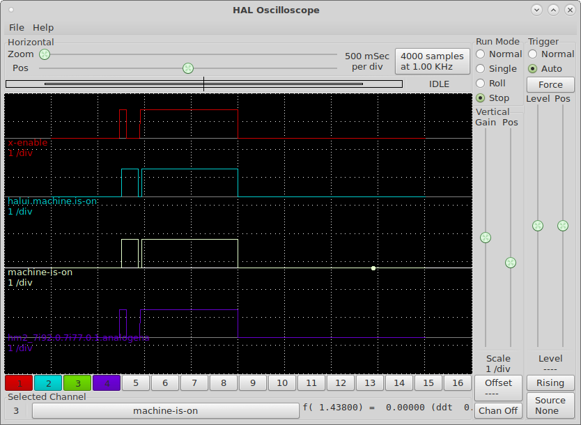

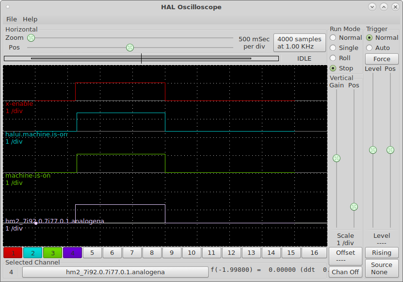

This is a weird one. Don't know what I am doing wrong. Really basic stuff. I am firing three relays with machine-is-on. They are used for various things but a major one is drive enable. The relays energize twice with Gmocappy. They click on, off then on again when I turn on the machine.
In Axis they don't do that. They just fire once.
Any ideas?
Any ideas?

Here is a video showing this behavior.
#Gmocappy custom.hal
net machine-is-on hm2_7i92.0.7i77.0.0.output-00 hm2_7i92.0.7i77.0.0.output-01 hm2_7i92.0.7i77.0.0.output-02
#Axis custom.hal

what drives the signal 'machine-is-on'?

When you press the on button in the gui.
Gmocappy version 3.08
/EDIT Sorry, halui,machine-is-on is driving machine-is-on.
Replied by bevins on topic Gmocappy fires relay twice
Chris M

I think what Chris meant is: what drives the 'machine-is-on' signal in the hal file
Could you post your hal files?
Replied by PCW on topic Gmocappy fires relay twice
Chris M

When hitting estop it clicks twice also.
