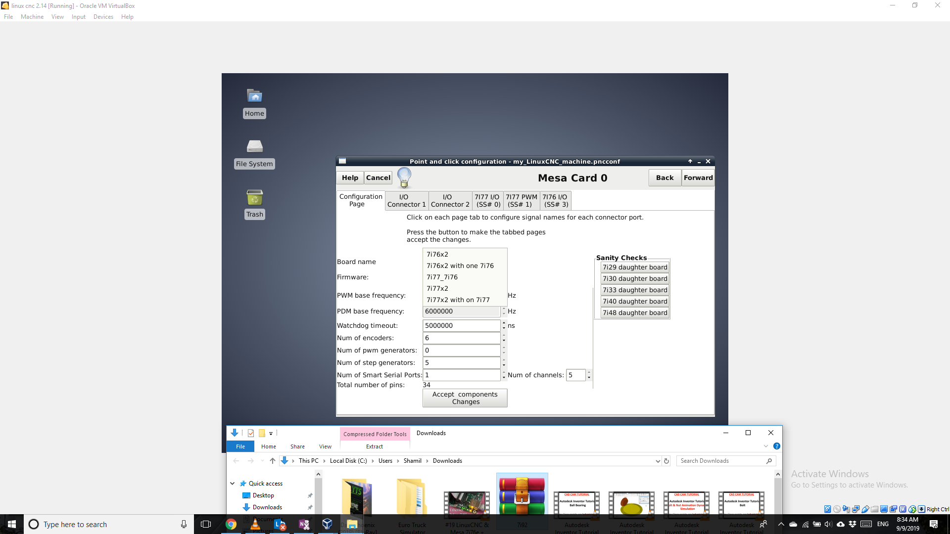

i deside to order 7i92 +7i77+7i78 but i have small problem
7i92_7i77x2D is this firmware match with 7i92+7i77+7i78
and also in pin copiger 7i92_7i77x2D firmware is not showing
how can i make it visible

Replied by pl7i92 on topic linix cnc recrofiting
you may ask PCW direct
for a better bitfile
the 7i92 is the same as 5i25 so you can use pncconf to get a base config
but you can also get lots of base here on forum as may using them
i got no servos i use only steppers
