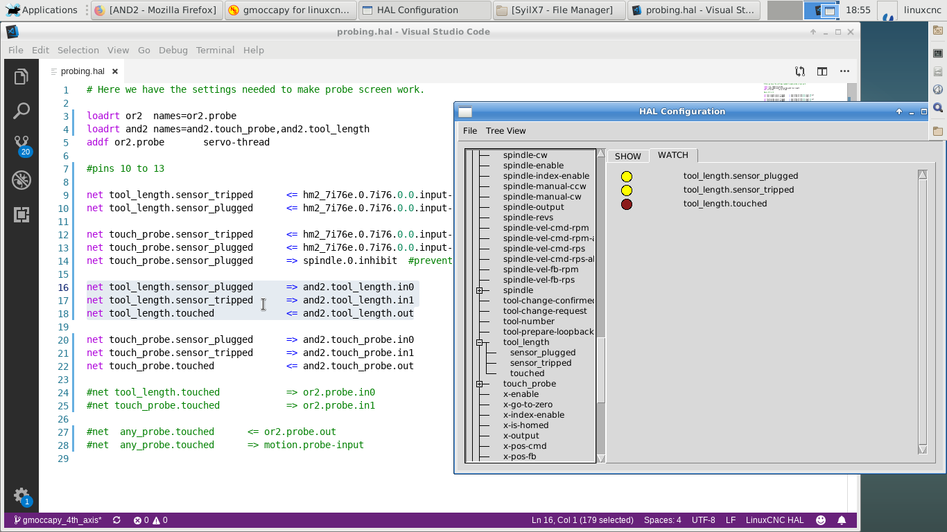

I am trying to set my probing sensors, and I wanna make linuxcnc aware when the sensors are plugged in.
I've used an and2 component, I have both plugged and tripped signals set to true but the result of and2 is not correct.
Any idea what I'm doing wrong?

13 Sep 2019 16:14 #145063
by mozmck
Replied by mozmck on topic and2 not correct?
In the image shown you add the or2 component to the servo thread but not the and2 components. They won't work if the thread doesn't run their update functions!
