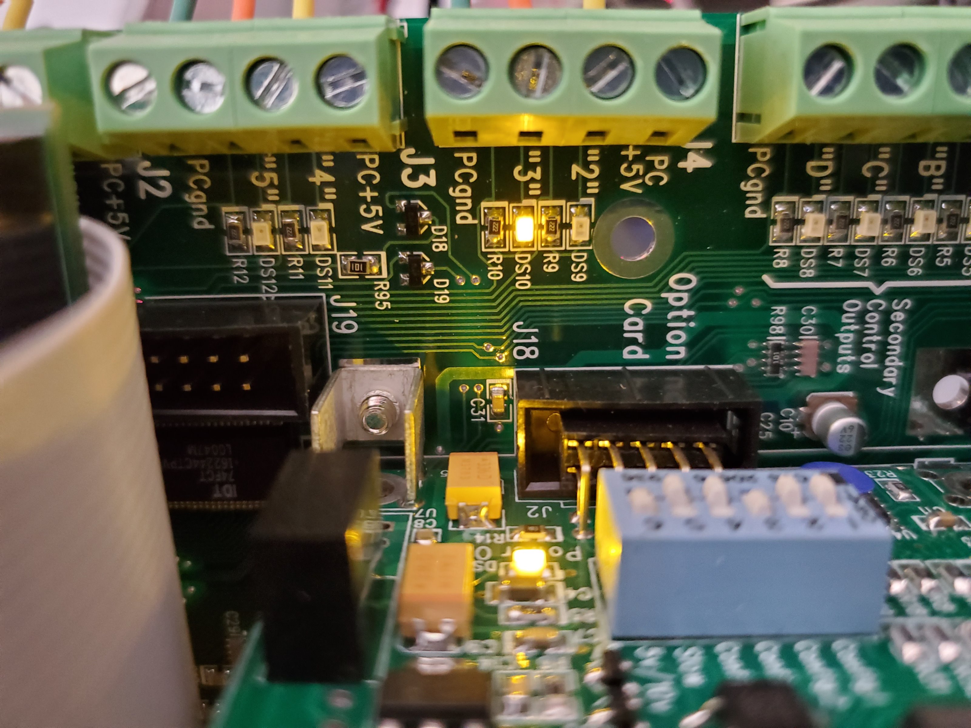

Hello all. I am pulling my hair out troubleshooting my x axis homing issue. First off I bought this machine second hand. It's a HF converted 3 axis mill. I had this issue when I first brought it home but after some fiddling it resolved its self.
The issue is during homing sequence it homes Z and Y perfectly then when it try's to home X the DRO will just keep searching but no movement at table.
Troubleshooting I have done is I replaced all wiring going to X axis. I know the new wiring is correct because if i swap X and Y plugs coming from my controller box the X axis moves and homes like Y axis would and I get no movement from Y axis.
I used a multimeter to test continuity of my parallel port cable and I did not observe any issues even when moving the cable around.
If I check ignore limits I get a no limit switch active message.
I don't understand how this can be since I just milled a part last night. I start it up this morning and boom the issue is back.
Any suggestions for troubleshooting would be awesome. I'm out of ideas.

Start by posting your hal and ini.
Does your X home switch show proper behaviour in hal show?

Can you jog the X axis before homing ?
That all points to a non functional drive inside the controller case, or a miss configuration in the hal file.

Hey thanks for the reply. I'm not quite sure how to check to see if its working correctly. Maybe with HAL scope? I was looking around in there today through the GUI but couldn't really see any difference between the X, Y or Z sensors. I'm pretty new to this Linux thing. I know how to modify INIT files but that about it.
Here are my INIT and HAL files. Maybe you could see something strange in there but it is just weird that it worked last night.

No, I can't. The only way I can get X axis to move is to swap X and Y connectors at the controller. Then X axis moves and homes and Y is completely dead. So problem follows.

That is the controller, one of the drives is not working.
You will have to open it and check if all the drives have their lights on.

16 Sep 2019 21:39 - 16 Sep 2019 21:41 #145341
by SRcnc
Replied by SRcnc on topic Where do I go from here? Troubleshooting X axis
So today I swapped X and Y axis drives. The problem is still present. I did notice on my PMDX-126 there is an led on the J4 connector Pin 3 that outputs to the X drive. J4 Pin 3 is fed by parallel port cable pin 3. I retested my parallel port cable and it still seems to be fine. all pins have less than and OHM. I watched the LED's while the machine was homing. My homing sequence is Z, Y, X. I watched some LED's on the connector for Z axis turn on and off during homing. I did the same for Y axis. Then when X tries to home it does nothing but the LED stays lit. Any ideas?
Attached is a picture of the LED.
Last edit: 16 Sep 2019 21:41 by SRcnc.
- Posts: 21815
- Thank you received: 7450
16 Sep 2019 23:32 #145347
Replied by tommylight on topic Where do I go from here? Troubleshooting X axis
Disconnect the wires going to the X axis drive and check that LED again.
- SRcnc
- Posts: 22
17 Sep 2019 00:40 #145360
by SRcnc
Okay I disconnected wires to X axis drive and the light is still on. I tested voltage at the STEP and DIRECTION wires out of the PMDX into the drives. Y and Z step and direction wires have 12mv. Step and direction for X have 0V and 12V. I don't know if this is because its not hooked up to the drive or what. I'll test the voltage tomorrow when it's hooked up to the drive.
