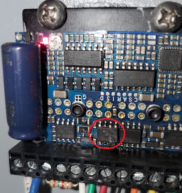

If you swapped the X and Y axis drives, the problem should have changed to the Y axis if it was the drive.
Did the issue show up on the Y axis?
Replied by bevins on topic Where do I go from here? Troubleshooting X axis
So today I swapped X and Y axis drives. The problem is still present. I did notice on my PMDX-126 there is an led on the J4 connector Pin 3 that outputs to the X drive. J4 Pin 3 is fed by parallel port cable pin 3. I retested my parallel port cable and it still seems to be fine. all pins have less than and OHM. I watched the LED's while the machine was homing. My homing sequence is Z, Y, X. I watched some LED's on the connector for Z axis turn on and off during homing. I did the same for Y axis. Then when X tries to home it does nothing but the LED stays lit. Any ideas?
Attached is a picture of the LED.

No it did not follow the drive. So that rules out the drives for me. I ordered a new parallel cable 1 to 1 last night. Should be here Friday. I just want to rule that out before I start testing every wire and everything.

Okay guys I think I found my issue. I believe my X direction Gecko driver is burnt up.
I compared voltages on all 12 pins of X, Y and Z drivers. I found an anomaly on pins 5, 6, 7, 8 and 11.
On Y and Z voltages are as follows: Pin 5 - 13v
Pin 6 - 16v
Pin 7 - 14.37v
Pin 8 - 14.5v
Pin 11 - 6.97v
On X drive voltages are as follows: Pin 5 - 33.98v
Pin 6 - 34.0v
Pin 7 - 33.48v
Pin 8 - 33.46v
Pin 11 - 30.92v
I then noticed a burned looking chip on the X Gecko drive. You can see it in the picture.
I'm assuming the Geckos resistance circuit isn't working. I tested all three resistors and they all read around 1.470k Ohms. So I don't think the resistor is the issue.
I guess I need to order a new drive or see if it can be repaired.
Any guesses to why the chip would of burnt in the first place? I don't want it to happen again.

Many stepper drivers are easily damaged if the motor is disconnected. So I would check your X motor cables. Check them while flexing if they move during machining.

You know that would make sense. The X axis wiring was in bad shape. I thought that was the source of my issue. I rewired it after the issue started so it should be good to go when I get the new driver in. I am trying to figure out a solution for strain relief when the axis moves. The wires kind of dangle off of the stepper and drag in the chips and coolant. I have a cable chain on my Z axis but I don't think it would be a fitting solution for the X. Any suggestions?
