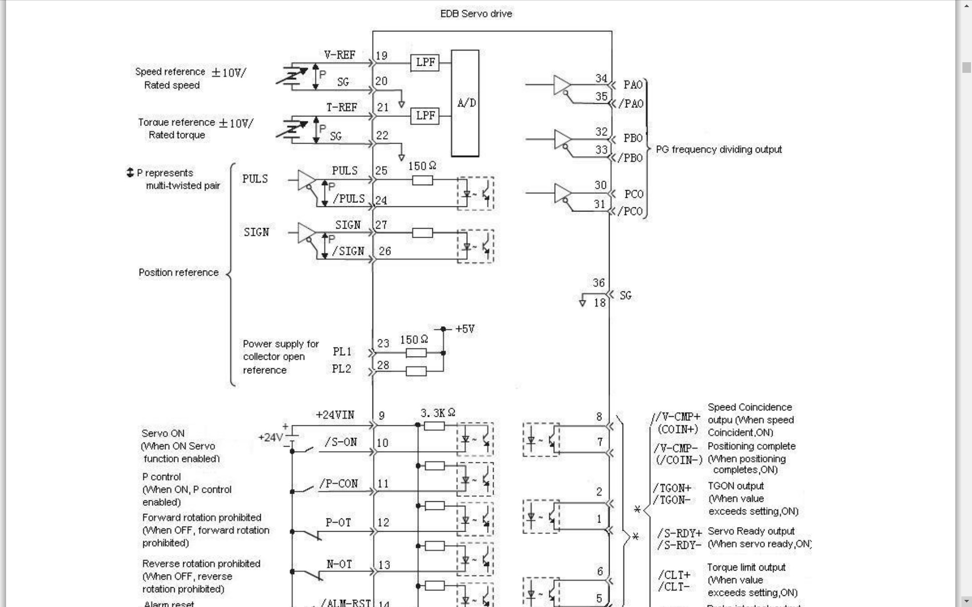

I got classical CNC router with XYZ axis, it has ESTUN servo drivers EDB-15APA controlling by some ABB controller and it all work from some windows programm.
I never have before CNC machine with servo's and do not have experience to configure it and which control protocol choose or some else, I just now that there are has some OpenCan EtherCat and thats all.
I want reconfiguring that servo drivers to use it with our LinuxCNC, and I want ask it is possible or not and how configure it may be it has some example to do it for my case.
I find manual to it servo driver I think it must help us to understand is it possible or not. - MANUAL for EDB series
I read it and see couple interesting things for me:)
in first atachment - screenshoot by 13 page
it can be controlled by position reference through PULS (25 and 24 pin) , SIGN (26 and 27 pin) and PL1 PL2 (23 and 28 pin)
It sounds like full analog with our classical style controlling by step drivers - STEP DIR ENABLE
and after when I saw second attachment- screenshoot by 36 page
I want belive that is true and we can controll it servo by classical method to give them pulse from step dir
please help me understand am I right or not
or may be you now some other way?
Thank you.

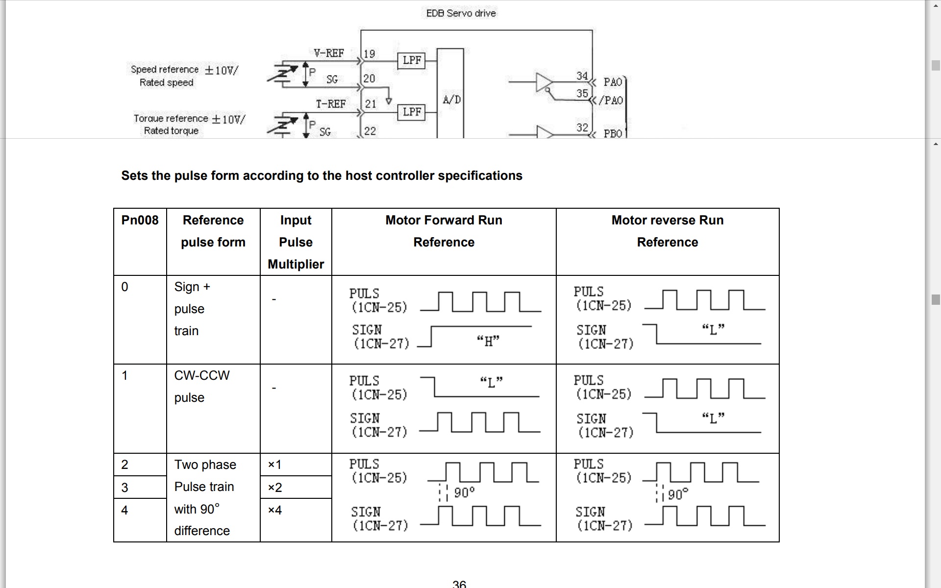

Replied by PCW on topic Can I use ESTUN servo drivers EDB-15APA with LinuxCNC?
If the drives can interface via EtherCAT you should be able to control the with
LinuxCNC +PC with no additional hardware.
If they do not have a EtherCAT interface you can chose step/dir position mode
or analog velocity mode. Both would typically require some additional
interface hardware (the step/dir case is simpler though)

- Posts: 18025
- Thank you received: 5295
19 Sep 2019 20:52 #145625
They call step/dir "pulse/sign" (page 13)
The following user(s) said Thank You: zaxlex
- zaxlex
- Posts: 13
19 Sep 2019 21:16 #145629
by zaxlex
and I found another couple control modes - it is Speed control mode and Torque control mode
and I want now LinuxCNC can work with it modes or not, I ask it because I want insert in old system some releys block to switch wire from old windows system to new LinuxCNC and back, and I want that control mode will be same in both case.
Replied by zaxlex on topic Can I use ESTUN servo drivers EDB-15APA with LinuxCNC?
If I'm right understand Position control mode it is what I need - it is same that step/dir control mode, isn't it?They call step/dir "pulse/sign" (page 13)
- Posts: 19888
- Thank you received: 4646
20 Sep 2019 12:13 #145663
Replied by andypugh on topic Can I use ESTUN servo drivers EDB-15APA with LinuxCNC?
You are spoilt for choice, you can control that drive any way you want.
What type of feedback do the servo motors have?
