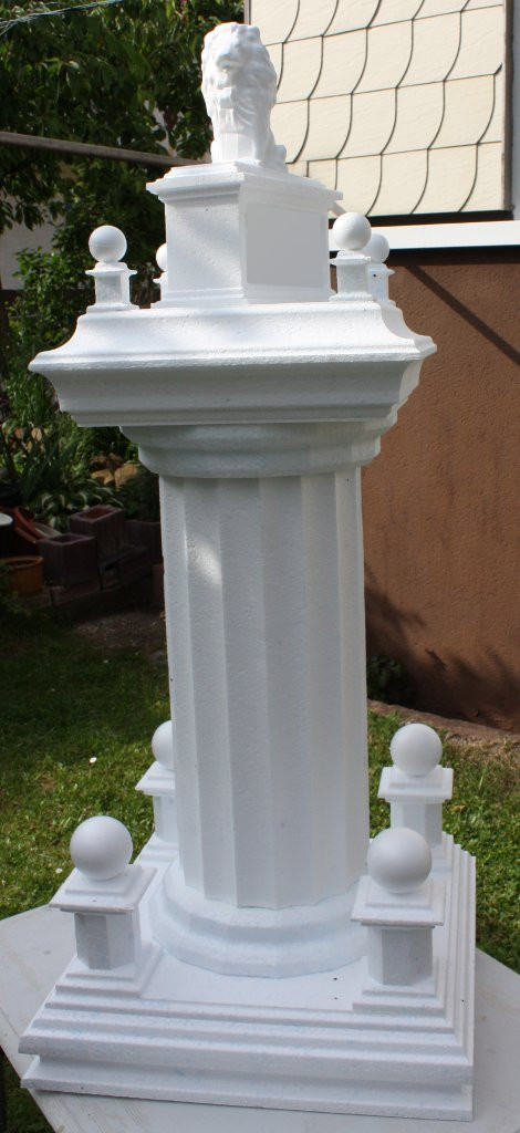

I have a couple of lasers I’m using for part alignment. They’re simply running off a power supply at the moment but I’d like to be able to toggle them on and off via my keyboard. Is this possible? Are there any tutorials for this sort of thing?
I’m also using the CNC as a hot wire foam cutter. Again the hot wire attachment is currently running off a separate power supply and I’d like to be able to turn it off and on from the keyboard. All help gratefully received, many thanks in advance.
