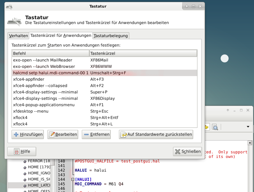

28 Sep 2019 02:35 - 28 Sep 2019 02:52 #146464
by MaHa
Replied by MaHa on topic Program linuxcnc?
Just found a easy way to do your keyboard stuff. It worked on my sim, debian stretch testing.
On the desktop goto properties, keyboard. There i was able to enter commands, with keyboard shortcuts.
After starting Axis, this were executed by shortcut. Have a look in axis, help, keyboard, because there are so many keyboard shortcuts already, avoid a colision. So just enter the mdi command call ,example in screenshot. 1 at the end sets true, if 0 is there, nothing happen.
All you need to do, are the .ini file entrys in Halui section, as shown in previous post (M64,M65) and connect your relay to the switched pins.
And also edit the .hal file, net motion.digital-out as example.

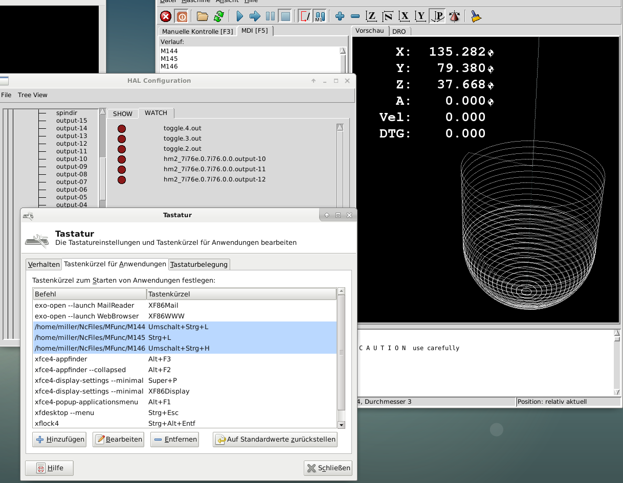

30 Sep 2019 19:29 #146775
by MaHa
Even it seems the interrest in this problem is fading, i could not leave a half finished solution behind, which confuses more than help.
Ok, here is the final, pretty easy to do. I choose User defined M funktion to simulate momentary switch. So with the before shown way, assigning keyboard keys to M function, halcmd or whatever Laser1 Laser2 and Hotwire can be turned on off by the same Key combination, because toogle used. Even it's a bit ugly, the same M function can be used from MDI or Gcode.
The M function must be made executable. And .txt must be removed.
The toggle part is in custom.hal, you need to do the entry in .ini, as
[HAL]
HALFILE = custom.hal
In the your-machine.hal file toogle needs 3 entrys. In my case i had count=2, so changed to count=5. And each needs addf.
And in custom.hal the hm2 part enter your output to switch. If your relay has more than 60ma, maybe a flyback diode required.
loadrt toggle count=5
addf toggle.0 servo-thread
addf toggle.1 servo-thread
addf toggle.2 servo-thread
addf toggle.3 servo-thread
addf toggle.4 servo-thread
