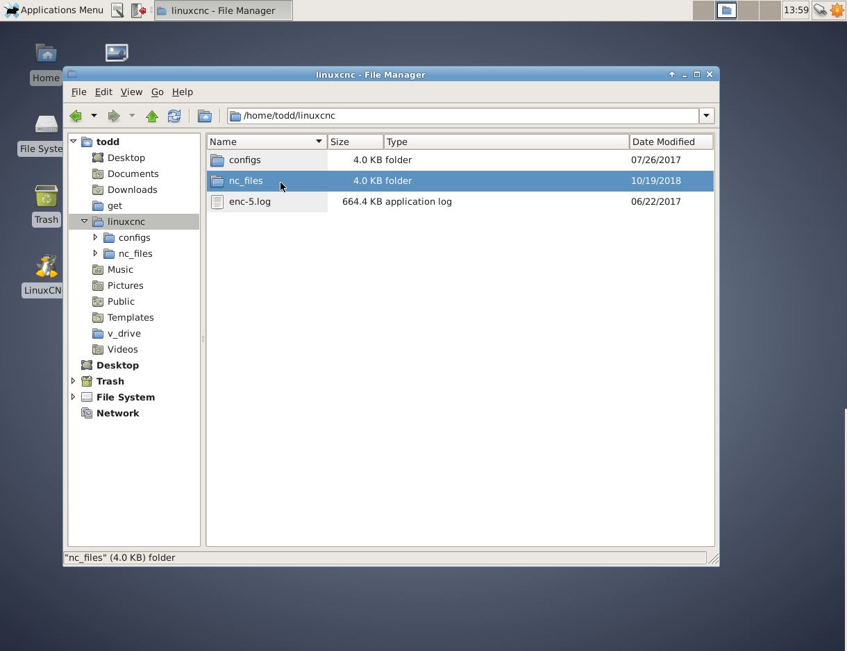

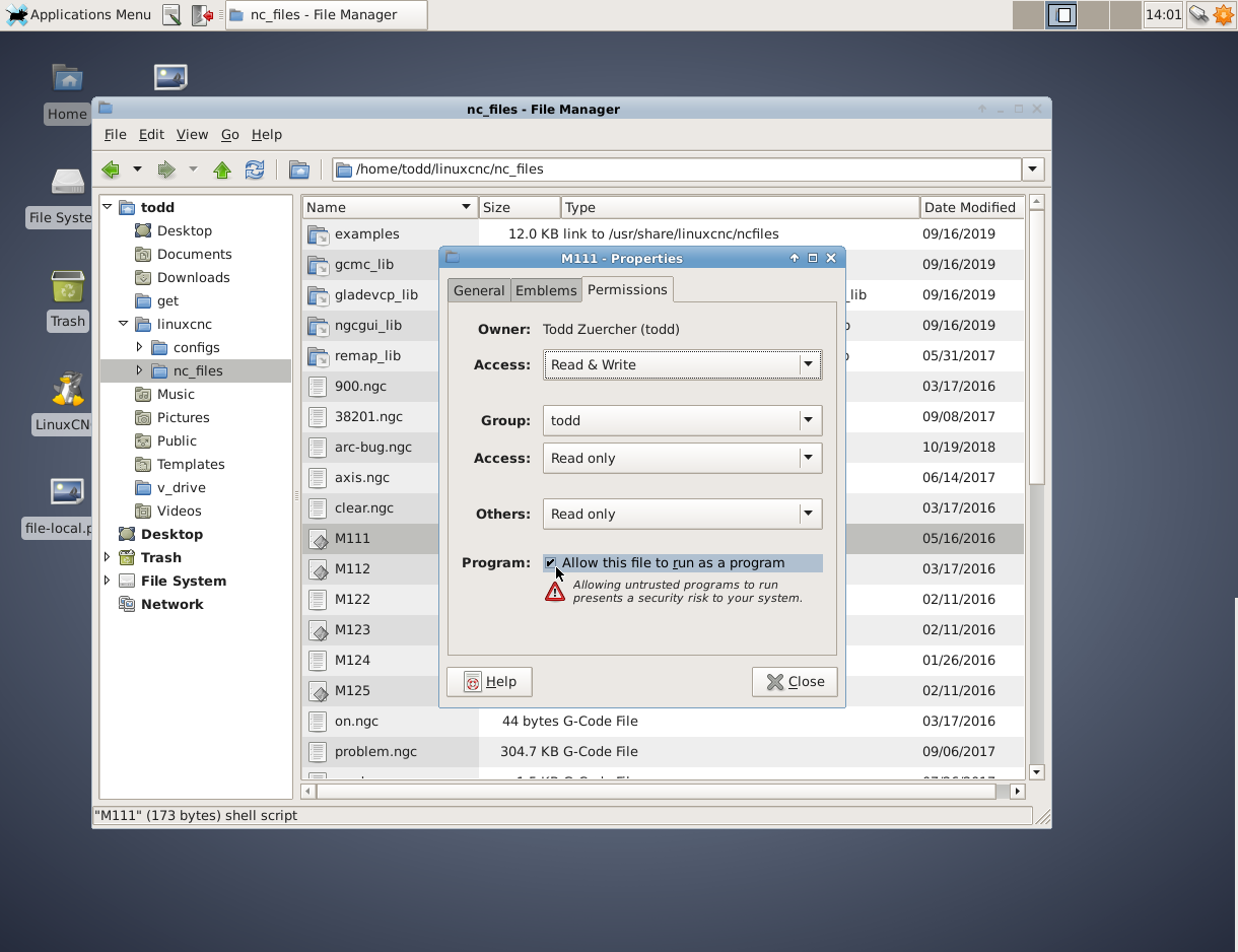

30 Sep 2019 18:07 - 30 Sep 2019 18:08 #146734
Replied by Todd Zuercher on topic What's the easiest way to write and load a simple program?
Last edit: 30 Sep 2019 18:08 by Todd Zuercher.
The following user(s) said Thank You: Scot

Todd, thank you SOOO much! This helps more than you know! I'm a very visual learner and limited in my command line abilities. But I'm learning fast. This makes it much easier.
I did have a rough idea of where I should put those files, but making them executable was giving me issues. I was literally in the middle of studying how to do that when your post came up.
Thanks again. This is great!

30 Sep 2019 19:08 #146746
You don't need root privileges, and you should not be using them to do this.
The file should not have any suffix. (it will not work with a suffix added)
What is the first line or two in your file?
if it does not start with
#!/bin/sh
or
#!/bin/bash
Then the file browser (Thunar) won't recognize it as a shell script and won't give the option of setting it as executable.
(or the same happens if the file name has a file extension.)

30 Sep 2019 19:11 #146747
by Scot
Replied by Scot on topic What's the easiest way to write and load a simple program?
WHACKY!
I just opened mouspad in my profile, copied the example text in the body of the file and saved it as M101. Then when I saved it, it came up with the icon with the gears on it, automatically? It didn't do that in root. Strange. I was able to move it into my home/scot/linuxcnc/nc_files folder without a hassle, too. Then I rightclicked on it and checked the permissions and bang! There was the check-box for making it run as a program.
Now all I have to do is to write the proper code to marry it to the PWM board and I'll be in business.
It was all about where I placed it. Placing it in the mfiles folder was only able to be done in root and not necessary.
I should have stuck with linux back a long time ago. But I'm getting the gist by learning the need-to-know stuff.
Thanks again. This was REALLY helpful! I'll keep you posted. It means a bunch.
Scot
