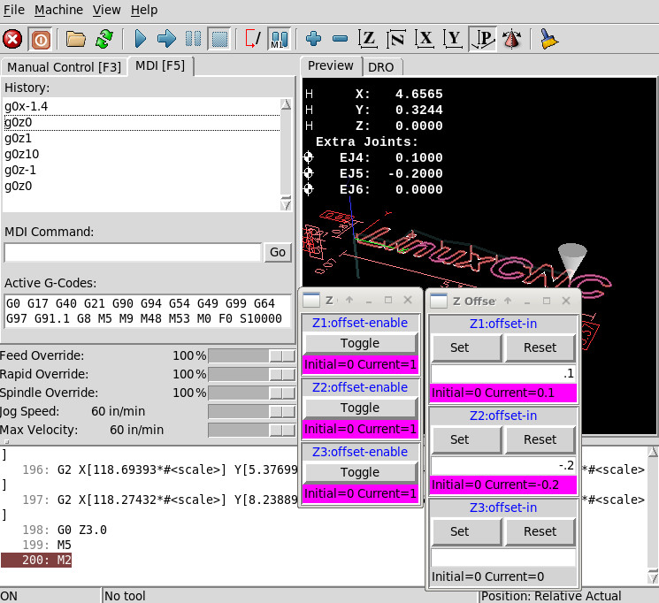

I have an idea for a machine I'm considering a retrofit for.
The machine in question is a 4 spindle router. used for carving and engraving 4 items at a time. Each spindle is mounted to an independent Z-axis, labled Z,U,V,W in the current control. The machine is used almost exclusively for carving 4x of the same thing. And the g-code is set up with only XYZ commands but uses a special g-code to temporarily slave all 4 vertical axis together so they follow the same Z command. The temporary slaving command works like this you command all of the axis you wish to slave together to a common position in the coordinate system you are using (such as your safe retract height above the material. then issue the slaving commad, then all the slaved axis follow the master one's commands until released. This machine also is a gantry with a slaved joint for the Y axis, this I will want to keep the current gantry features currently used in 2.8+.
I have setup similar machines in Linuxcnc with 2 Z-axis (ZW) and set up temporary slaving with some complicated hal kludgery and it works OK. But If I do this bigger machine I want to setup something better. I was thinking the ideal place to do this would be in a custom kinematics file. But I have not been able to pull together the programming skills to do it.
I think I have some good ideas how to make the Kinematics work but I need some help putting the pieces together. In other words I have no idea how to program them.
My Ideas so far are to have three hal pins that control the slaving, one bool that activates/deactivates the temporary slaving and two S32s the that their values are used to set which of the axis and joints are to be slaved. One S32 will set which of the axis will be the master axis, and the other S32 sets which joints(or axis) will be slaved to the master one.
Will it be possible for this to have the DROs for the slaved axis continue to show the true positions without causing following error or will they have to be stuck at the point where they were slaved? Will I get a following error when unslaving if all of the axis are not returned to the same position relative to each other as when they were slaved?

With existing trivkins in 2.8~pre* (and master) you can
assign specific joints to U,V,W and use a [FILTER] to
modify gcode so that the U,V,W coordinate values
are identical to the Z values.
This method uses existing features instead of custom
kinematics. I don't think custom kinematics is very
helpful since the tool heights are likely to need
touch-off for both the Z and U,V,W coordinates to
accomodate varying tool lengths. Touch-off is a
coordinate (axis letter) function not a joint
(pre-homing) function.
The attached sim config illustrates an ini file
and supplies a simple filter script (zreplicate.tcl).

After some more thought, I've updated the sim config:
1) A single master gcode file for demonstration is
test.ngc. This file uses X,Y,Z only.
2) Symbolic links are made to test.ngc to identify
which of the Z,U,V,W coordinates will be used
when the linked file is selected based on the
link file extension:
This means you can use any combination of 1,2,3 or 4
spindles. No coordinate is specifically "master";
each coordinate in use should be touched-off to set
tool height reference, unused coordinates should be
moved (up) to a safe position before running.

Another suggestion is use of the (new) extrajoints
capabilities available in the master branch. The
extrajoints are homed normally but then use independent
postion control. For slaving multiple spindles, the
extrajoints' position commands are derived from the
commands sent to the joint used for the normal Z coordinate.
Ref: motion man page (master branch):
linuxcnc.org/docs/master/html/man/man9/motion.9.html
The attached config uses 3 extrajoints that follow the
motion of the Z coordinate. Management of height
offsets of these 'following' joints is controlled by
summing individual offsets to the extrajoints'
posthome-cmd pins.
The method is extensible to as many joints as are
available after accomodating the joints used for
kinematics. The master branch supports 16 joints total
so a 4 joint XYZY (gantry) config could add 12 more
'following' extra joints.
Notes:
1) Offsets are applied using a limit3 component so
that velocity/acceleration can be managed to avoid
bumps or following errors when the operator
updates the extrajoints' offsets.
2) The extrajoints velocity/acceleration limits
should match or exceed those for the controlling
joint.
3) Offset management is demonstrated with simple
sim_pin guis but a real application could use a custom
pyvcp panel or jogwheels connected to an encoder counter
followed by a float conversion.
posthome-cmd pins.
Notes:
joint.
