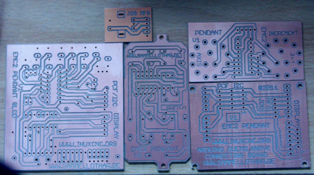

- pl7i92
- Posts: 1872
- Thank you received: 358
24 Oct 2019 17:42 - 24 Oct 2019 17:44 #148720
by pl7i92
Replied by pl7i92 on topic Starting information for CNC newbies
Last edit: 24 Oct 2019 17:44 by pl7i92. Reason: image
