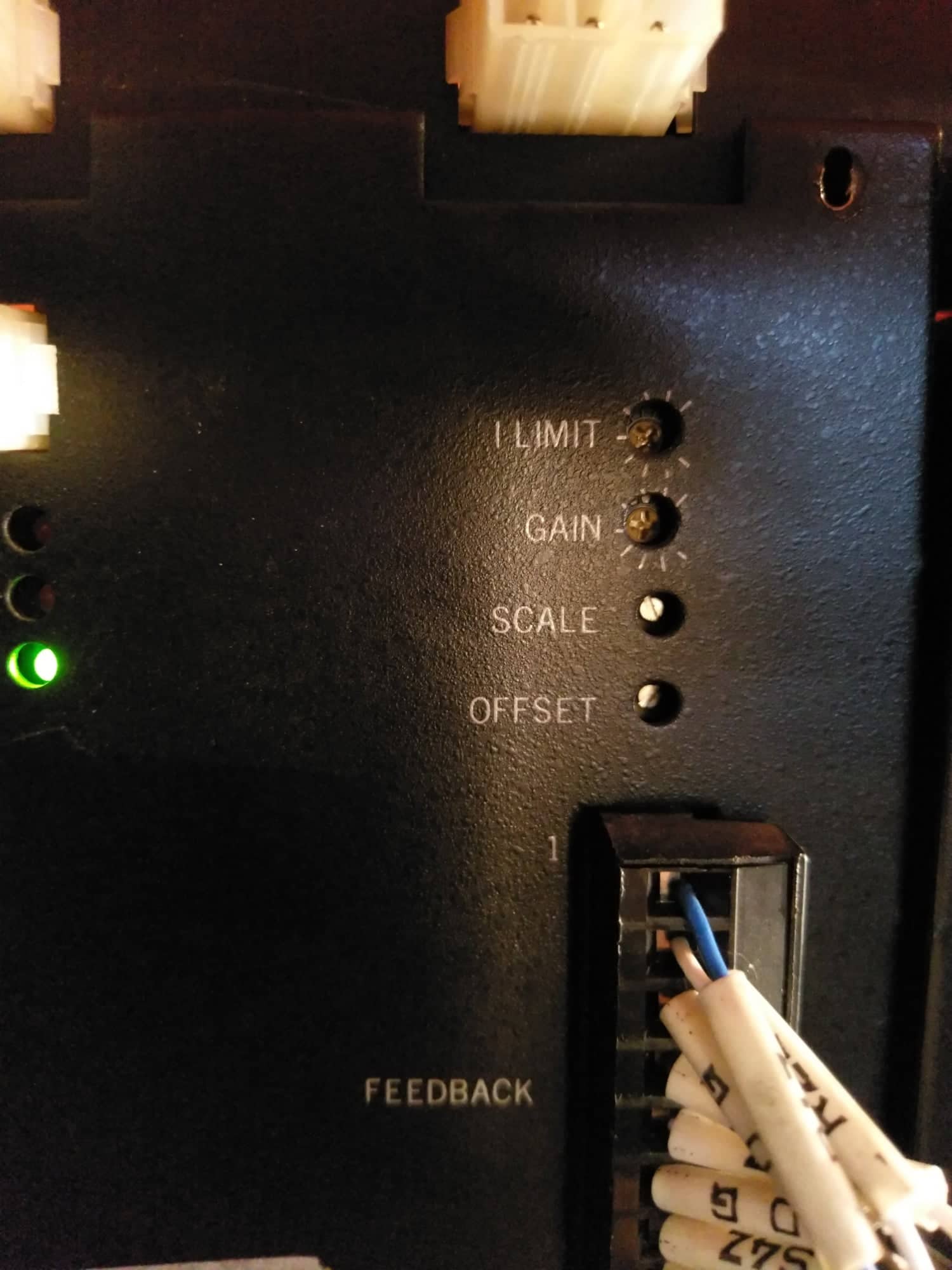

this is drive module
in this module x drive card dead and we repair it replase igbt and some control circuit components

drive has scale and offset (variable resistors) rotate them and make motor to stop.stable

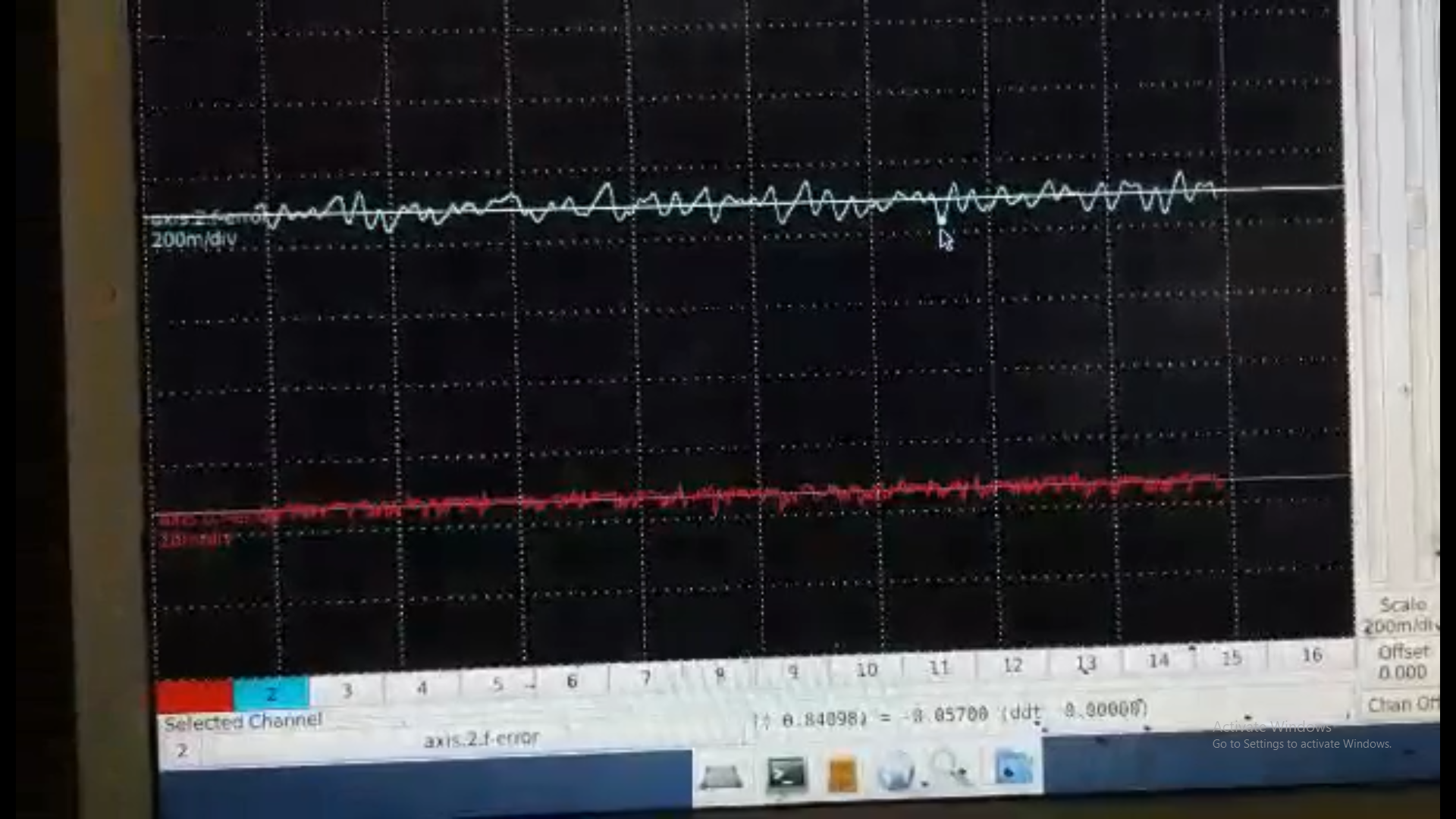

we move motor to 20.000 it goes 20 .000 but oscillate between 19.993 to 20.004
hall scope chart show
Z is oscillating largely it position error cant get in near 0.000 by drive

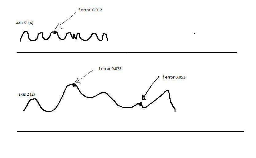

In MDI mode i run Z (g1 f 400 z-100) position is ok ,, motor moving with following error ( 0.018) use FF1 and FF2 low the followin
to 0..004
hall scope show like that
I connect motor to load power up and enable drive it hold Z axis without oscillate move very smooth position is ok I ZERO the machine axis in 0.000 position I move axis to 100.000 axis move to 100.000 I check movement in using dial gauge it ok with position
I again connect Y drive card enable drive Z fall -0.078 position error is also come and oscillating again 0.000 to 0.002 value

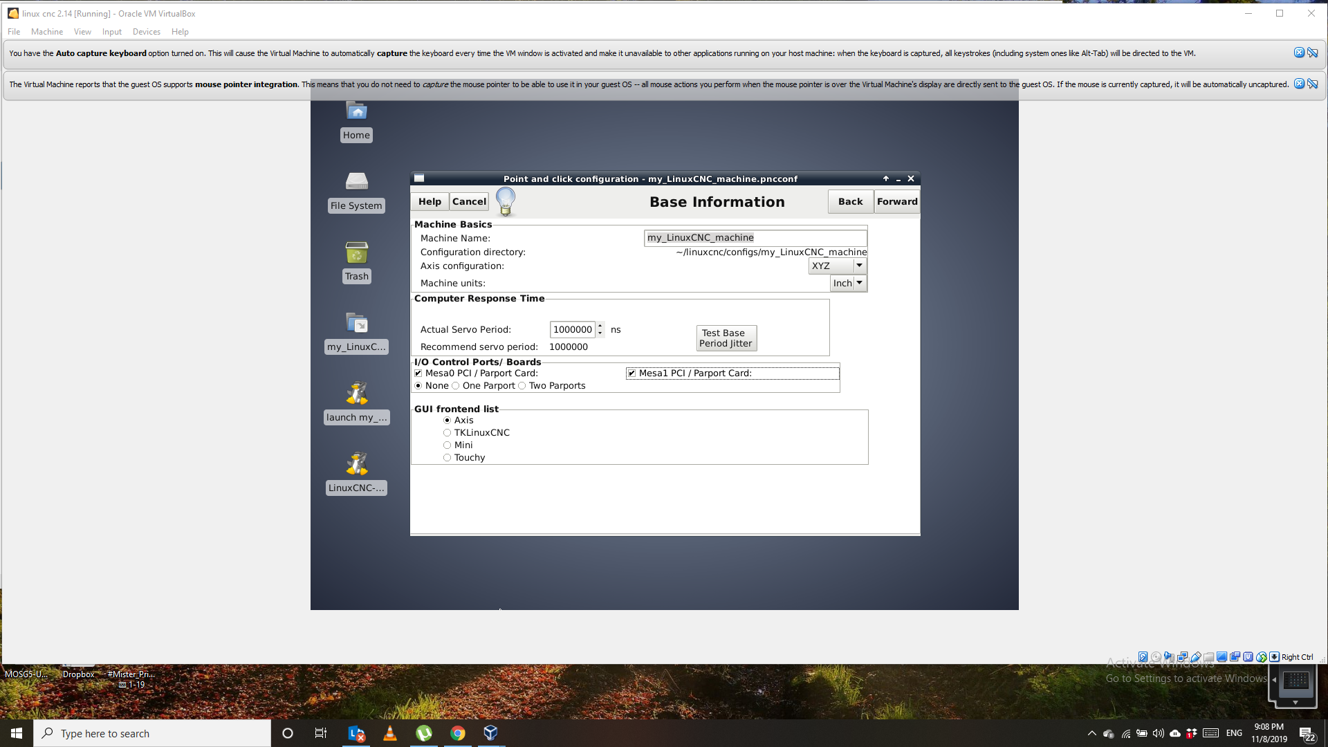

@@ I have new 2 servo drive with motors im planing to run them in puls and direction

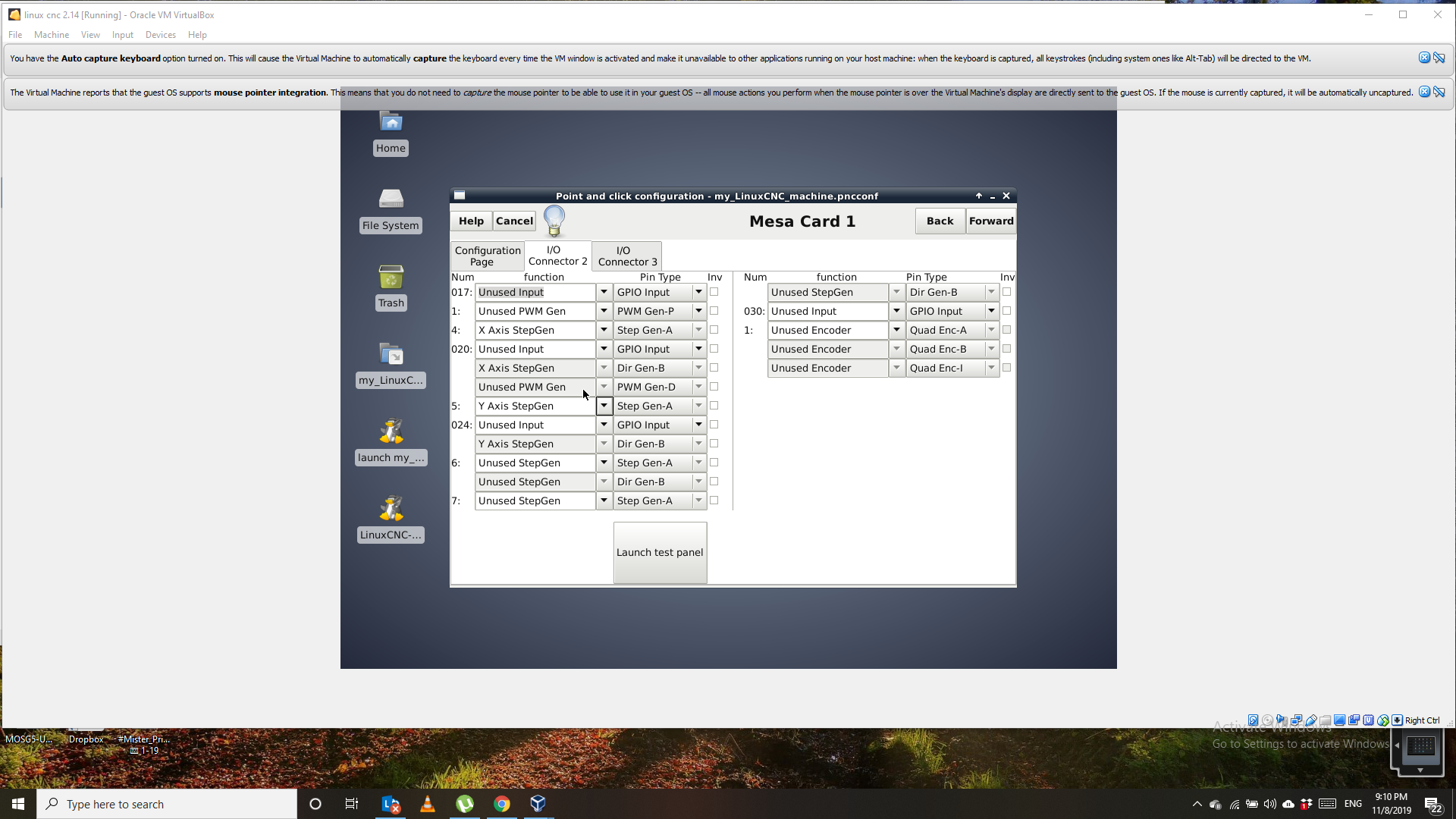

i have another 5i25 mesa card and write (5i25_prob_rfx2.bit) firmware to that card
and i connect 2 mesa card to pc mesa 0 with 5i25+7i77
mesa 1 step direction
i configure pncconf wizard with like that

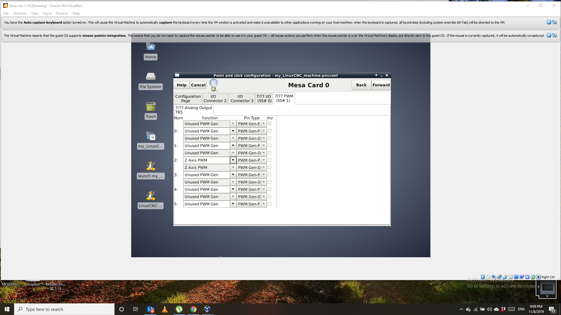

open this cnc file, i enable the machine with linux cnc my Z analog servo motor moving slowly.
i make another configure pncconf wizard for 1 mesa card (5i25=7i77) and enable machine from linux cnc Z analog servo is ok
motor is not moving.
then i open 2 mesa card cnc file and enable machine z moving slowly I Change P value of Z ,, put P=2 / P=10 / P=20
P=50 P=100 for p gain and nothing change.
are we cant use 2 mesa card to 1 pc
or power issue of pc
or other reason

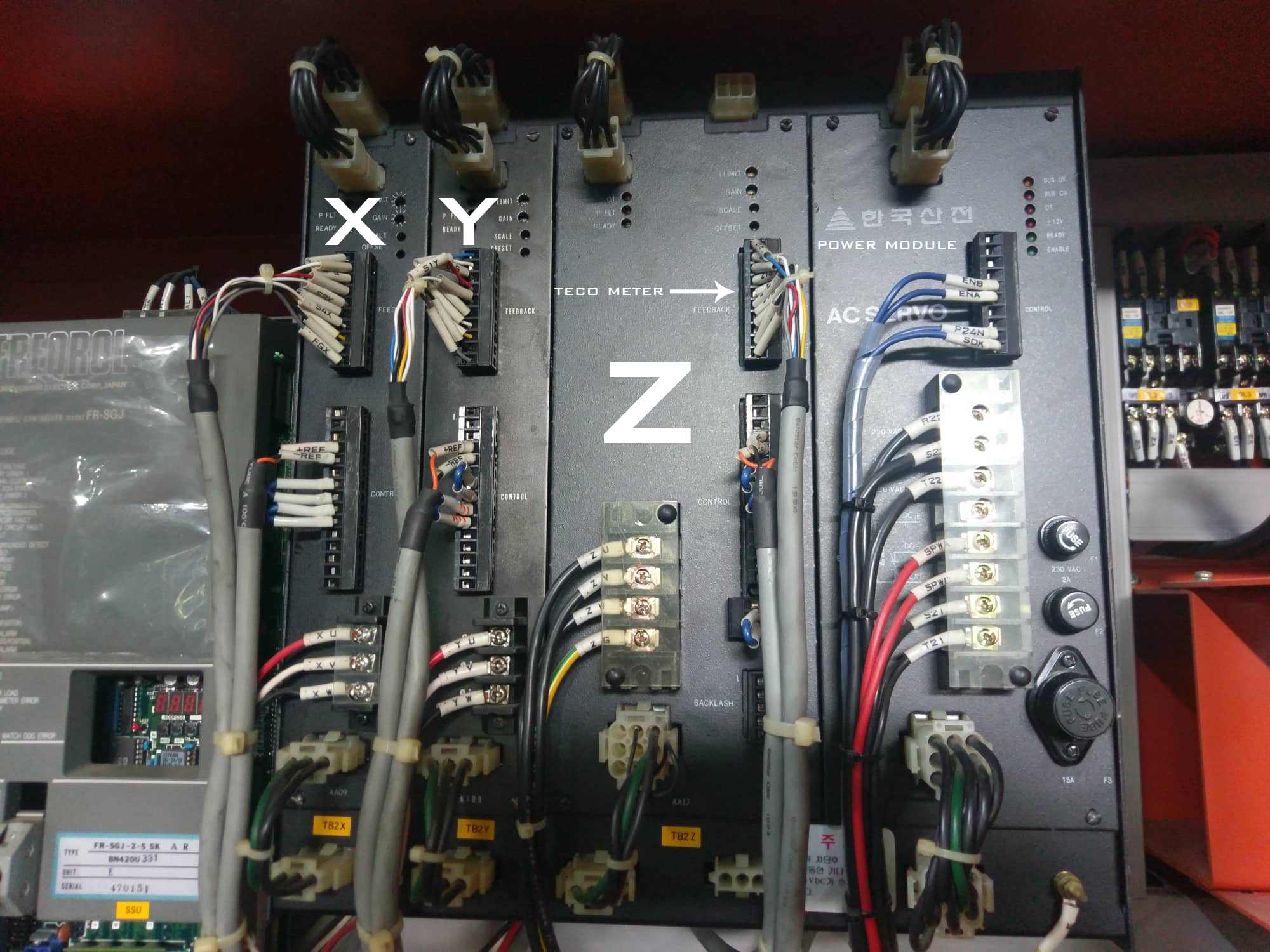

I'm retrofit cnc milling maching with linux cnc it has analog servo drive module with Z 18 NM , X 5.6 NM ,Y 5.6 NM servo motors (teco feed back get in to drive and motor has incrimantal encoder connect to controller)
i using 5i25+7i77 mesa cards.

If those are metric numbers, that's not bad.
Small dithering can be reduced by adding some deadband
at the expense of following error
If reducing the P value (and D and I) to 0 doesn't stop the dithering, that
suggests a noise issue
If you need more output zero adjust you can set the PID bias pin to a small value
Note the you typically need rather large values of I for relatively quick response
( Caution! too high I values can result in slow large amplitude oscillations so set reasonable ferror values when tuning)

hi pcw
thanks for your reply
today i try with power up Y drive card and Z drive card together ..
I put Y P = 1,
I = 0
D =0
ff1= 0.01
And Z values are not change and leave last time value
i enable drive through linux cnc Z not oscillating Y is also not oscillating
but z is move Z = -0.057 down direction in Y is also Y= 0.013 value .I ZERO the machine but position is not set in 0.000 it set Z for -0.057 Y for 0.013 .
in both axis with small oscillating change value between -0.057 to -0.058
I move Z in MDI (g1 f400 Z-20) it goes Z= 20.058 I move machine in MDI(g1 f400 Z0.000) machine came to Z=0.057 not came to 0.000
I change PID bias value and set ZERO to Z= 0.001
then i move machine it goes right position and came to 0.001
Then i start tune Y axis
I increase P value of Y P=2 P=3 like that
my Z axis Zero position is change again it came to -0.015 ( im not change any value of Z )
I set Y axis p gain to P=5
my Z axis zero position change to -0.042
Z position error is came again.
I again remove Y drive card from drive module and power up and Z pid bias to bias=0 problem solved .
With one drive card module is ok.
is this happen in some fault in drive module or some other thing.
