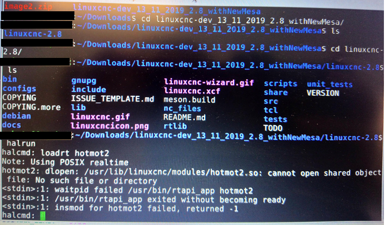

Replied by PCW on topic Mesa Flash - Mesa 7i94.
That error means that you did not move the included Makefile that includes the xy2mod object to the src directory
hostmot2-objs := \
hal/drivers/mesa-hostmot2/hostmot2.o \
hal/drivers/mesa-hostmot2/ioport.o \
hal/drivers/mesa-hostmot2/encoder.o \
hal/drivers/mesa-hostmot2/abs_encoder.o\
hal/drivers/mesa-hostmot2/resolver.o \
hal/drivers/mesa-hostmot2/pwmgen.o \
hal/drivers/mesa-hostmot2/inmux.o \
hal/drivers/mesa-hostmot2/xy2mod.o \ <<<<<<<<<<<<<<<<<<<<<<<<<<<<<<<
hostmot2-objs := \
its hostmot2 not hotmot2
- Moreira
- Posts: 16

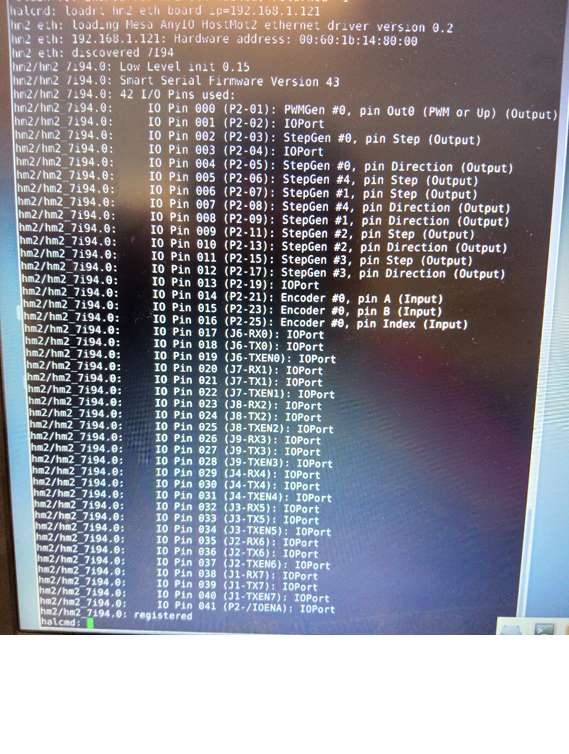

13 Nov 2019 15:32 #150302
by Moreira
Replied by Moreira on topic Mesa Flash - Mesa 7i94.
PCW you were right!
I forgot to copy the makefile into the source directory!
It's working now!! I can load the linux CNC and It recognises the board 7i94.
Thanks a lot!!

Replied by andypugh on topic Mesa Flash - Mesa 7i94.
My suggested procedure still has some things going for it, as it takes a lot of surrounding stuff out of the equation.
But it does need to be "hostmot2".
Another tip, you can use the command line to connect to a live system:That allows you link and unlink pins, load and unload HAL components, start halmeters (loadusr halmeter pin motion.program-line for example), start the halscope (loadusr halscope) etc etc.
Anything you can do in a HAL file you can do live at the command line.
halcmd -kfAnything you can do in a HAL file you can do live at the command line.
