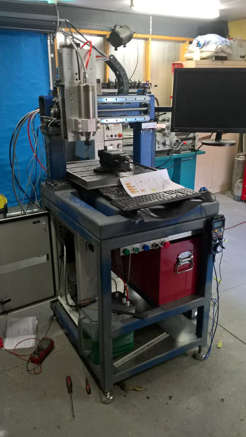

Thanks Andy
Mine is a fixed gantry style, seems to be working the way I want it to at the moment, but I'll revisit the pendant when I understand everything more.
It's very much a work in progress, here's a picture of it's current shape. BTW, thanks for your input.
