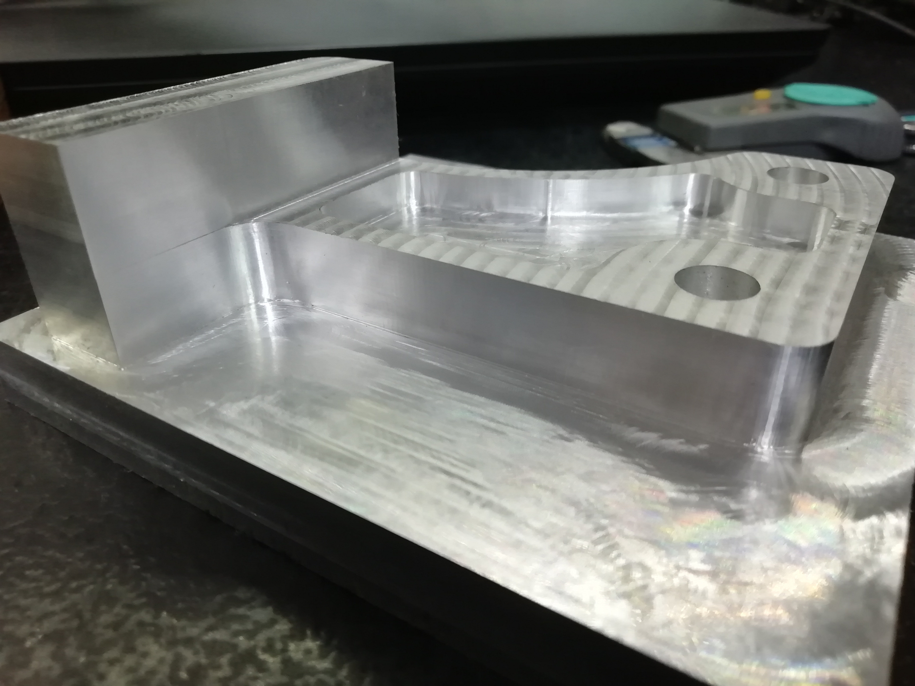

Good morning, I speak to see if you can help me with a problem in my CNC milling machine.
The problem is a vibration that appears only when a circular interpolation between X-Y + is running. It only happens in this quadrant. I thought it was due to the lack of rigidity of the machine, which is homemade ... but in the rest of the movements the machine works very well.
I discovered that by introducing a G64 P0.05 to introduce more tolerance in the movements in my line of code, I managed to reduce the vibration, so it smells to me that this problem comes from a bad configuration of stepper motors.
If I generate CAM code in the form of multipoints, or in the form of arcs is indifferent, the same vibrates.
I don't know very well where to start looking for the solution. Increase the value of microsteping? (Is it at 3200 / rev) or maybe modify some value in the hal?

That sounds like a bad bearing or reduction or belt tensioning, not software/stepper issue.
remove the motors, check if it takes the same force to move on both directions. Then do the same test with the motors/reduction/belts.

I agree, it does sound more like a mechanical problem. Could you share a photo of the imperfection in the cut, and a better description of the machine's mechanics. Maybe we can better point you in the right direction of where to look for your problem.

After disassembling the motors, I was able to move the machine freely on the 2 axes, with little force I did with my hand to overcome the axis screw step. If I turn the axle screw by hand I can do it with 2 fingers.
I checked the backlash with a gauge, moving the machine, and also forcing the axes with the hand, 0 backlash and some flexion of the structure in the nose of the spindle of 0.05mm
I machined a 5cent finishing pass in one piece and the vibration was much lower, but it produced some errors in the arches, in another direction, I put a photo here. something is wrong.
thank you very much

What drives and microstepping ?
you should try with no microstepping.

I am using the HSS86 hybrid servo driver, Set to 3200 pulse\rev.
Now i tried to remove the microstepping and the result has been worse, the machine becomes more rough in its movements and that has increased the vibration.
I have also done the opposite process, and I raised the microstepping to 6400 steps/rev, the result has been the same as with 3200, maybe a little less vibration, but almost inappreciable.
I will disassemble the bearings of the axis screw head, I seem to hear some strange noise, although I don't have much hope in this.
Any more ideas?
