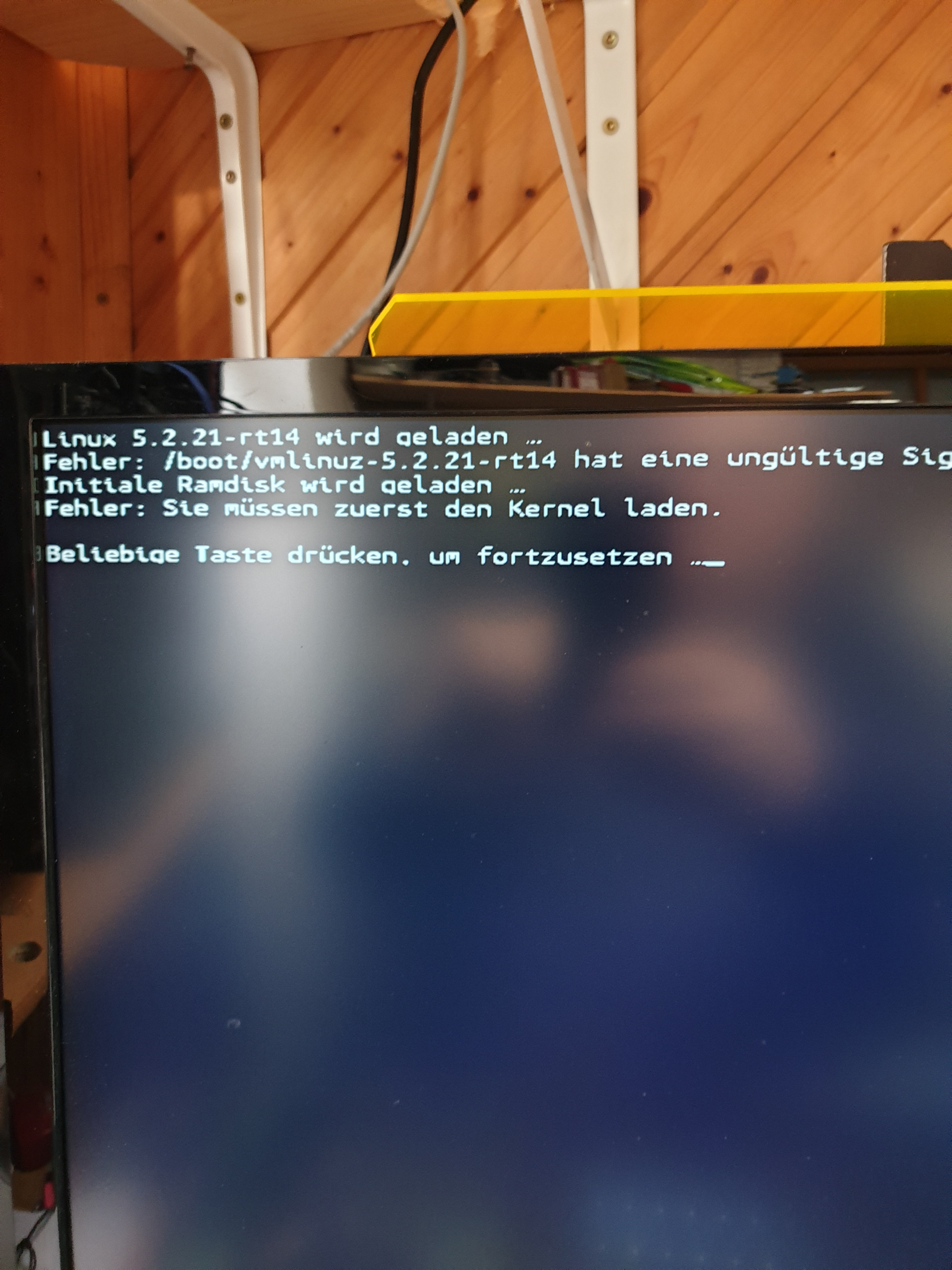

Hello
I'm playing around with Mint 19.3 and want to install Linuxcnc. It fails because of a signed RT kernel.
Compile running but not signed for UEFI-bios.
Any ideas?
Howto for signed RT-Kernel? ;)

07 Dec 2019 11:36 #152232 by tommylight

07 Dec 2019 13:07 #152242 by Weiler810T
hello Tommy
doesn't work, unsigned kernel :silly:
hmmm...
07 Dec 2019 14:51 #152254 by PCW
Can you disable secure boot in your BIOS?

07 Dec 2019 14:56 #152256 by Weiler810T
No, you can sign the kernel yourself, no idea how it works with sbsign, you have to make me smart first ;)
chiron@chiron-SystemFZ16:~$ sbsign

chiron@chiron-SystemFZ16:~$ sudo update-secureboot-policy --enroll-key
[sudo] Passwort für chiron:
Das hat nicht funktioniert, bitte nochmal probieren.
No DKMS modules installed.
chiron@chiron-SystemFZ16:~$ kmodsign sha512 \
>     /var/lib/shim-signed/mok/MOK.priv \
>     /var/lib/shim-signed/mok/MOK.der \
>     module.ko
At main.c:248:
- SSL error:0200100D:system library:fopen:Permission denied: ../crypto/bio/bss_file.c:72
- SSL error:2006D002:BIO routines:BIO_new_file:system lib: ../crypto/bio/bss_file.c:81
kmodsign: /var/lib/shim-signed/mok/MOK.priv: Permission denied

	                    (default <efi-boot-image>.signed,
	                    or <efi-boot-image>.pk7 for detached
	                    signatures)
07 Dec 2019 15:01 - 07 Dec 2019 15:01 #152257 by PCW
Seems like a lot of trouble (and something would have to be redone every time you updated a kernel module)
If It were my choice I would recycle any PC that doesn't allow you to disable secure boot
Last edit: 07 Dec 2019 15:01 by PCW.
  • Weiler810T
  • Weiler810T's Avatar Topic Author
  • Visitor
  • Visitor
07 Dec 2019 15:52 #152263 by Weiler810T
:lol: :lol: :lol:
  • tommylight
  • tommylight's Avatar
  • Away
  • Moderator
  • Moderator
07 Dec 2019 20:29 #152284 by tommylight
hello Tommy
hmmm...
That is still 5.2....something kernel, did you try the one linked on the link i linked to ?
And i agree with PCW, secure boot has nothing secure in it and UEFI is the biggest mistake in computer history. It was done solely for the purpose of enabling Microsoft and disabling everything else. Luckily it does not work as intended so we can continue to use Linux.
  • Weiler810T
  • Visitor
  • Visitor
07 Dec 2019 21:05 #152290 by Weiler810T
I see it the same way, but i need windos for cad and the image linked by you has the same proplem.
I can install all dependencies for linuxcnc, but the fucking unsigned kernel doesn't work.
  • tommylight
  • Away
  • Moderator
  • Moderator
07 Dec 2019 21:37 #152297 by tommylight
there is a link for an unsigned kernel there and it does work always, last i installed was 5 days ago.
Time to create page: 0.229 seconds
