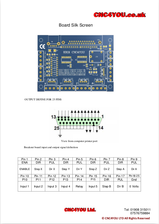

Hi
Apologies for posting this again but I would like/really need, to get this going
I am struggling to configure a rotary axis on a xyza gantry router with two steppers on the x axis. I have got x y and z to to move and home okay and there is power to the stepper on the a axis, but it will not jog. I have attached hal and ini files as will as the pin assignments for the breakout board. I would appreciate some simple instructions/directions because I just can't get my head around how these files work. Any help on this issue would be very gratefully received.

There don't seem to be any error messages, However when I open lcnc from the command line I get some strange text:
LINUXCNC - 2.8.0-pre1-4735-g2a127da
error in background error handler:
too many nested evaluations (infinite loop?)

Machine configuration directory is '/home/aaron/linuxcnc/configs/foam_xxyza-KK01A'
Machine configuration file is 'foam_xxyza.ini'
Starting LinuxCNC...
Found file(REL): ./foam_xxyza.hal
Found file(REL): ./custom.hal
note: MAXV max: 75.000 units/sec 4500.000 units/min
note: LJOG max: 75.000 units/sec 4500.000 units/min
note: LJOG default: 7.500 units/sec 450.000 units/min
note: AJOG max: 1500.000 units/sec 90000.000 units/min
note: AJOG default: 60.000 units/sec 3600.000 units/min
Warning: Forward kinematics must handle duplicate coordinate letters:xx
Note:
Individual axis homing is not currently supported for
KINEMATICS_IDENTITY with duplicate axis letter <X>
note: jog_order='XYZA'
note: jog_invert=set([])[/i]
Does this have any bearing on the issue?
