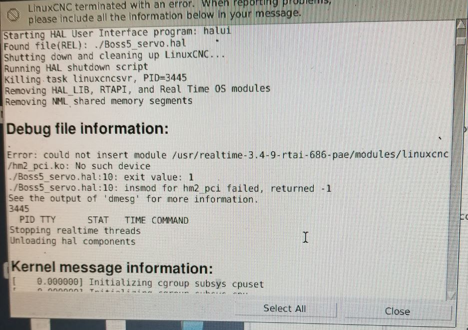

I could use some help trouble shooting this one. It did this several weeks ago. I reloaded my config files and that seemed to fix it. Then a couple weeks later it started again. I tried the same, reseated the 6i25, checked all cables and couldn't find any problems. A few days later I randomly turned the machine on and everything worked like normal. A few days later I needed to go run a part and it was back to giving me the error. I can't find a pattern to it and I'm kind of at a loss on how to troubleshoot.
Any ideas?
Any ideas?

I would first check that the 5V cable power jumpering is correct on both
ends (7I77 and 6I25) as problems here can cause weird power supply
related issues if this is OK there are a couple of other possibilities:
1. It could be a host power issue (low 3.3V will prevent a 6I25 from getting out of reset)
2. Corrupted /leaky flash memory
Both 1 and 2 will cause the red LEDs on the 6I25 to be stuck on at power up.
You might temporarily fix #2 by reflashing he 6I25
3. Bad/failed 6I25 card
4. Bad/failed host PCIE slot

What lights on the 6i25 should be lit under normal conditions? From memory, when I was having issues last time, I recall one or two LEDs coming on when I first powered up the machine, but nothing stayed on after it booted. I didn't think to look when it randomly started working again.
I've checked voltage randomly throughout the board and everything seemed normal. Anywhere specific I should probe?
Someone's recommendation on the facebook group was to run "sudo mesaflash --device 6i25 --reload" I tried that and got "- reload and got a message that "no 6i25 board could be found".

You should not have a red LED illuminated in normal operation

OK, so theoretically I'm good there.
Assuming my attempt to reflash was done correctly, it would seem to point to a dying 6i25 or PCI slot?

If you could check for red LEDS when LinuxCNC fails to
find the card, that would be more diagnostic. You could also
just try another slot if available.
If you have more trouble Mesa can issue a RMA and swap the card

I only get red leds for a second or two when I first hit to power button on the PC. Nothing after that.
I'm using a mini or micro (something or other) board, so only one PCI slot. I do have the old PC and hard drive that came with the mill so I guess I could put it back together and use that for a bit if keeps doing this.
Intermittent problems are the worst to diagnose!!

Did you clean the PCI slot contacts ?

I think I've narrowed it down to a power problem.
Tried to start the machine up tonight for a quick project and got the error again. Several restarts and tried re-seating PCI, nothing. Then on a whim, booted the system and then disconnected both the 5v and 24v from the 6i25, then reconnected power and started Axis and it started right up. Ran a 20 minute part without a problem. Next time I'll try only cycling one of the power supplies and see if I can narrow it down.
Not sure if the actually means I just have a bad power supply or if there's something deeper going on.
