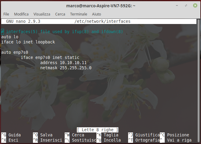

HI, i recently received my new Mesa 7i96 which will replace my chinese DB25 bob, but i'm struggling with the very first step.
I connected the board to 5v power and to the pc (directly) through ehternet.
I moved the second jumper up (this should set the board ip to 10.10.10.10) and i set my interfaces file like in the picture.
However i can't get it to ping, the board has one fixed yellow light (PWR), 1 fixed red one (DONE) and a flashing red INIT led.
Am i doing something wrong?
Thank you

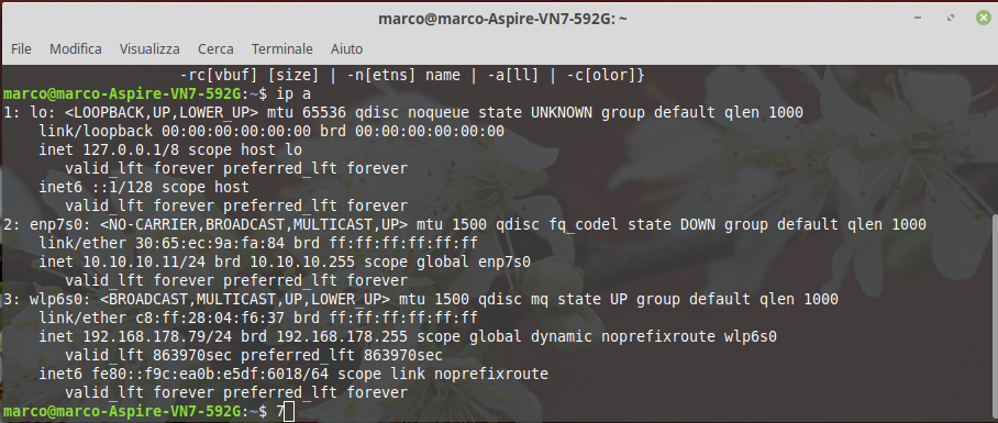

Type ip a in a terminal and paste the output here.

If you have a flashing init light and solid done light you very likely have a 5V power issue

The init light blinking and /done solid red most likely means the 5V is dropping out when it has a load (after the FPGA loads itself ) or the 5V supply has excessive ripple

IT REALLY WAS A POWER ISSUE.
i don't know what's the difference between the 5v - 2a USB charger and the 5v 2a external psu, but with the second it actually works and the board pings .-.
