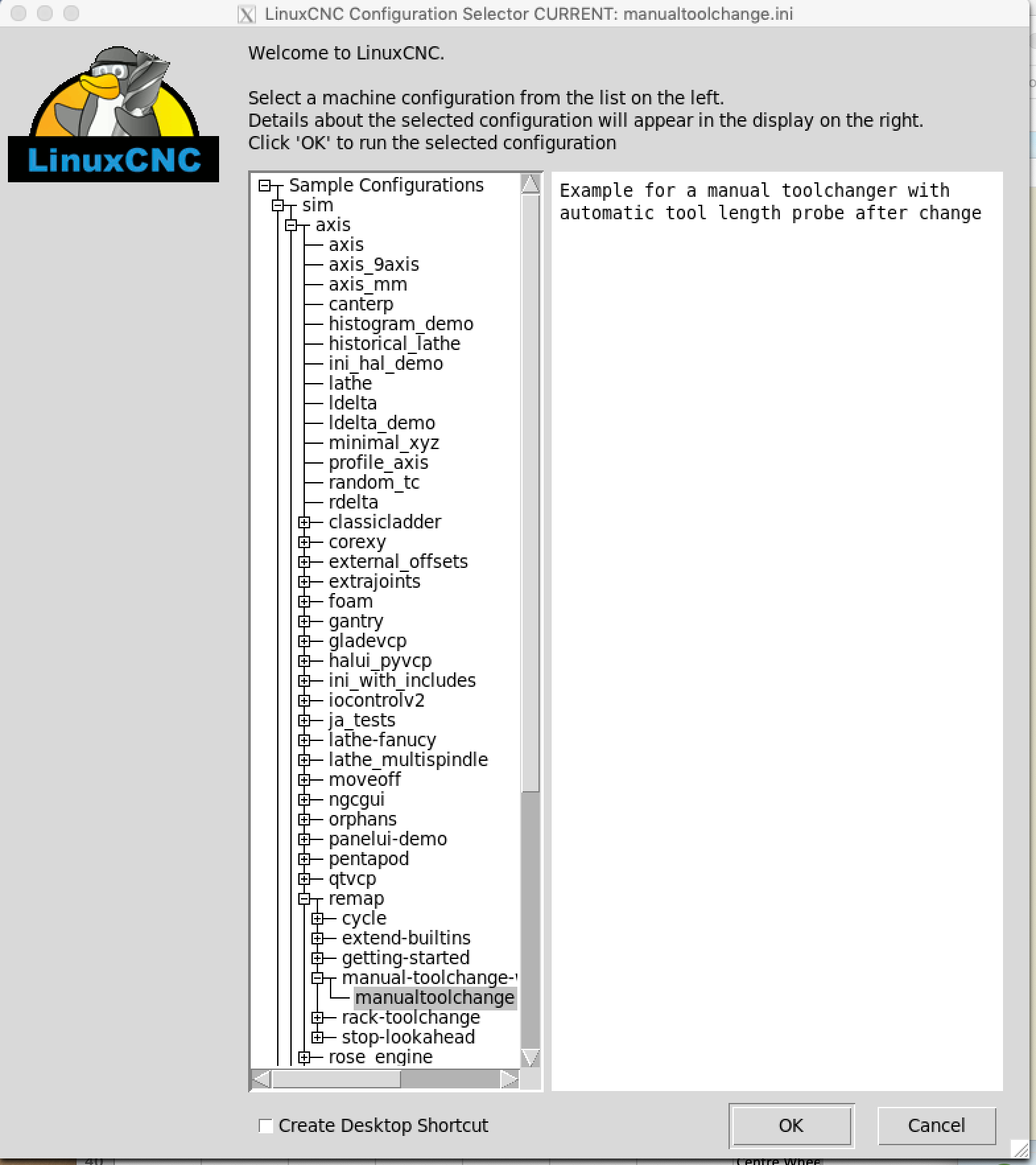

Is there a straight forward routine for changing a tool manually and either re-touching-off or using a probe to reset z-axis zero then continue running a file when using the Axis GUI?
At present every job that requires a change of tool needs to be split into separate files. This seems to defeat the purpose of having M6 included as part of the command set in LinuxCNC.

I think M6 is mostly defeated on any manual tool change machine. But I believe some people have had success using remapping of the M6 code to allow auto tool touch off with appropriate probing hardware. But I have not experimented with it myself.

M6 is only really useful on systems that have a repeatable-length way to change tools. On systems with an automatic toolchanger it is essential.
I do have a tool table and repeatable tools (but I am the tool-changer) and still often split the G-code up by tool (as it is often easier to do the same op on multiple parts than to do many ops on one part)
If you have a tool-length sensor it is possible to configure LinuxCNC to automatically measure the tool length for you. That requires a re-map of the M6 command to run a tool-probing cycle. There is a sample config in sim-axis-remap if you want to see how that works.

I will have a look at the sim-axis-remap code but from what you say it will probably be easier to teach students to separate their jobs.
Where do I find sim-axis-remap? I have found a file in Github
called hal_manualtoolchange.py that seems to be based on another similar but older file in LinuxCNC Wiki
gist.github.com/robanonymous/b677a47aed504548440c8258f71724b1
Is this something similar to sim-axis-remap?

It is one of the sample simulator configs.
You should be able to run iy and watch it work. (without affecting your current configs)
That is a standard part of LinuxCNC and will be needed too, so that the user can indicate that they have changed the tool.
