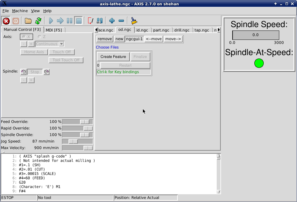

I tried several days on this matter.changes have made in ini file not correct,always ended with an error.I am fed up now for finding solutions.can anyone diagnose the problem why every-time pop up an error.
i downloaded .ngc files from BigjohnT's website.
after that tabs found but data on it.
Can anyone write a ini file for me.
NGCGUI documentation is not understand clearly to me.
I am using axis gui.
XZ axis for lathe mode
waiting for quick answers!

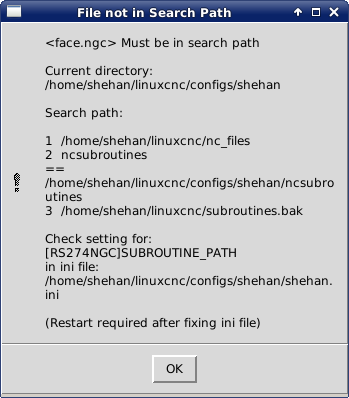

- bbsr_5a
- Posts: 544
- Thank you received: 106
18 Mar 2020 07:39 #160628
by bbsr_5a
Replied by bbsr_5a on topic Axis NGCGUI 101
put all the ngc as special face.ngc to the nc_files folder
only one accepted
means no other in the soubroutine path same name
only one accepted
- Dinuka_Shehan
- Posts: 333
- Thank you received: 26
18 Mar 2020 15:53 #160648
by Dinuka_Shehan
Replied by Dinuka_Shehan on topic Axis NGCGUI 101
i put all ngc files in a folder,named it as subroutines.
File not in search path error came all ngc files.
After ok them all and axis gui appear but tabs are blank.no boxes to input numbers.
