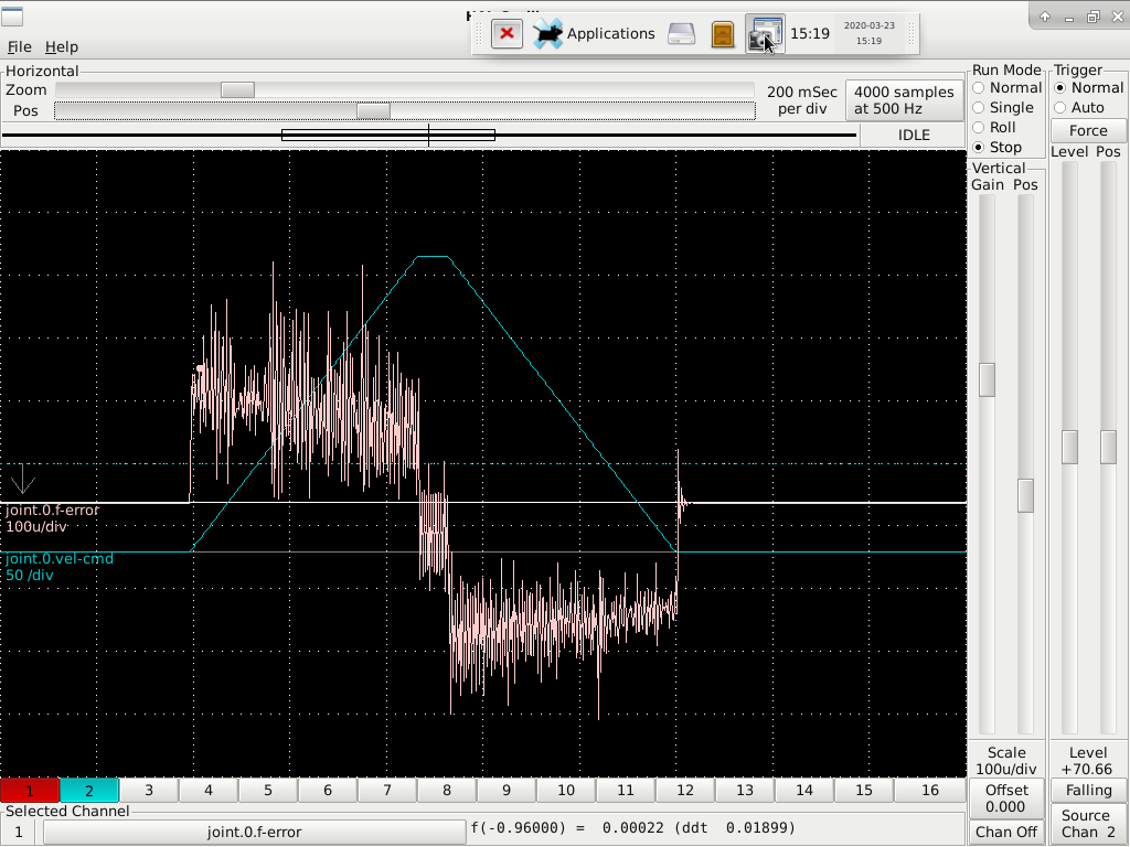

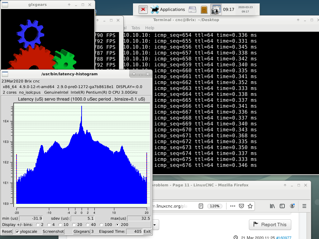

Here are the ping times the highest is 0.35 ... Is the histogram OK as I see others without all the crap on the sides
IRQ coalescing disabled?.... Not sure how to do that
This is the f-error plot as it started a probe
Replied by Clive S on topic F-Error problems
.OK that has a Intel MAC, do you have IRQ coalescing disabled? (as mentioned in the hm2_eth man page)
A good check on this is pinging the Ethernet FPGA card and checking the ping times

The ping times are _really_ bad
You can likely improve these by turning off the drivers IRQ coalescing
This is described in the hm2_eth manual page
man hm2_eth
The plot errors are not significant (+- 350 nM or +- 0.35 u)
man hm2_eth

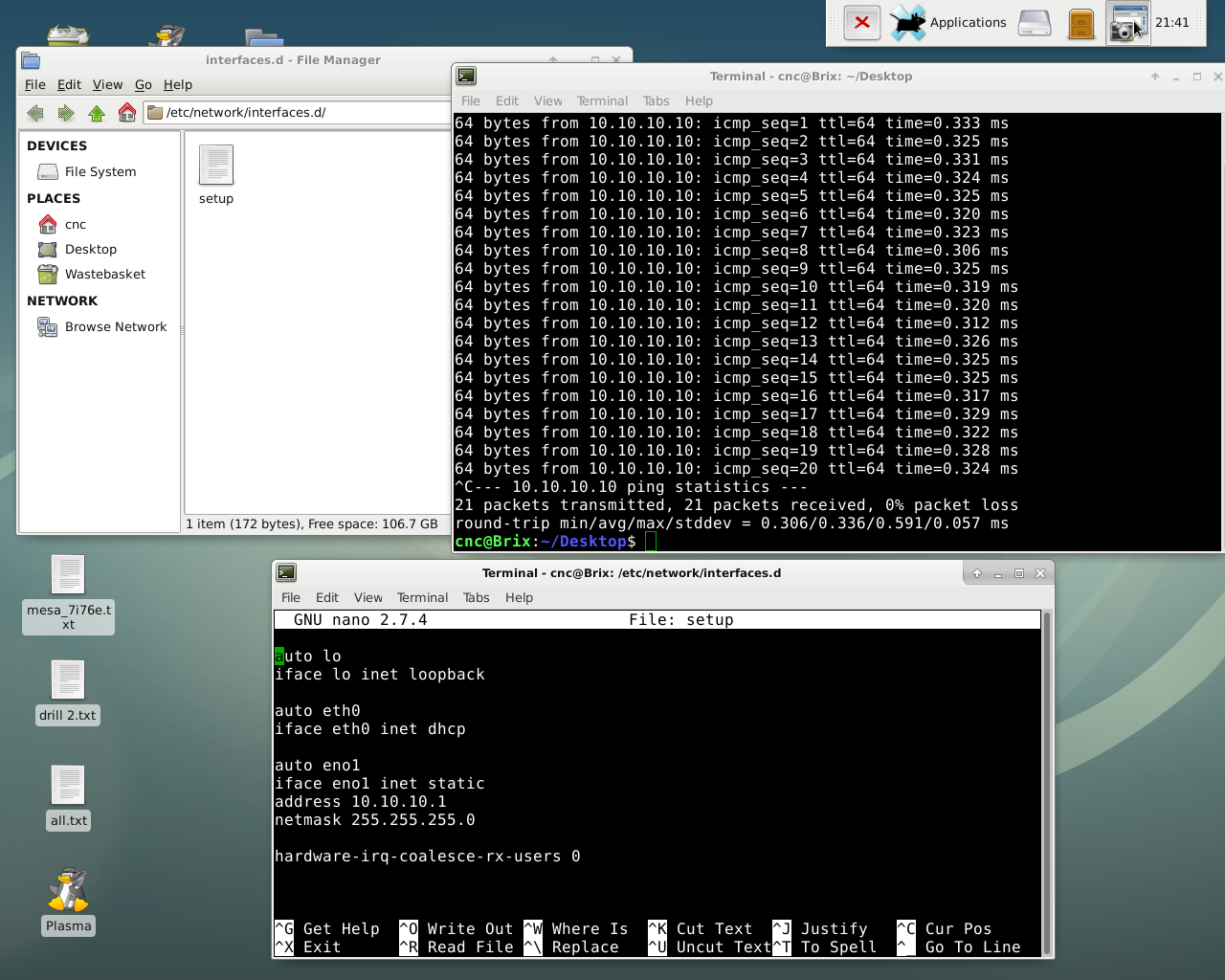

23 Mar 2020 21:46 #161285
by Clive S

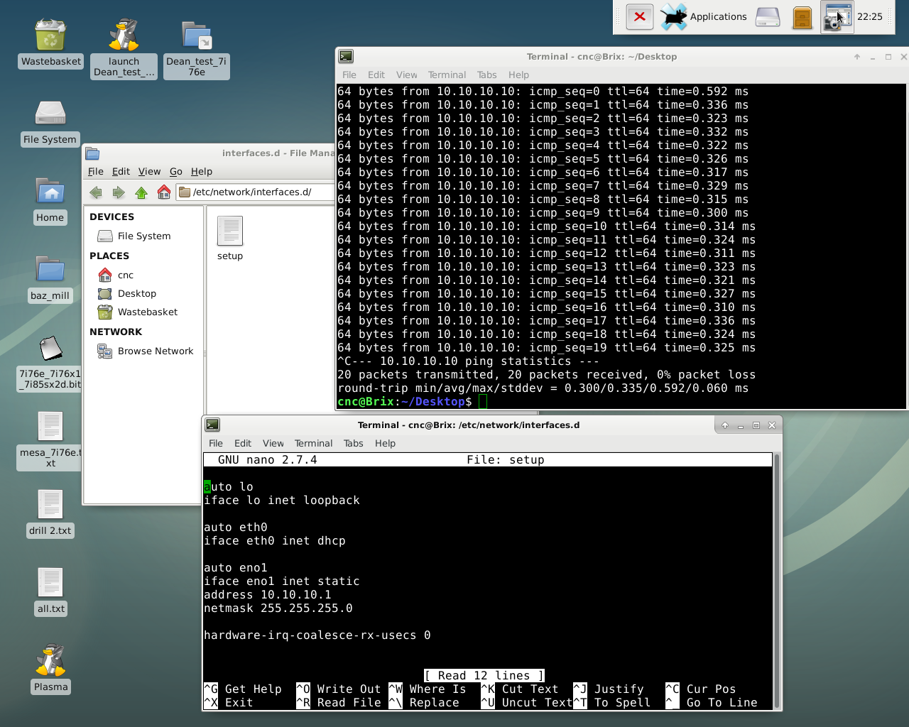

Peter. Have I done this correctly. As it has not effected the ping times.. Yes I rebooted
man hm2_eth

23 Mar 2020 21:56 - 23 Mar 2020 22:21 #161286
Replied by PCW on topic F-Error problems
You have (AFAICS) an error in the interfaces file
( users should be usecs )
You should be able to try this live (no reboot) with this command:
sudo ethtool -C eno1 rx-usecs 0
but this will be lost when you reboot
(hence he need for editing the interfaces file)
Note, If this command fails the embedded one in the
interfaces file cannot work either so its always good to
try the immediate command
Last edit: 23 Mar 2020 22:21 by PCW.

23 Mar 2020 22:33 - 23 Mar 2020 22:53 #161290
by Clive S
Dyslexia. New screen shot. no difference. But I did not try sudo ethtool -C eno1 rx-usecs 0 as I have just seen it.
Edit: I have tried ethtool had to install it first. then got this:-
cnc@Brix:/etc/network/interfaces.d$ sudo ethtool -C eno1 rx-usecs 0
Cannot get device coalesce settings: No such device
Am I editing the correct file?
Last edit: 23 Mar 2020 22:53 by Clive S.
- Posts: 17961
- Thank you received: 5265
23 Mar 2020 23:28 #161303
Its very important to try the live version because you have no
idea if the command in the interfaces file worked or not
