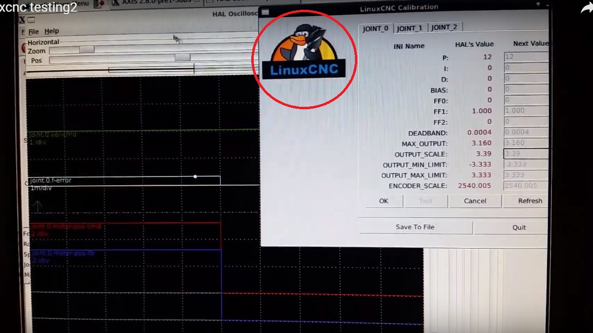

Is there a way to remove the Linuxcnc logo (sorry guys) on the calibration screen or resize/ re-position it to right to free up space? On a small machine monitor, it's hard to position both the halscope and calibration screen so things can be read easily.

There is no Linuxcnc logo on the calibration screen.
Could you post a screenshot of what exactly you need removed?

i can tell you how to modify the file -you'll have to find it if you are using an installed version of linuxcnc.
In a RIP it's in tcl/bin/emccalib.tcl
look for :
change to :
save and no more image
Chris
look for :
# Wizard logo
set lname $::env(LINUXCNC_HOME)/share/linuxcnc/linuxcnc-wizard.gif
if { [file exists $lname] } {
set logo [image create photo -file $lname]
} else {
set logo ""
}change to :
# Wizard logo
set logo ""
} else {
set logo ""
}save and no more image

Chris,
Thanks for the info. If I do that will it re-size the window? I'm guessing its designed that size to accommodate additional joints?

The window will be smaller without the image

Perfect! Thanks.
