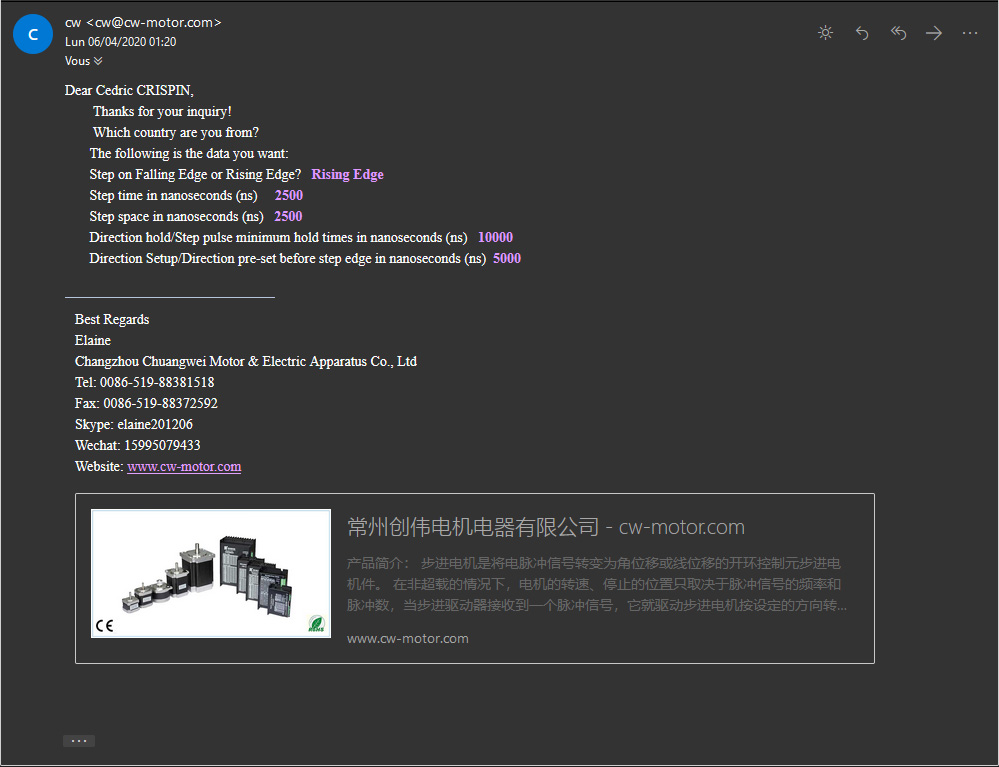

I would like to add the necessary information on the LinuxCNC Wiki - Stepper Drive Timing: wiki.linuxcnc.org/cgi-bin/wiki.pl?Stepper_Drive_Timing for my Digital stepper driver CWD556
I received all the following information from the manufacturer:
Manufacturer: CW-Motor - www.cw-motor.com/
Model: Digital stepper motor driver CWD556
Step time in nanoseconds (ns): 2500
Step space in nanoseconds (ns): 2500
Direction hold/Step pulse minimum hold times in nanoseconds (ns): 10000
Direction Setup/Direction pre-set before step edge in nanoseconds (ns): 5000
Step on: Rising Edge
Spec Sheet: drive.google.com/file/d/1my3Dhg8MgjtC0Sh...3-_/view?usp=sharing

as it is a leadshine cloe its the same as in the standard to use with
you always start highere and if the machine can do more you lower the timing
starting with that numbers will fail for some users and make in the hardest place no movement at alll
so keep the default and idividuell go down
