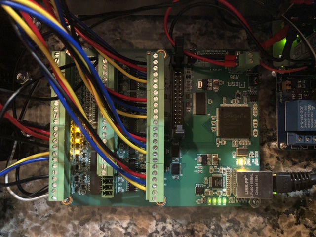

What lights are on the 7I96 when its running?

Here’s the pic of the board . In the process doing those test you guys recommend on the x axis

Did you verify that the 5V is OK at the 7I96?
