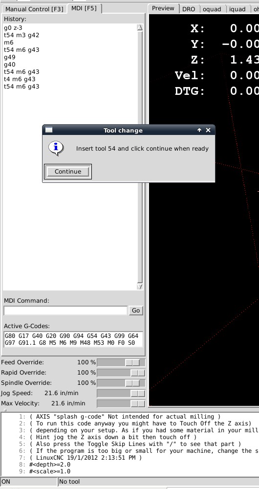

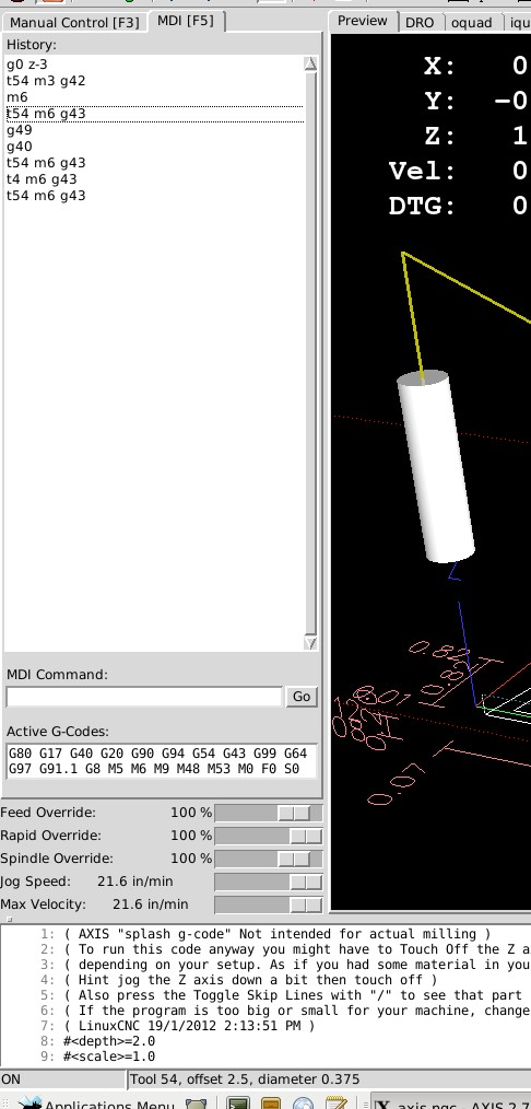

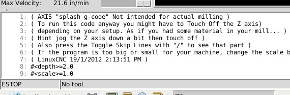

- verticalperformance
- Posts: 55
- Thank you received: 11
18 Apr 2020 01:46 - 18 Apr 2020 01:57 #164382
by verticalperformance
Replied by verticalperformance on topic TOOL TABLE SETUP OR POST PROCESSOR
If you type T4 M6 G43 in the MDI window, does it change the tool to Tool#4 and display the diameter and length offset as defined in the tool table in the status bar?
Attached some screen grabs. And do you have the "manual tool changer" set up in Linux CNC too? You get a brief splash screen on startup, and then a dialog requesting you to change tool when the M6 code is invoked.
See linuxcnc.org/docs/2.7/html/gcode/tool-compensation.html and linuxcnc.org/docs/2.7/html/gui/axis.html#_manual_tool_change

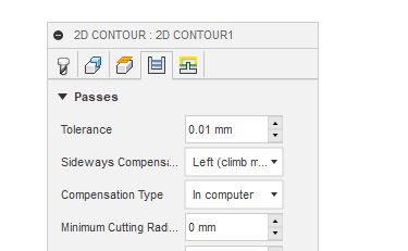

- keyboard
- Posts: 55
- Thank you received: 4
30 Mar 2021 15:20 - 30 Mar 2021 15:25 #204132
by keyboard
Replied by keyboard on topic TOOL TABLE SETUP OR POST PROCESSOR
Hi ,
There are a couple of issues.
In your post from Fusion there is no cutter comp. Hence no G41/G42 Dx. Its "In computer" by default. That is , its offsetting it by the dia of the cutter and generating a post. There is a drop down to select how you want to do it, in the passes tab.
My problem is , then Linuxcnc doesn't like the post from Fusion, something about the format. I will have to write down the exact error.
Last edit: 30 Mar 2021 15:25 by keyboard.
