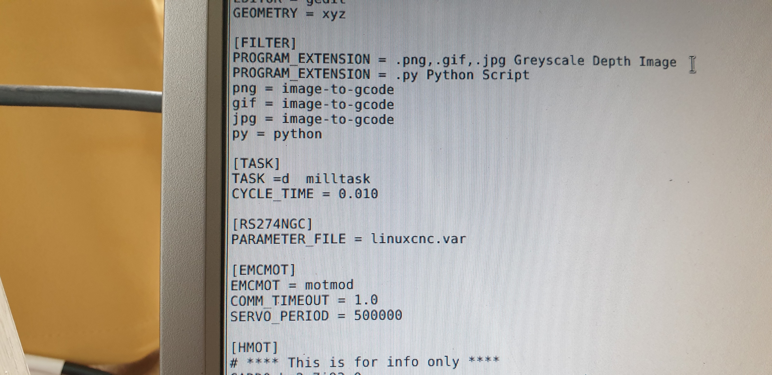

Hello to everybody.
This is my third day trying to sort out the damn ipv6 problem, which I never had before.
sysctl: cannot stat /proc/sys/net/ipv6/conf/eth0:avahi/disable_ipv6: No such file or directory
It's appeared after a yesterdays LinuxCNC 2.9 update (using synaptic package manager). I've tried to disable ipv6 in /etc/sysctl with the following lines
net.ipv6.conf.all.disable_ipv6 = 1
net.ipv6.conf.default.disable_ipv6 = 1
net.ipv6.conf.lo.disable_ipv6 = 1
I've reinstalled everything, but it's still the same.
I've configured the wired connection as described here forum.linuxcnc.org/27-driver-boards/3559...ethernet-mesa-boards
I'm attaching the results of ip a command, and LinuCNC report log. Will be very thankful for any guidance where to look.
Sorry for my English. Hope to get a reply.
Thank you.

17 Apr 2020 20:28 #164323 by PCW
Replied by PCW on topic ipv6 error when starting LinuxCNC.
Looks like you dont have your host static IP address set properly

17 Apr 2020 20:49 #164327 by PCW
Not sure how you configured it but the "ip a" list shows that you have not setup a
static IP address on the host
Here's what my "ip a" list looks like (for my Ethernet interface)
2: eno1: <BROADCAST,MULTICAST,UP,LOWER_UP> mtu 1500 qdisc fq_codel state UP group default qlen 1000
link/ether ec:b1:d7:6c:a2:da brd ff:ff:ff:ff:ff:ff
inet 10.10.10.100/8 brd 10.255.255.255 scope global eno1
valid_lft forever preferred_lft forever
Notice the "inet 10.10.10.100/8 brd 10.255.255.255 scope global eno1" line
That means the host Ethernet port (eno1 in my case) has been assigned a static
address of 10.10.10.100
Did you forget to set the static IP address in the net manager or not save your changes?
It may also be that you don't have the modified template in use
This is why I prefer to use the interfaces file rather than the network mangler (this is described in the hm2_eth manual page)

17 Apr 2020 22:25 #164348 by tommylight
Replied by tommylight on topic ipv6 error when starting LinuxCNC.
You have it set wrong in the network manager, you have it set at "LOCAL LINK", it should be set at " MANUAL"

I have no errors about ipv6 now, but it's still don't want to start. I'm completely lost.
Error report created by /usr/lib/tcltk/linuxcnc/show_errors.tcl:

Can't execute TASK program d  milltask

18 Apr 2020 16:32 #164474 by PCW
"Can't execute TASK program d milltask"
is weird
Possible corrupted hal/ini file? (edited with non ASCII editor?)
18 Apr 2020 16:49 - 18 Apr 2020 17:30 #164476 by piotr1991
Replied by piotr1991 on topic ipv6 error when starting LinuxCNC.
I'm always using mousepad. Nothing else. When I've compared two ini files I found strange thing. In [TASK] section there was =d (on the picture). But when I removed letter "d" it's opened. I have no idea was this my accidental mistake or there was something else.
Last edit: 18 Apr 2020 17:30 by piotr1991.
