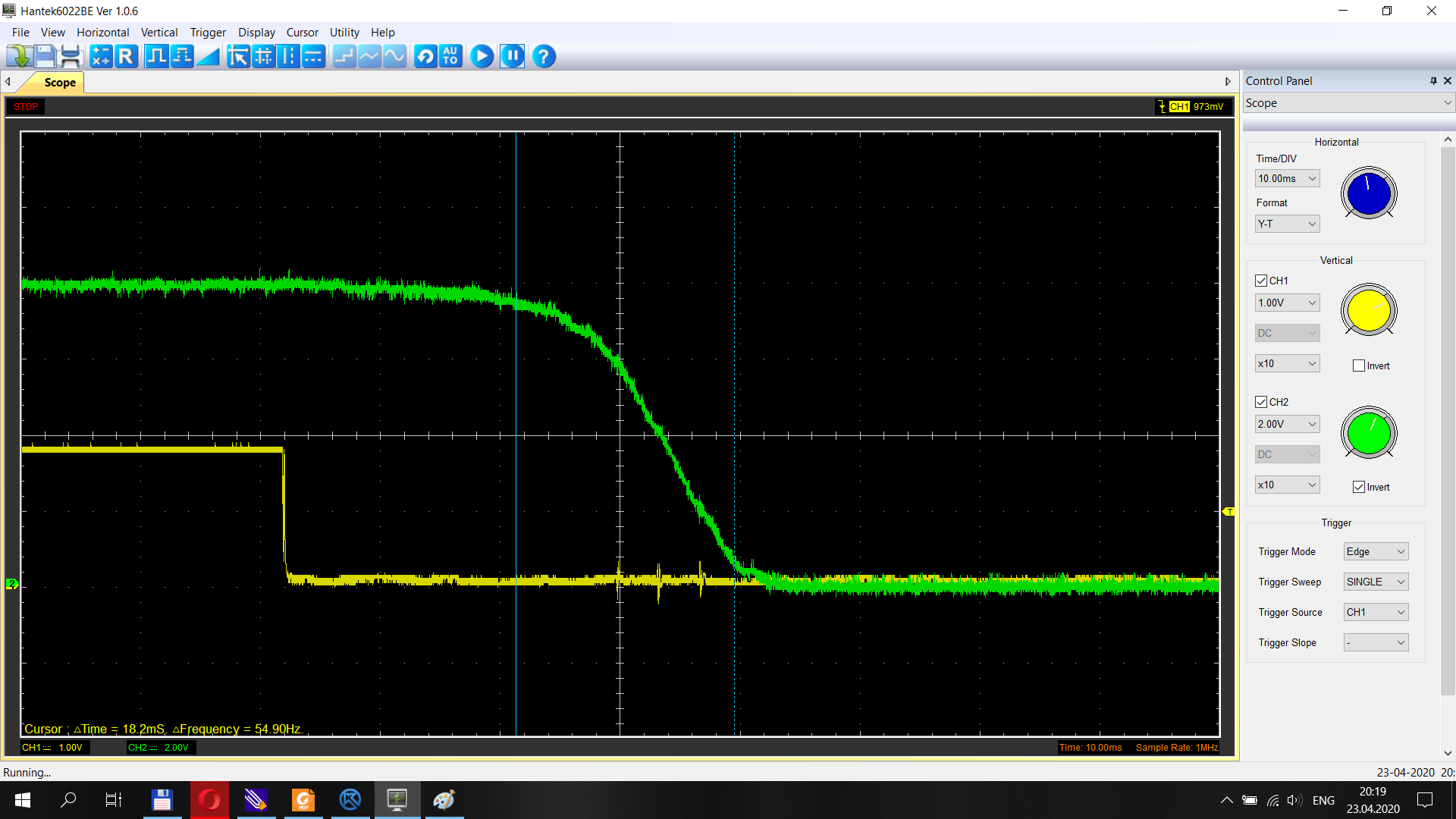

I have analog servos 1500 rev/min
Ball screw 10mm/rev.
Input signal +-7V.
Linear encoder fixed to the table 0.001
Servodrive has lag/delay from reference 18ms.
Outpur has 10V=2^15 discritization.
When I try to run jog to 1mm, I get random movement from 0.3 - 2.5mm (That deppends on feed speed).
Unfortunatly I not use linuxcnc but another control system that was present there.
If somebody has such problem when refited old machine on analog servodrives, could have similar problem.
Anyone has any assumptions why this precision problem have place? How thy possibly could be solved?
Input signal +-7V.

There is way to much delay from the moment the command is issued till the motor actually moves. Same when stopping. 17ms is unusable for cnc control.
Did you tune the drives first? It sure looks they are not tuned at all.
You might find some more info here as he was having the same problems:

As for realTime:
All modern CNC machines that based on windows are use RealTime Core. It costs money of course.
As for Why I don't change to linuxcnc:
I have good experiance with linuxcnc and I like it very much. But to chouse that controller not I decided. Currently I must use it because I build project for it and made all changes. I don't want to rebuild it.
As for my question.
I think I solved that problem with incresing feed back from tachogenerator. It worked prety fine.
