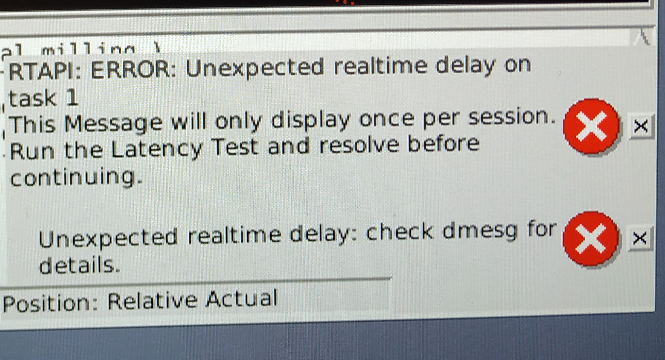

Error on start unexpected realtime delay task 0 or task1 was created by gzcwnk
I have tried a lot of settings 2000 up to 15000 and no joy

Replied by tommylight on topic Error on start unexpected realtime delay task 0 or task1
Set it to 50000 and test again.
Did you disable everything regarding power savings in BIOS ?

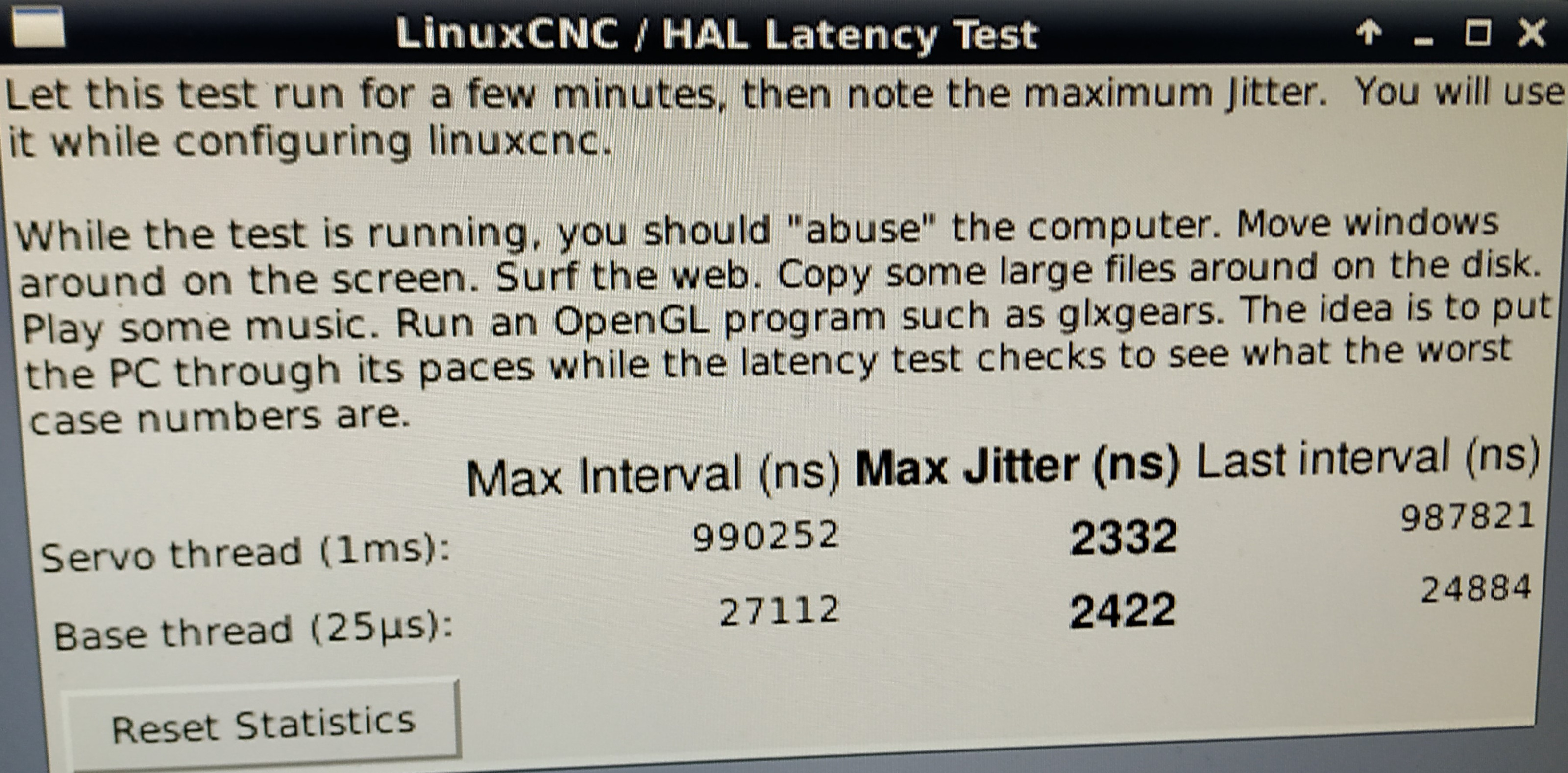

Yes, original test was 4600 and that didnt work. So reading posts here itsaid Nvidia cards can do it so I pulled the Quadro and put in a AMD 4850/4860. Next I went through and turned off all power saving and speed step stuff I could find, that dropped the test to 2600 (which is interesting in itself). I will have a go at 50000, but that's un-usable? and for a 3.4ghz i7 with 16gb of ram seems, terrible?

same error at 50000 on start up.

Latency test is 300 ish. I will pull the hd, put another in and try the newer LinuxCNC on stretch but I had a very similar error off the usb key.

Check if hyperthreading is disabled, that is a must.
Then see if there is anything about disabling C states.
IRQ 16 is ok, it all depends on what it is shared with and if there is anything you can do about changing that?
Also having an SSD helps a lot for preventing latency excursions, but if you got that same error from a live session, see if you can change the above before moving to SSD.

Yes Hyper is disabled, C states is not ticked so I assume that's OK its something I changed. I will remove the second NIC and see how that goes.

Now IRQ 18, same issue
