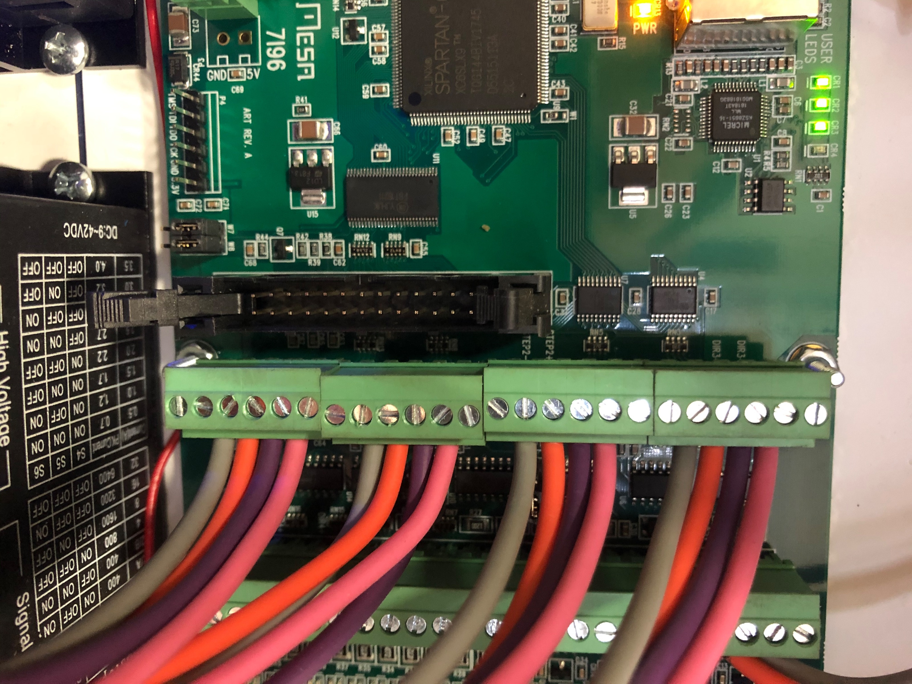

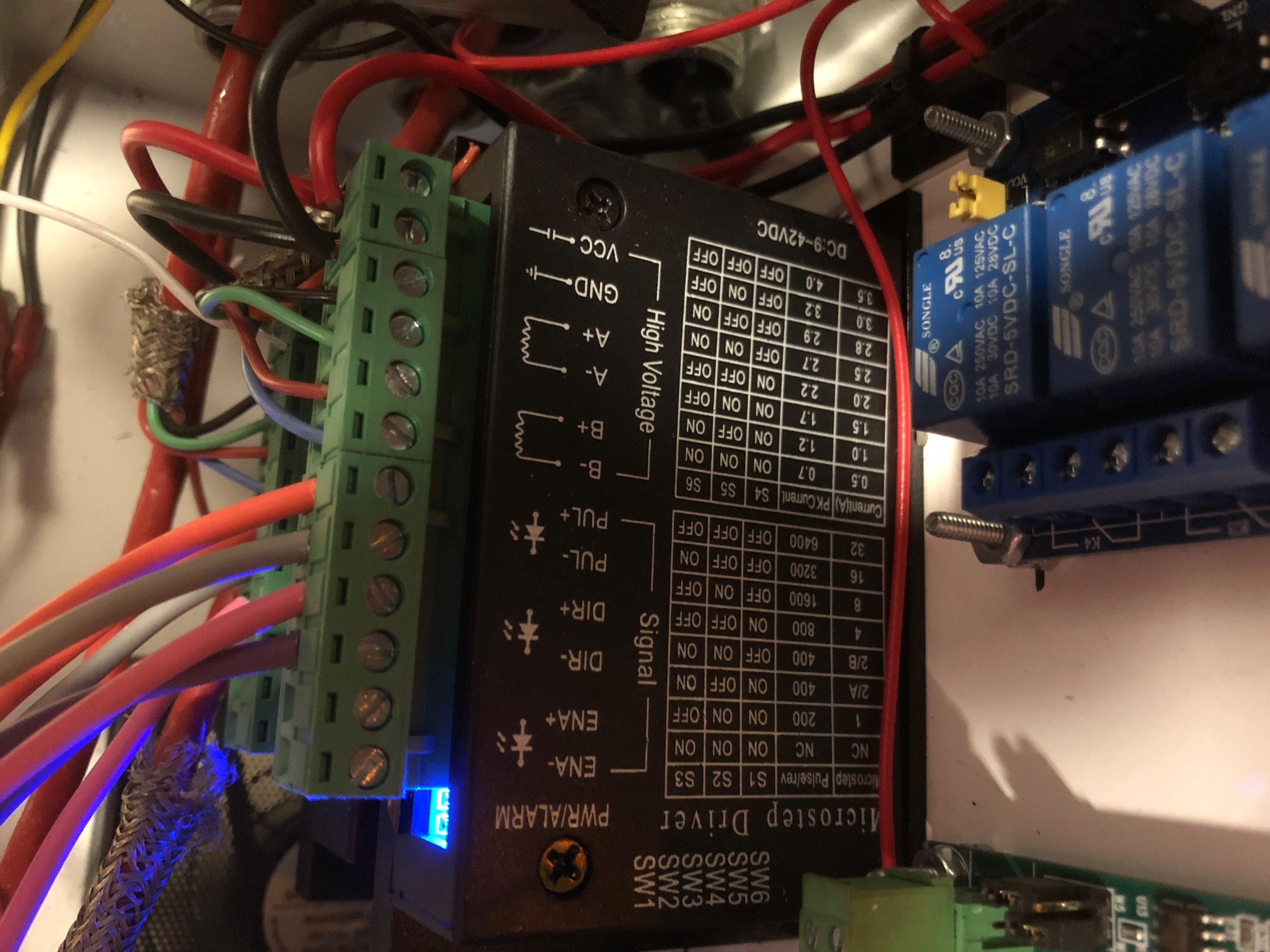

Good afternoon i am new to the cnc world and with all this covid time i have decided to dig into a diy cnc plasma i have installed linuxcnc mint 19 the easy way provided my tommylight. i have a mesa 7i96 board with china version of the tb6600 motor driver. here is a copy of my ini and hal file. I can get the computer to turn on the spindle output that that i am wanting to use to run the plasma but i have no movement from the stepper
motors any help is greatly appreciated.

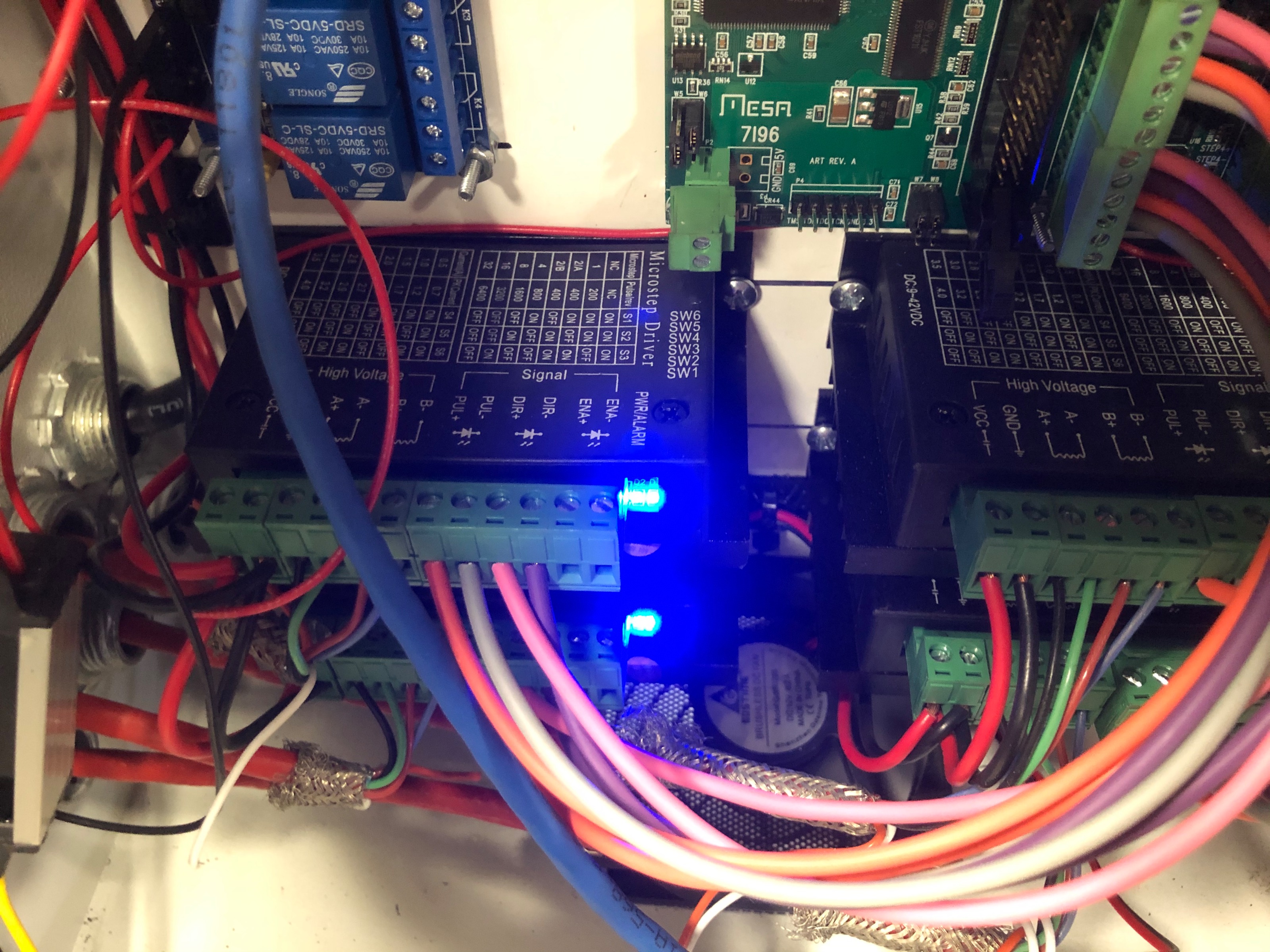

Pictures of the complete wiring, please.

Since these have a TB6600 and added optoisolation you might try 10000
for steplen. If this does not work you might try single ended drive:
7I96 +5 to step drive +pul and +dir
7I96 -dir to step drive -dir
7I96 -step to step drive -pul

Changing the wiring worked thank you another problem I now have is that I have 2.8 but I can’t seam to get it to run the second y axes I tried it as a y and I get a error I try it as a y tandem and motor don’t move any suggestion?
