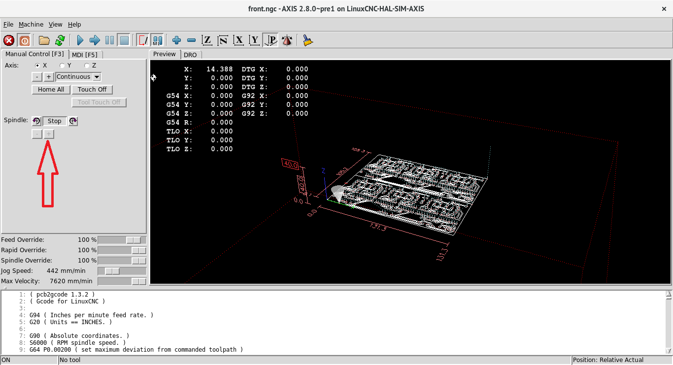

Change Spindle increment on main screen.

20 May 2020 19:38 - 20 May 2020 19:38 #168402
by Marcodi
Change Spindle increment on main screen. was created by Marcodi
Last edit: 20 May 2020 19:38 by Marcodi.

20 May 2020 20:05 #168406
by Marcodi
Replied by Marcodi on topic Change Spindle increment on main screen.
Hi Tommy,
Not what I mean.
I want to set the increment to 1000 instead of 100 by clicking that + symbol.
Where is that setting to change the increment to 1000 instead of 100.
Not what I mean.
- Posts: 7368
- Thank you received: 2181
20 May 2020 23:46 #168432
Replied by cmorley on topic Change Spindle increment on main screen.
linuxcnc.org/docs/2.7/html/config/ini-co...tml#_display_section
DEFAULT_SPINDLE_SPEED = 1000
IIRC Unfortunately the increment currently can't be changed.
- Posts: 19899
11 Aug 2020 12:51 #177893
Replied by andypugh on topic Change Spindle increment on main screen.
Just checked this:
github.com/LinuxCNC/linuxcnc/blob/2.8/sr...tion/command.c#L1864
defintely hard-coded.
It should be a per-spindle INI entry, I think.
Not a difficult change. I think that each spindle should have a min, max and increment. It probably shouldn't be something that the GUI finds in the [DISPLAY] section, like the DEFAULT_SPINDLE_SPEED is.
