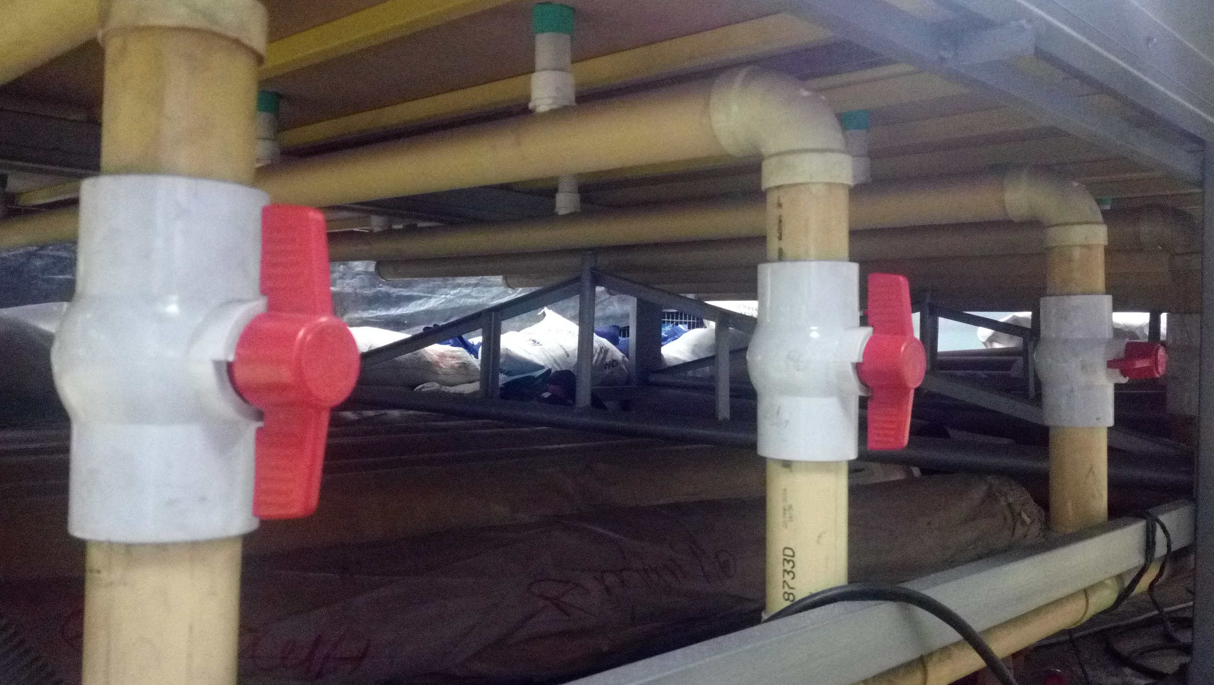

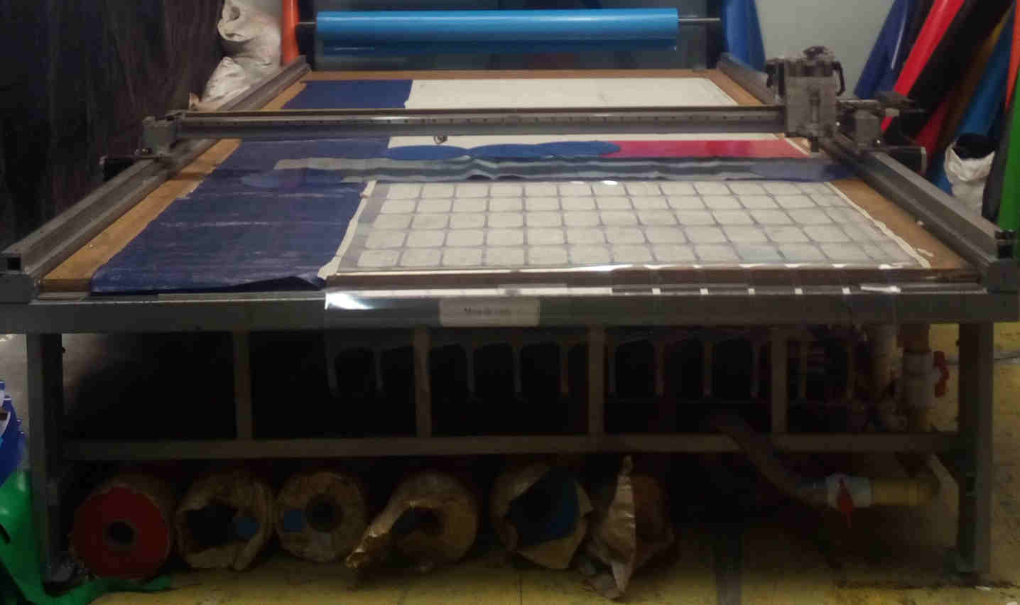

We have the following project: transform our currently CNC machine to efficient cut fabric materials and clothes; to fulfill this aim there're two necessities: simultaneously cut different layers of fabric materials and in the process maintain fixed those layers.
To cut different layers of materials: around 20 layers of jeans in example, a special electric saw is used and must move tangential to the mold surface controlled by a 4th axis, the mold surface is inscribed in XY plane. ¿LinuxCNC have that posibility developed?

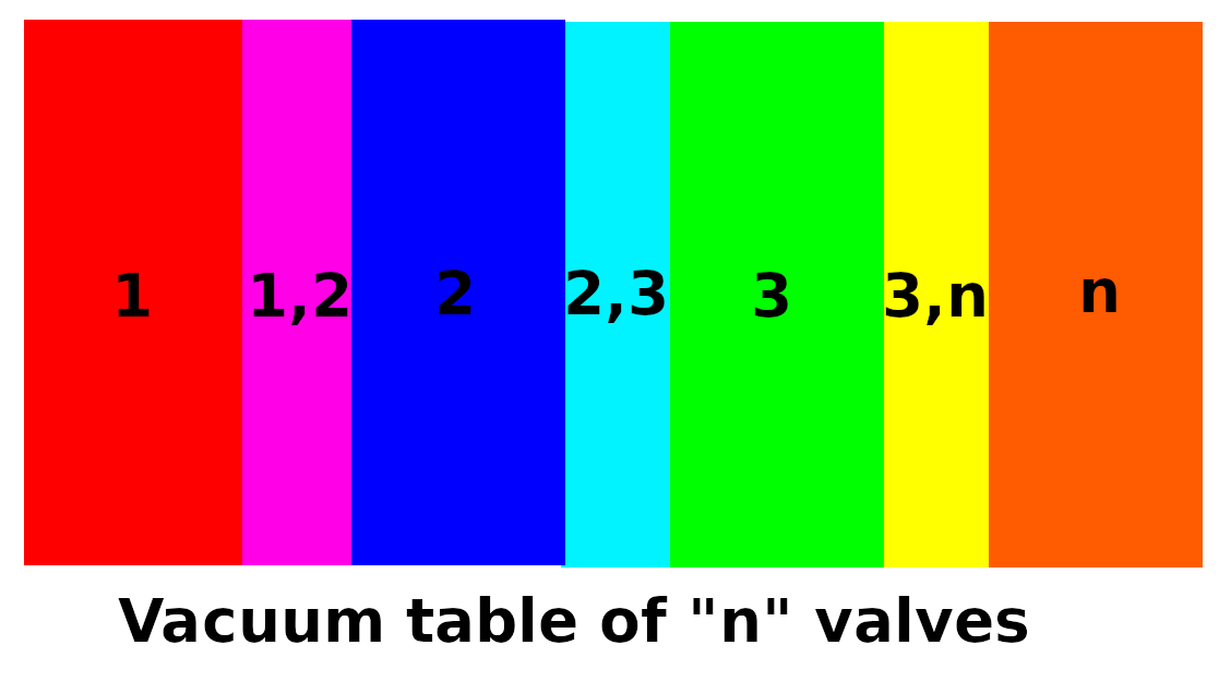

To maintain fixed those layers a vacuum table is used, the problem is that for this dimensions and quantity of layers a lot of power is required; implying a noise, expensive and energy consuming pump. Our proposal is to divide the table in areas that'll be activated by electrovalves; it could be archived by implementing an external control system with inductive sensors, but I wonder if we can save resources controlling the vacuum table electrovalves directly from LinuxCNC using GPIO ports added to the PC. The feature idea is to activate one valve number as a function of the Y axis cutting head position, in the transition zones have the two contiguous valve numbers activated as explain in the attached diagram with colors (vaccumTable.png).
I've experience programming and could help to develop those features; but need guidance because I don't know how LinuxCNC is build. ¿please could someone help and guide me to develop that?
Attached are images of the CNC machine, vacuum system and the table diagram.

That all seems reasonable, so have a look at tangential knife a Linuxcnc should support that but i never used it, and aslo search for rugbot here on the forum, it does the same thing you need using Linuxcnc.

Setting zones for your vacuum table is also fairly easy here is an air ram triggered by axis position

There is no need to use M codes to activate the vacuum sections. On a single axis, it is easy to achive automatically using the lincurve component. For two axes to trigger various squares of the table might take a bit of thinking but it can be done in a custom component very easilly.
