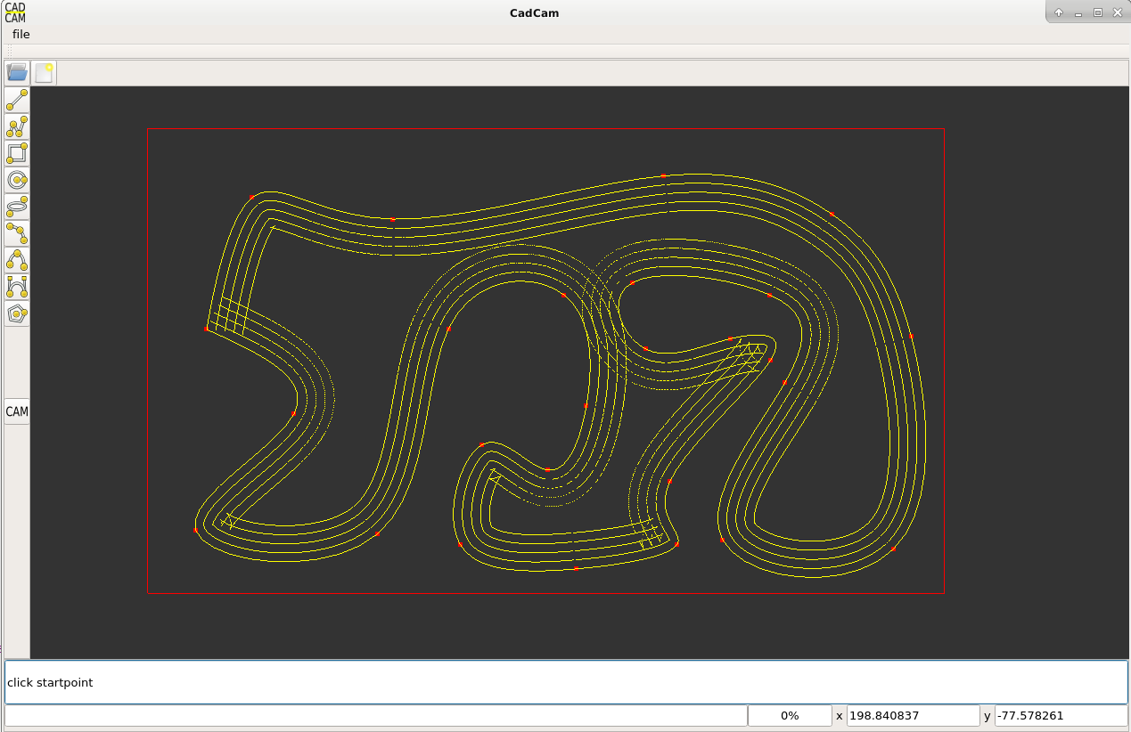

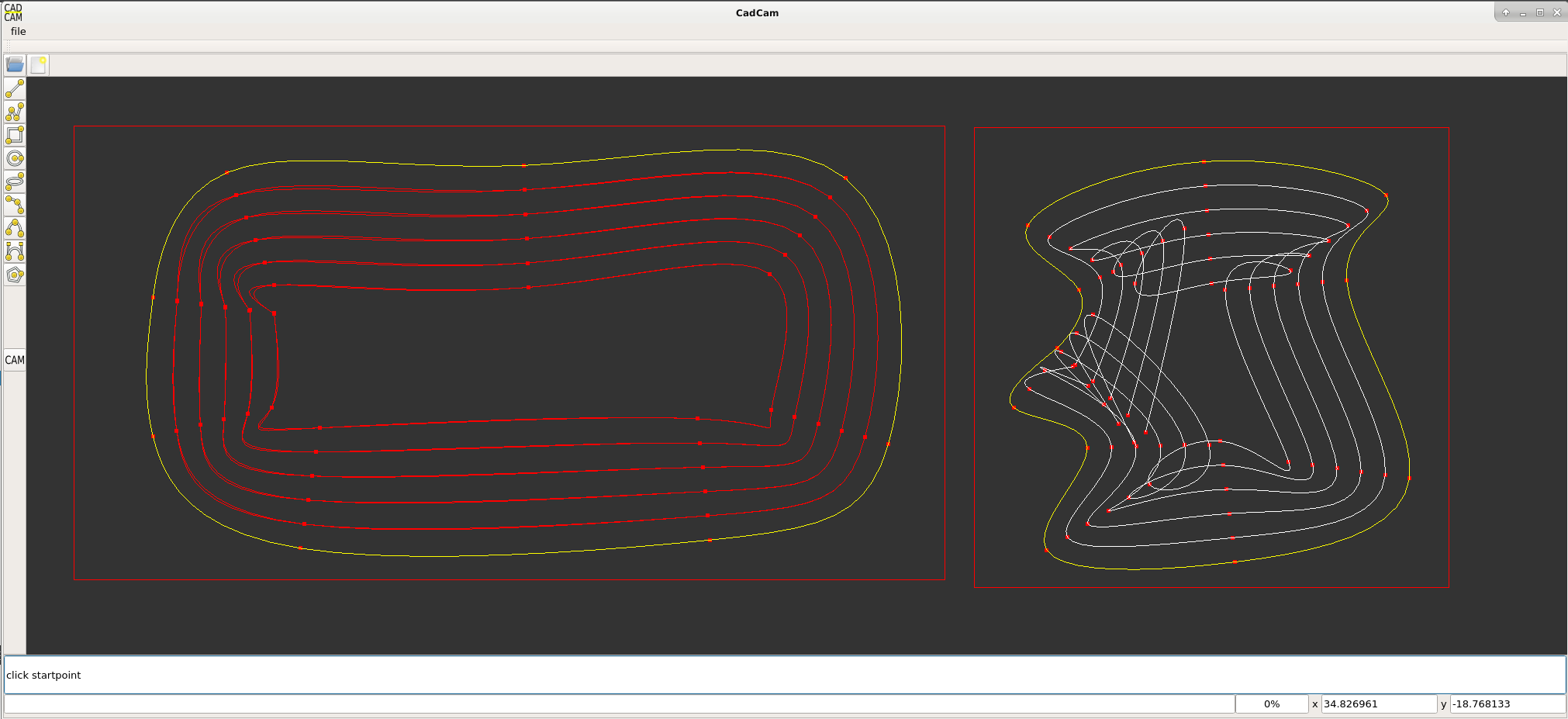

12 Jun 2020 13:47 - 12 Jun 2020 17:25 #171252
by Grotius
Replied by Grotius on topic Request G6, Ellipse and G7, bezier curve
I was curious if G41 & G42 Cutter Compensation could be used with the new spline interpolation.
If we use a code like this :
G41.1 D10 (Dynamic Cutter Compensation on, left of programmed path)
G0 X0 Y0 (start of the spline)
F1500
G5.4 (start block)
X10 Y10 (first control point)
X100 Y100 (second control point)
X250 Y25 (etc)
X350 Y-20
X600 Y0
G5.5 (end block)
G40 (tool compensation off)
The red dots are controlpoints. Their offset is calculated at a precision of 0.001mm for each offsetted controlpoint.
At the left you see double path's in red. This is visible when zooming in the picture.
This is a preview if a spline is played from left to right and visa versa.
So important is, when changing the contour direction for a spline from cw to ccw, interpolate the spline backwards.
About the tool radius compensation, the solution for this problem is quite simple.
If the machine has a active tool compensation, we interpolate the spline as an offset linestrip.
For this linestrip i will make a interpolation model, that we can use to get it right.
The linestrip has to have a clean up function, when the lines are becoming less 0mm, they must be deleted and re-attached.
Okey so far so good !
Update:
This is a spline_offset_as_linestrip. This is good. What we miss is a line-line interection to reconnect the offset path's.
For pockets we do a contour self intersect check, but that has nothing to do with this.
