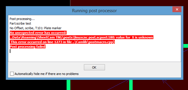

I'm trying to add a simple pen plotter to my cnc plasma machine and ive run into a couple of issues
I'm using the plasmac setup on the machine itself and rod's "spaceship plasma" post processor with sheetcam to generate the gcode
I saw in the post processor that there is a spot to set offsets for a scribe, i put mine in and those seem to line up correctly.
the problems i still have are:
1. the plasma torch will fire when it is using the pen plotter unless i have it disabled in linuxcnc
2. the z axis stays at drawing height through the whole drawing operation, even when moving across the part for a new line
3. once the lines are drawn and it switches to cutting, it will touch off and pierce at the offset for the plotter, then move over to the correct position to cut the part
any help is greatly appreciated!

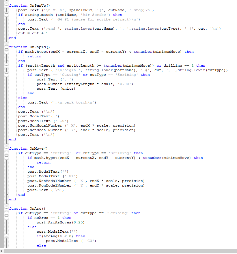

Replied by Cranktown on topic adding a simple pen plotter to linuxcnc plasma cutter
Seen a couple setups with a scribe on its own linear actuator mounted to the z axis which seems to be what the post processor is set up for
My set up is just a sharpie i can mount onto the z axis during a tool change.
So I'm just trying to have it run just as it would with the plasma cutter, just with different offsets and without firing the torch.

That may be an old version, there is an M3 S1 that will start a normal cut then a M3 $0 S1 that also starts a normal cut, I don't see any M3 $1 S2 which is needed for 'scribing'
There is another PP with some code snippets and some info here forum.linuxcnc.org/plasmac/38438-plasmac-post-processors#158270
