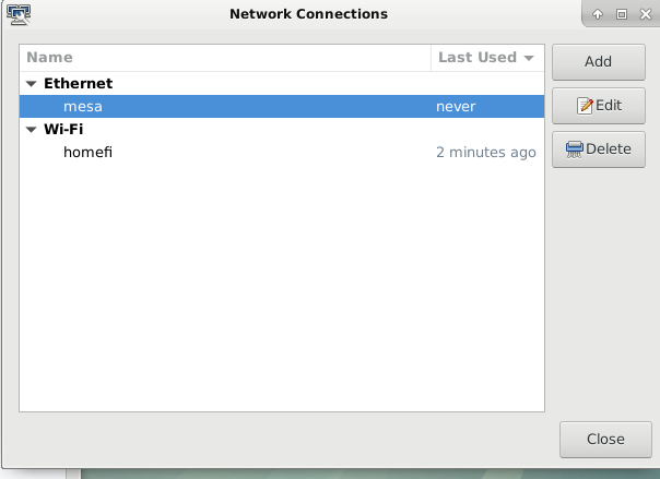

I am using wifi for internet. I am trying to use Ethernet strictly for the mesa card. I have followed those steps to the connection as well.

01 Jun 2020 15:00 #169673
Replied by PCW on topic What am I doing wrong?
The "Method:" needs to be manual and the ipv6 settings should be disabled

- Posts: 18114
- Thank you received: 5332
01 Jun 2020 15:16 #169676
What does
ip a
report?
ip a
report?

01 Jun 2020 15:24 #169679
Replied by tommylight on topic What am I doing wrong?
Set to manual, save, reconnect.
- Posts: 18114
01 Jun 2020 15:24 #169680
Right so for some reason your editing setting a static IP address was not applied

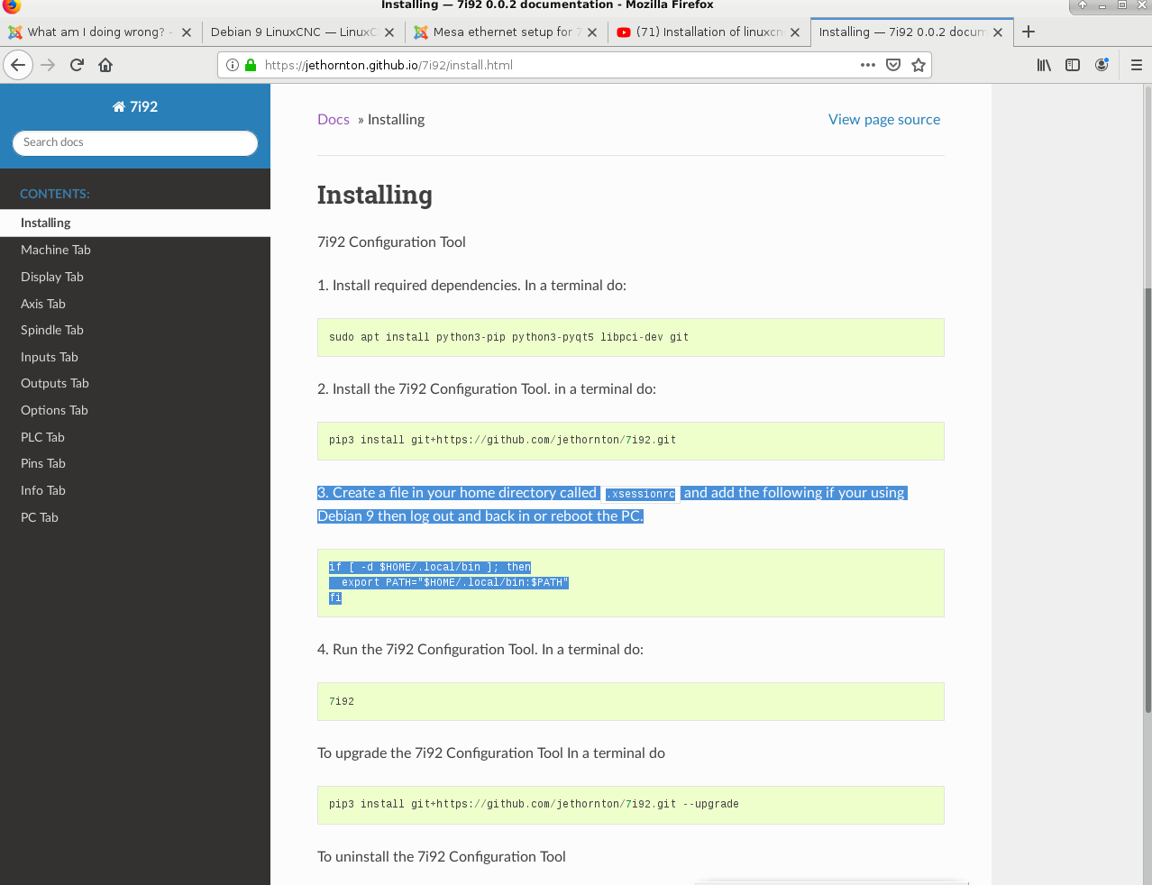

- JayDeeTOL
- Posts: 23
01 Jun 2020 16:27 #169686
by JayDeeTOL
Replied by JayDeeTOL on topic What am I doing wrong?
- Posts: 18114
01 Jun 2020 16:56 #169688
It looks like JTs configuration tool is installed in your home directory
rather than in a system directory. Your shell needs to know the path
to the configuration tool, since its not in the normal search path for
executables.
executables.
