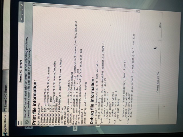

Error when opening linuxcnc
- Aldenflorio
- Posts: 389
- Thank you received: 15
08 Jun 2020 20:04 #170735
by Aldenflorio
Error when opening linuxcnc was created by Aldenflorio
- bbsr_5a
- Posts: 544
- Thank you received: 106
09 Jun 2020 01:21 #170756
by bbsr_5a
Replied by bbsr_5a on topic Error when opening linuxcnc
there is a typo in the hal file
please upload the INI and the HAL

How exactly do I get to there? I’m not familiar with this stuff
- bbsr_5a
- Posts: 544
09 Jun 2020 05:16 #170798
by bbsr_5a
there is a FOLDER called with your machine NAME
in Linuxcnc -> Configs -> machine name
the files are in there
on your filebrowser you can right click the intirer folder and say kompress to ZIP and upload it here #

Ok, thanks. I’ll do that when I get home from work

hi
there is somthing wrong with your installation
Where did you got the Files from
i added the working SIM_AXIS Configs for 2.9
Please try this config files

I used the build bot. Thank you very much, I’ll let you know if it works.

IT worked! This is an edited message because i at first replaced the file wrongly so i thought it didnt work. but i did it right this time and it worked. thank you very much!
