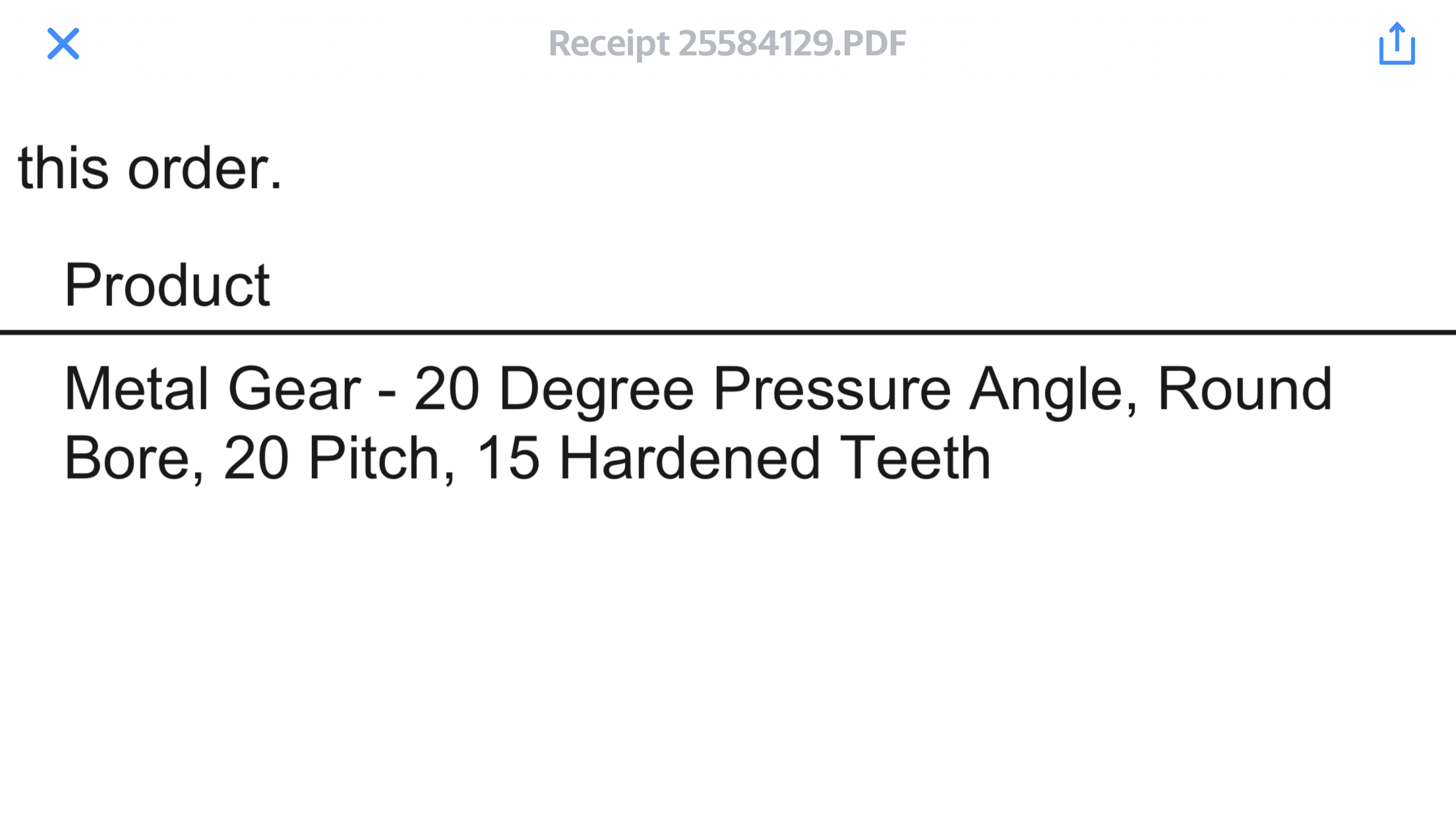

Sorry sometimes I forget cnc is a large category. I’m building a plasma cnc, it has one z axis motor, one x axis motor, and 2 y motors for they y axis. Direct drive
Last edit: 11 Jun 2020 10:16 by Aldenflorio.

12 Jun 2020 04:34 #171213

Hi Thanks we getting near
what is the Microsetting set to on the stepperdrivers
20Pitch per inch i guess
do you want to drive the machine in inch or in mm
SET them to 800steps/rev or 1/4 on the Drives
the Calculation then to be enterd is 200Motor steps Microstepping 4 no fear meaning 1:1 and then your desigerd speed
start with 10inch per sec and 100inch ACC
this might give you a start

12 Jun 2020 15:02 #171260
by Aldenflorio
Replied by Aldenflorio on topic I’m not sure how to correctly set up my motors in the pncconf area
Here’s the manual: www.leadshine.com/UploadFile/Down/DM556m.pdf
I was looking there for the information you asked about but I couldn’t find it. I’ll be using inches
