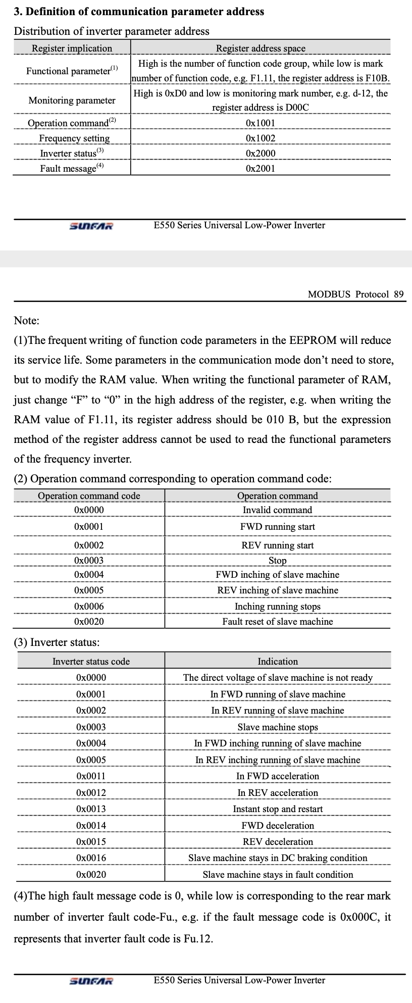

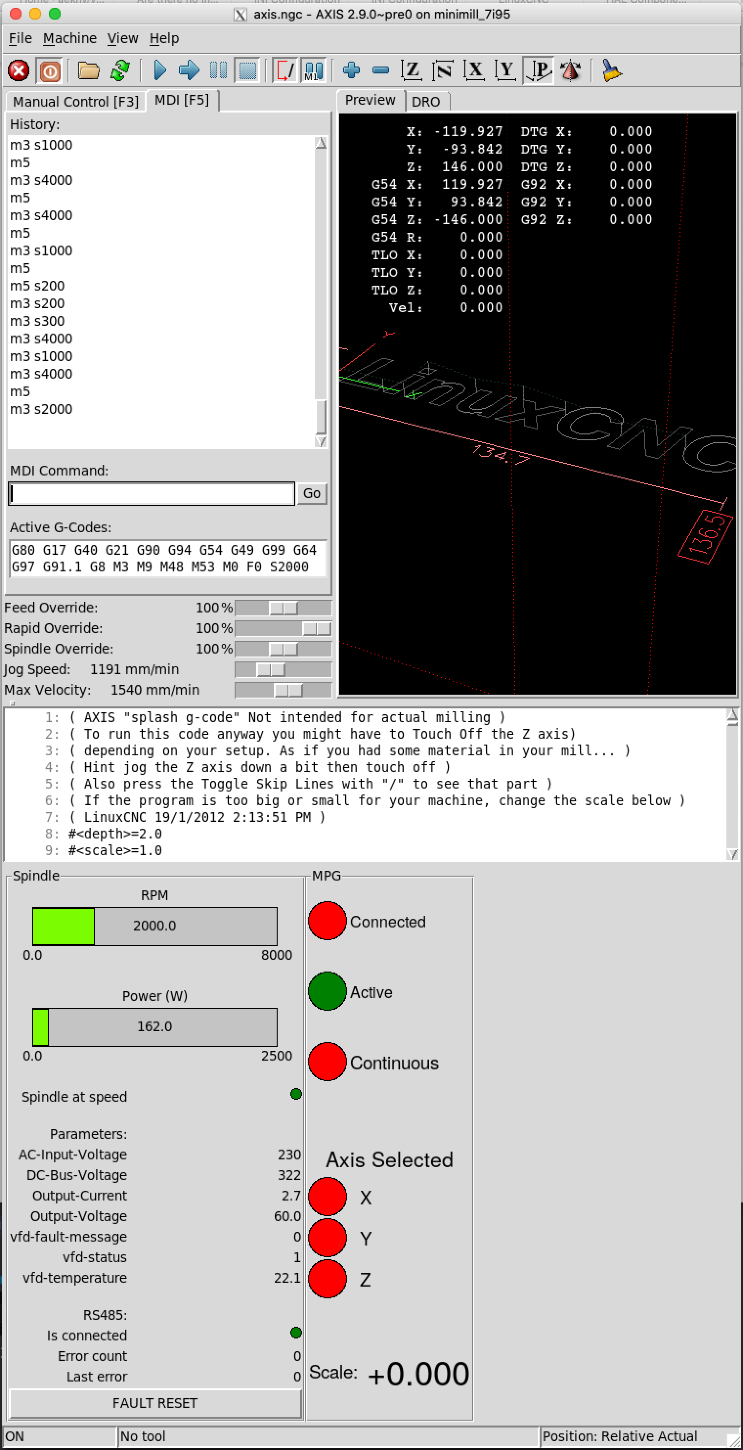

I've just got my VFD working via modbus with the vfdmod module.
I'm able to query for status and error codes but it returns a numeric value.
Is there a way to map a list of numeric values to text strings for the purpose of displaying on a pyvcp panel?
I've spent the last hour reading the docs and googling and I can't seem to find a solution.
i've attached screenshots as it stands now - you can see 'vfd status' is a numeric 1 which translates to "FWD running start" in the screenshot of the documentation.
I'd also like to add the fault code - there is another table elsewhere in the documentation for this, but its the same idea.
Cheers!
Shaun

Hi bsr_5a,
Thanks for the suggestion.. I thought about doing this as a last resort, but the problem I see is clutter on the UI would be significant. I'd end up with 20-30 LED indicators on the panel that are there 'just incase'.
I'm wondering if i can do something with pyvcp and hide/show elements based on a value. I might go ask in the pyvcp group.

There is a way to use 'Image u32' , which allows an unlimited number of gif's. The first image is 0 and counting up. Just need to make a few Gifs (i used irfan view for the example, 200/50px). the set 'theError' to the corresponding number, and maybe need to convert.
I had no time to make the example fancy
<labelframe text="Error TXT">
<font>("Helvetica",10)</font>
<hbox>
<label text="Error: "/>
<image name="err1" file="err1.gif"/>
<image name="err2" file="err2.gif"/>
<image name="info1" file="info1.gif"/>
<image name="message1" file="message1.gif"/>
<vbox>
<image_u32 halpin="selectimage" images="err1 err2 info1 message1"/>
</vbox>
</hbox>
</labelframe>net Err-type-in theError => conv-s32-u32.0.in
net Err-type-out conv-s32-u32.0.out => pyvcp.selectimage
Last edit: 12 Jun 2020 07:50 by MaHa.
