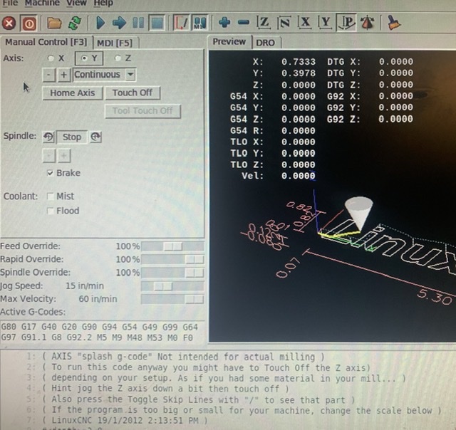

15 Jun 2020 22:21 #171777
by TexasCNC
Replied by TexasCNC on topic New Project with Mesa 7I96 and THCAD-05
- Posts: 21893
- Thank you received: 7463
15 Jun 2020 22:37 #171780
Replied by tommylight on topic New Project with Mesa 7I96 and THCAD-05
Where is it ?
On a side note, did you really have to set everything possible in the wizard ? You are running a plasma cutter, so flood, mist, bi-directional spindle, brake, are pretty much useless .
