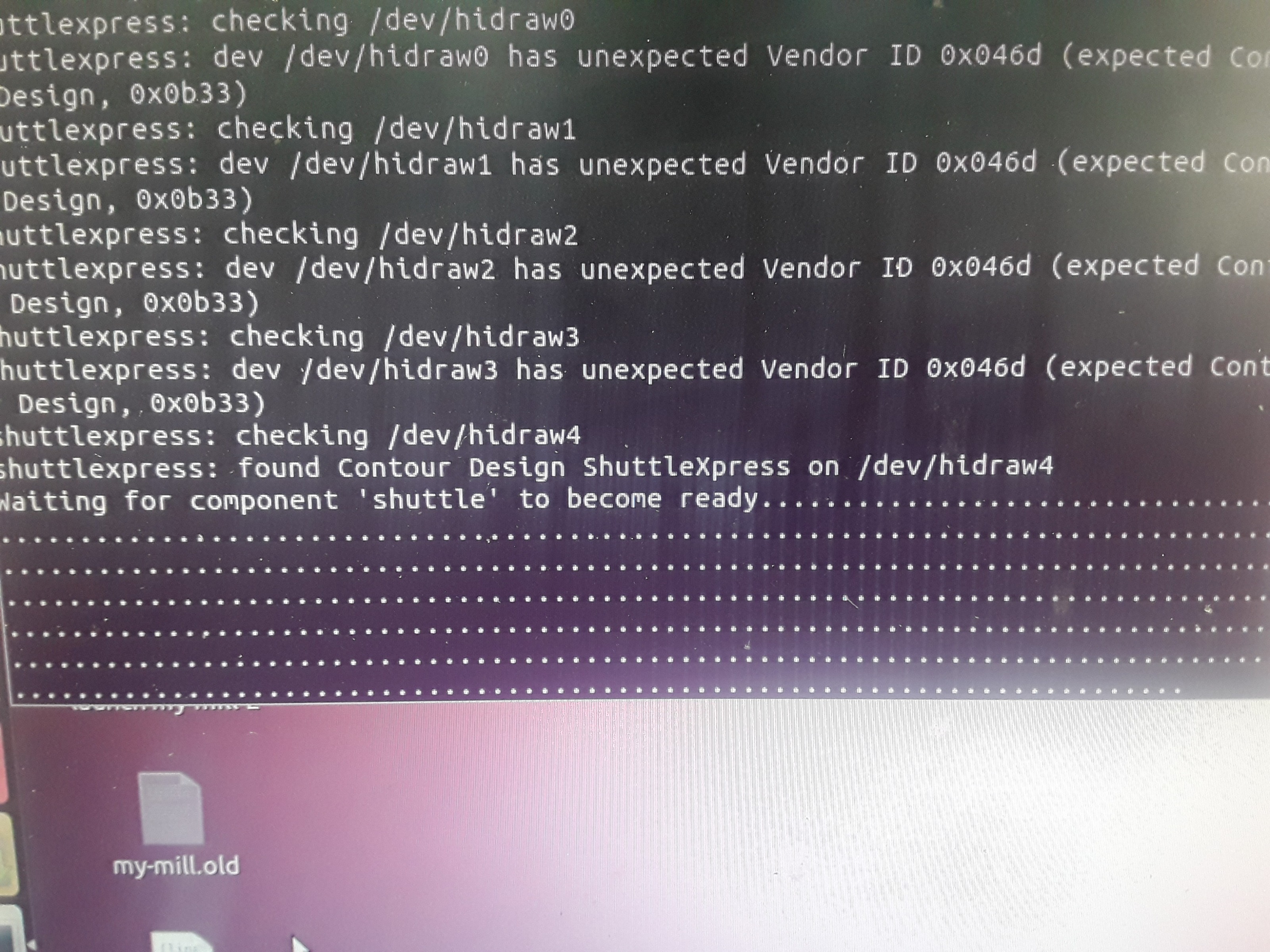

I have two machines and successfully connected a shuttle to one but the second is giving me fits. My memory may not be accurate as the first was a while ago. As I remember I added the shuttle.hal file to the machine folder, added the line HALFILE = shuttle.hal in the machine .ini file under [HAL] and a 99-shuttle.rules in /etc/udev/rules.d/99-shuttle.rules which reads;
SUBSYSTEM=="hidraw", ATTRS{idVendor}=="0b33", ATTRS{idProduct}=="0020", MODE="0444"
SUBSYSTEM=="hidraw", ATTRS{idVendor}=="05f3", ATTRS{idProduct}=="0240", MODE="0444"
All is good on the first machine, when I fry to run the second I get an error log, looks like a permission error.
This is in the debug section;
shuttlexpress: error opening /dev/hidraw0: Permission denied
shuttlexpress: make sure you have read permission on /dev/hidraw0, read the shuttlexpress(1) manpage for more info
shuttlexpress: error opening /dev/hidraw1: Permission denied
shuttlexpress: make sure you have read permission on /dev/hidraw1, read the shuttlexpress(1) manpage for more info
shuttlexpress: error opening /dev/hidraw2: Permission denied
shuttlexpress: make sure you have read permission on /dev/hidraw2, read the shuttlexpress(1) manpage for more info
shuttlexpress: error opening /dev/hidraw3: Permission denied
shuttlexpress: make sure you have read permission on /dev/hidraw3, read the shuttlexpress(1) manpage for more info
Waiting for component 'shuttle' to become ready...........................................................................................................
./shuttle.hal:14: shuttle exited without becoming ready
Stopping realtime threads
Help please. Thanks

Thanks for the reply but I have no idea what any of this means to me. Tried changing the 0444 to 0666 and still the same problem. Can someone give some more clear guidance? Thanks.

Create / Modify the file /etc/udev/rules.d/99-com.rules on your machine and insert KERNEL=="hidraw*", SUBSYSTEM=="hidraw", MODE="0666"
Restart your machine
- Create a file named "99-com.rules"
- Open with text editor (not word processor) and add these lines:Save the file in the /etc/udev/rules.d/ folder.
You will need supervisor right to be able to save it there.

Thanks. I am making some progress. Now there is something with the "shuttle" not being ready. I tried to start the program, the splash screen comes up then goes away. I waited several minutes and tried to launch again. I get the box that says Linuxcnc is already running, start anyway. Then I get two error report windows. i think this is where i need to look. The device ID on highdraw 1-3 is my wireless mouse.

shuttlexpress: checking /dev/hidraw0
shuttlexpress: checking /dev/hidraw1
shuttlexpress: checking /dev/hidraw2
shuttlexpress: checking /dev/hidraw3
shuttlexpress: checking /dev/hidraw4
shuttlexpress: found Contour Design ShuttleXpress on /dev/hidraw4
shuttlexpress: exiting
Debug file information:
shuttlexpress: dev /dev/hidraw0 has unexpected Vendor ID 0x046d (expected Contour Design, 0x0b33)
shuttlexpress: dev /dev/hidraw1 has unexpected Vendor ID 0x046d (expected Contour Design, 0x0b33)
shuttlexpress: dev /dev/hidraw2 has unexpected Vendor ID 0x046d (expected Contour Design, 0x0b33)
shuttlexpress: dev /dev/hidraw3 has unexpected Vendor ID 0x046d (expected Contour Design, 0x0b33)
Waiting for component 'shuttle' to become ready............................................................................................................................................................................................................................................................................................................................................................................................................
Unloading hal components

I still can't get this to work. Very frustrating. Anyone have ideas ?
