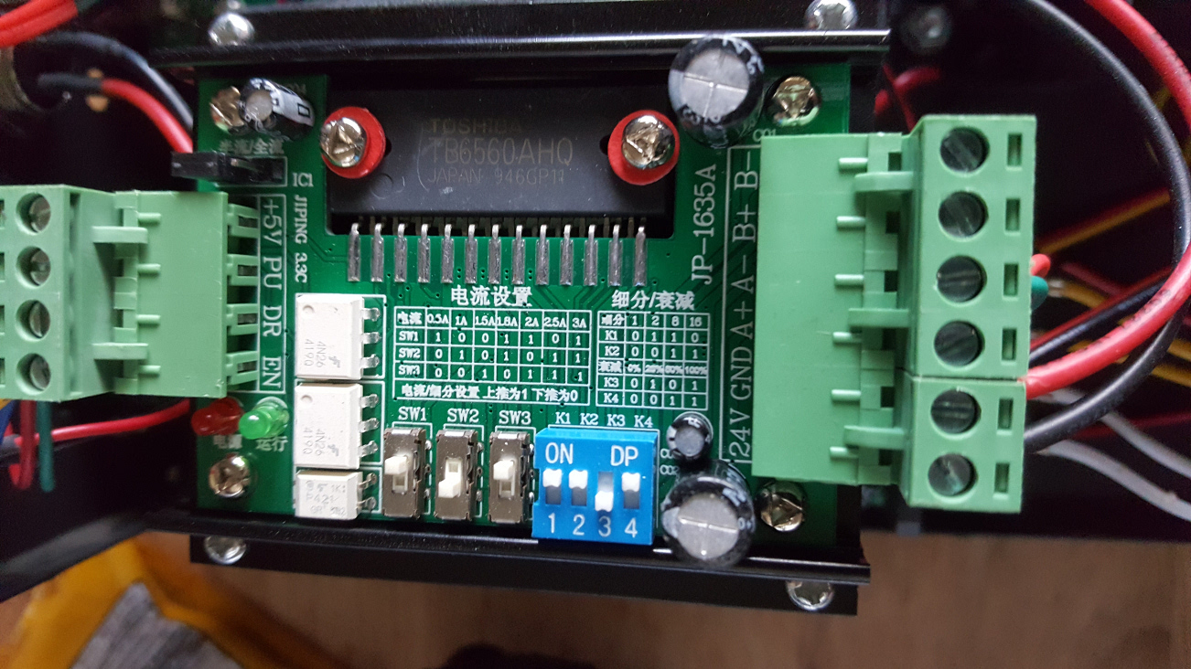

Newbie here.
Just purchased a 3040 cnc machine.
Trying to use LinuxCNC to run it.
Went through 'stepconf'.
When testing X, Y and Z axis, there is no movement for any of the axis.
When buying the machine, it was posted as being able to use USB to run the stepper motors.
I plug a usb cable into the PC and the controller. Nothing moves.
How do I go about solving this?

Through USB nothing will move, ever. LinuxCNC does not use USB for control.
But do some pictures of the controller board and the electronics, most of them can be easily made to work with LinuxCNC

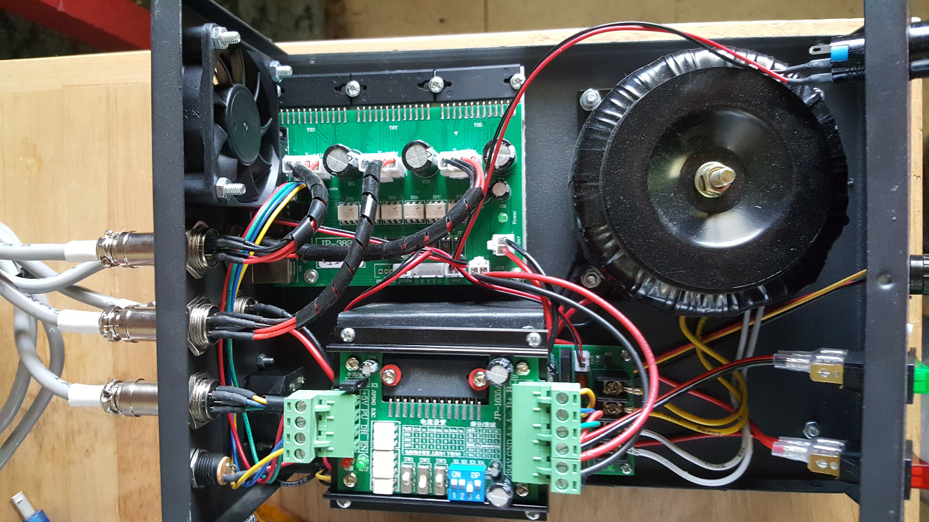

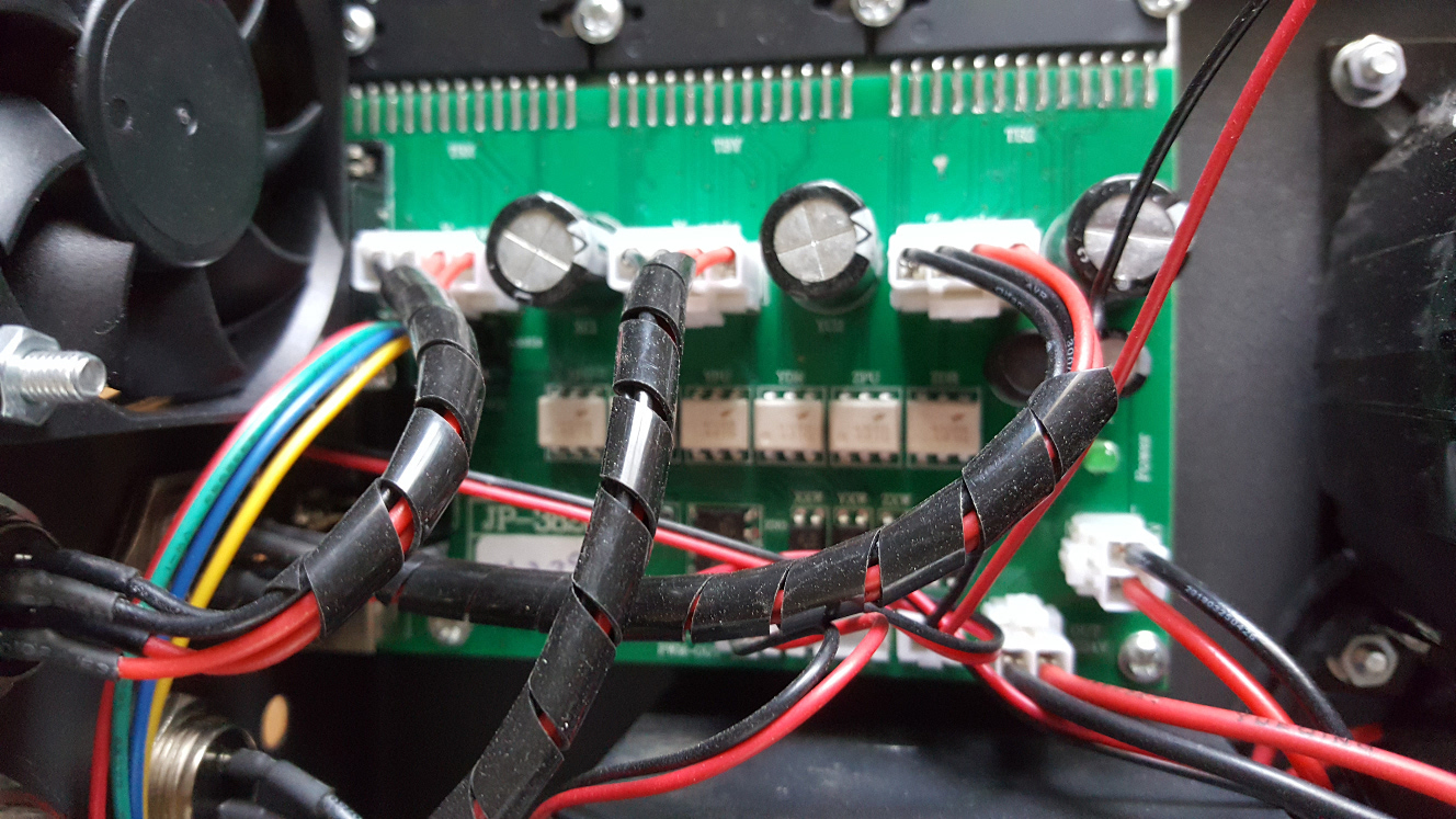

4 photos attached.

Those are simple step/dir drives so they can be used with a parallel port for 10 to 15$, but not with an USB to parallel adapter.
You can buy an add on PCI or PCI-E parallel port card, or even better get a Mesa 5i25 (PCI) or 6i25 (PCI-E) or 7i92 (ethernet)
