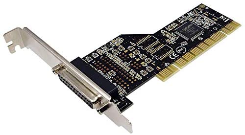

There are PCI cards that can provide a parallel port to a pc if yours does not have one:

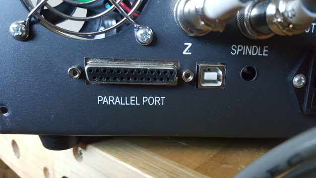

I think what you have is a JP382
www.aliexpress.com/item/32821517490.html
This is a parallel-port stepper driver.
What it seems is also provided (sometimes) is a USB to "CNC" cable, which is actually a DB25 connector with a CNC controller inside the DB25 connector.

- If you don't have a Parallel port, but do have a PCI slot, then you can add a PCI parallel port (they are quite cheap, but be careful which one you buy as some only work with a windows driver. We can advise on ones that wil work if you go that route.
- For more money you can get a Mesa 5i25 PCI card. This looks a lot like a parallel port card, but costs more ($80) and can do more (like step 1000x faster)
- If you do not have a PCI port then another option, to use LinuxCNC, is to use a Mesa 7i92M, which is like the 5i25 but connected via an ethernet cable rather than PCI. That costs $90
The control box probably needs a USB connection too, but that is porely to supply a 5V logic power.

The cable that came with it is the type with usb and for connecting to a printer. It is identical to the cable attached to my HP printer from a USB port on my PC. And, there is a connection for it on the controller box that came with the CNC.

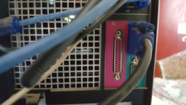

The PC has as parallel port as does the controller box that came with the machine.
If I understand your meaning, I need a cable with parallel ports on both ends.

26 Jun 2020 01:31 #172770 by dlw
Replied by dlw on topic USB connection
Photos:
Back of PC.
Back of controller that came with the machine.
I have already ordered a USB to parallel port cable as advised by the seller and others.
Exactly you need a cable with parallel port on both ends. The USB to parallel port cable is useless for LinuxCNC.
The question now is: Do you have a pin out for the parallel port on the controller board? You will need to know which pin of the connector is connected to what signal on the board.
