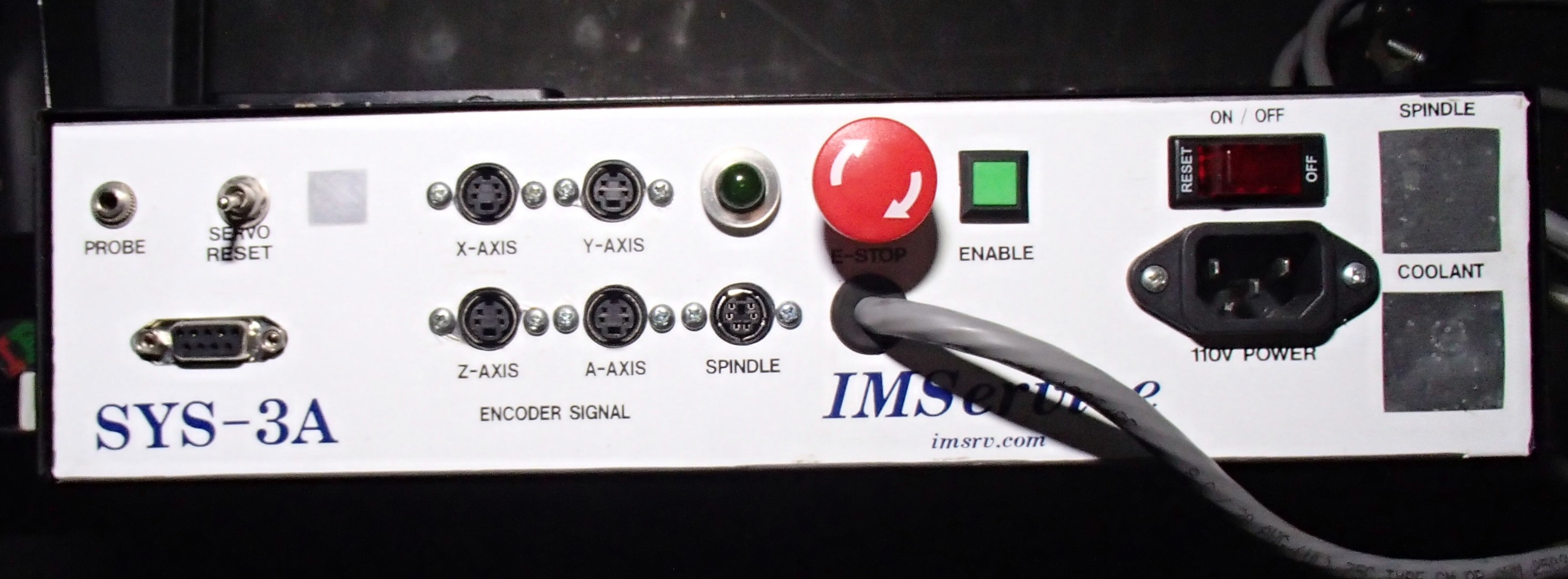

I always thought that Sherline controllers were parallel port. Do you have any documentation for the controller or maybe some pics.

03 Jul 2020 09:16 - 03 Jul 2020 09:28 #173498
by Oz_gadget
Replied by Oz_gadget on topic Sherline Lathe on LinuxCNC connectivity assistance
Last edit: 03 Jul 2020 09:28 by Oz_gadget.

03 Jul 2020 09:25 #173499
by phillc54
Replied by phillc54 on topic Sherline Lathe on LinuxCNC connectivity assistance
Yeah, that is serial or USB, you will need Mach for that.
www.imsrv.com/imservice_controller_model.htm

It may be worth contacting IMService to see if you can change the interface from serial to parallel.

A picture of the insides would be helpful to see if the serial part can be removed and the rest made to work with a parallel port.
Mach can not do serial, and that for sure is not a USB.

A quick brows of imsrv.com shows that the servos they use are step/dir, and they do sell a parallel port version of the control box. It might be simple to excise their serial control board and replace it with a parallel port breakout board. Imsrv.com might even sell you the pieces to make the change. It may be worth trying to contact them. (No idea how helpful they might be. )
