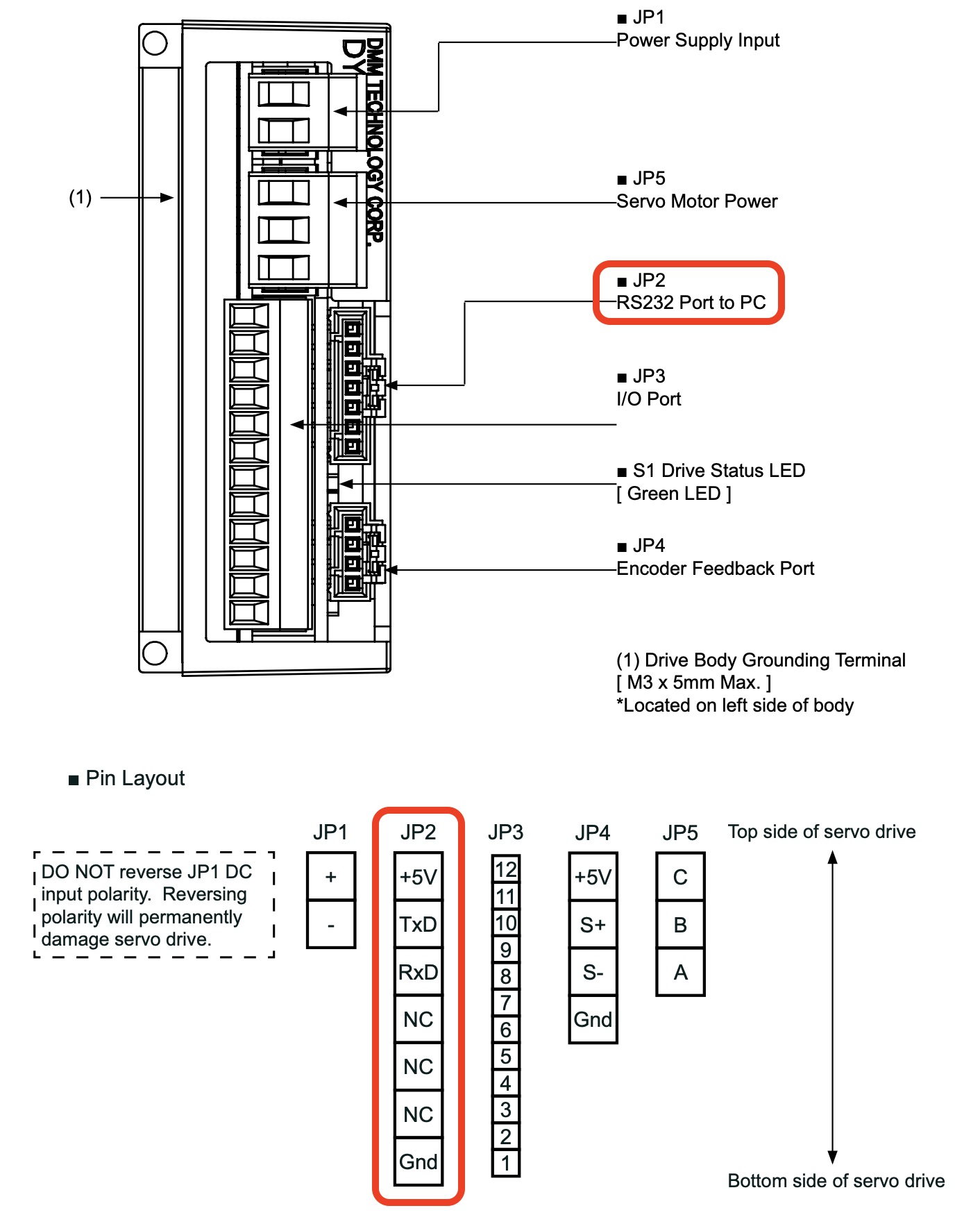

Hi, I am planning on retrofitting a late with DMM motors with multi-turn absolute encoders -
Link
I am new to LinuxCNC so this would be a double challenge. The idea is to use the encoder's positional information to HOME the machine. I found that LinuxCNC supports that function with the HOME_ABSOLUTE_ENCODER configuration setting.
Could you please suggest what would be the right hardware for such setup (besides the motors and the drives)?
I am trying to avoid using a very old PC. There are some inexpensive industrial PCs with parallel ports - Link
What other hardware I would need between the parallel port and the servo-drive?
As an alternative, there are also the MESA PCI boards - Link
Which MESA board(s) I would need for connecting the absolute encoders?
Do you know any step-by-step guides with wiring diagrams for a similar setup - spindle control, two step/dir drives, and two homing absolute encoders?

What type of absolute encoder interface does the drive provide to the controller?

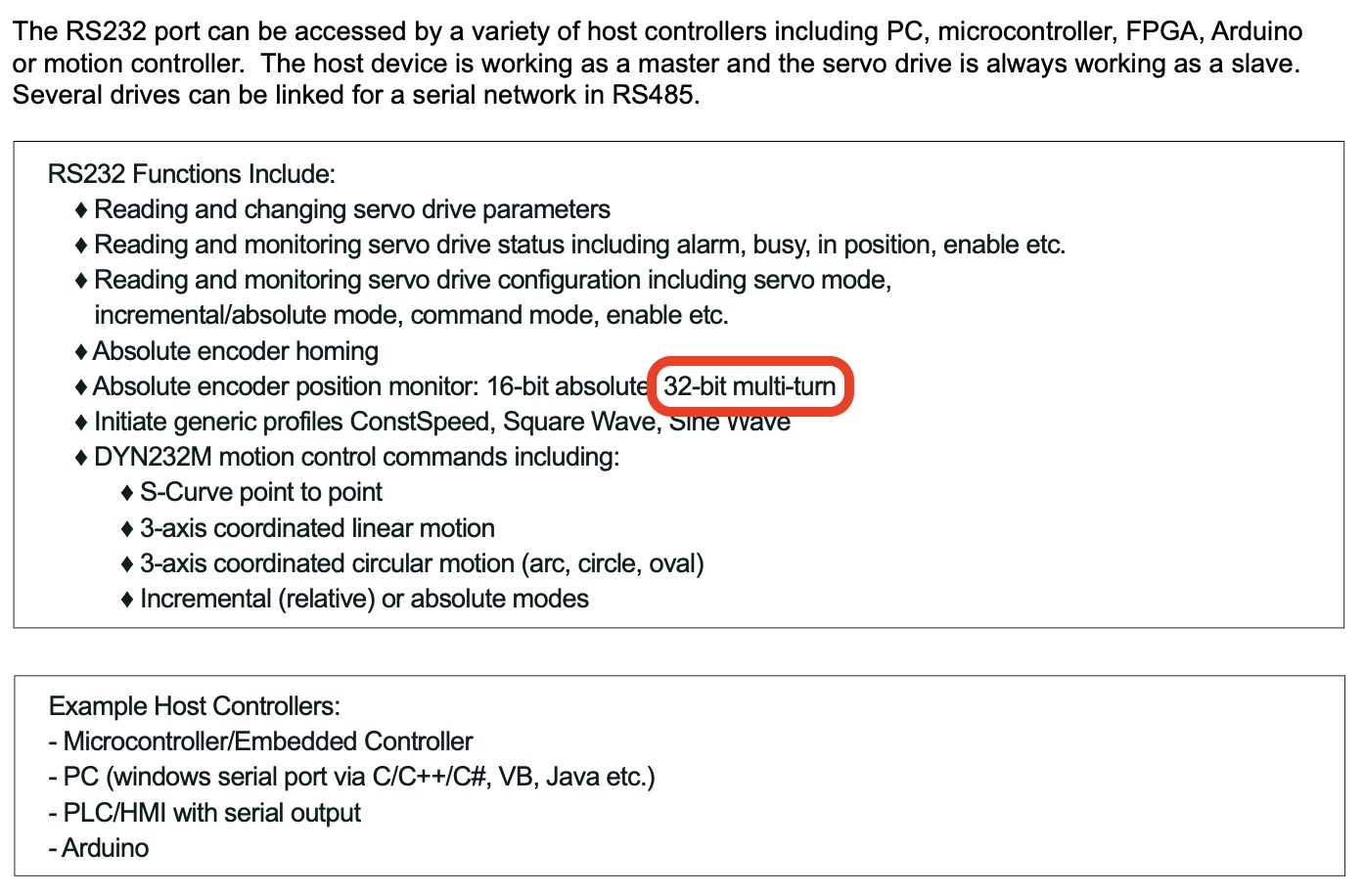

The drive does not provide any position feedback to LinuxCNC (other than via the RS-232 port)
so it looks like a fair project to make use of the absolute encoders for homing

I am not sure I understand.
Isn't that the purpose of the RS-232 port?The drive does not provide any position feedback to LinuxCNC

That drive doesn't seem to have any interface for neither control nor feedback that will work with LinuxCNC?
The feedback port seems to be some kind of serial interface (S+, S-) and there doesn't seem to be any step/dir nor +/-10 V control input either (unless through the IO port JP3?).
Does the drive support position or velocity control through the serial port? Regardless, I'm not sure that is supported by LinuxCNC.

The drive has inputs for step/dir/cw/ccw/quadrature and analogue +-10V, so yes it can be used with LinuxCNC by using any of those types of control with a parallel port or Mesa anything I/O cards or mesa 7i96 or 7i76/7i76E, all that as open loop so the loop is closed only in the drive, not in LinuxCNC. All this does not require adding or changing anything.
It can also be used with the analogue controls with a Mesa 7i77, but would require adding linear scales to the machine for closing the loop in LinuxCNC, as the drives do not provide any kind of feedback to the controller or LinuxCNC, besides the "on position" signal that is for this use useless.
