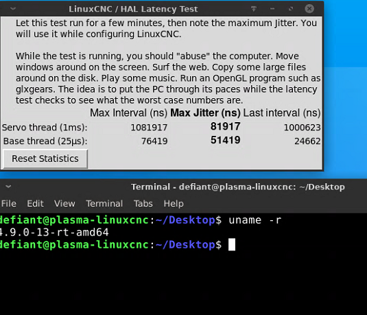

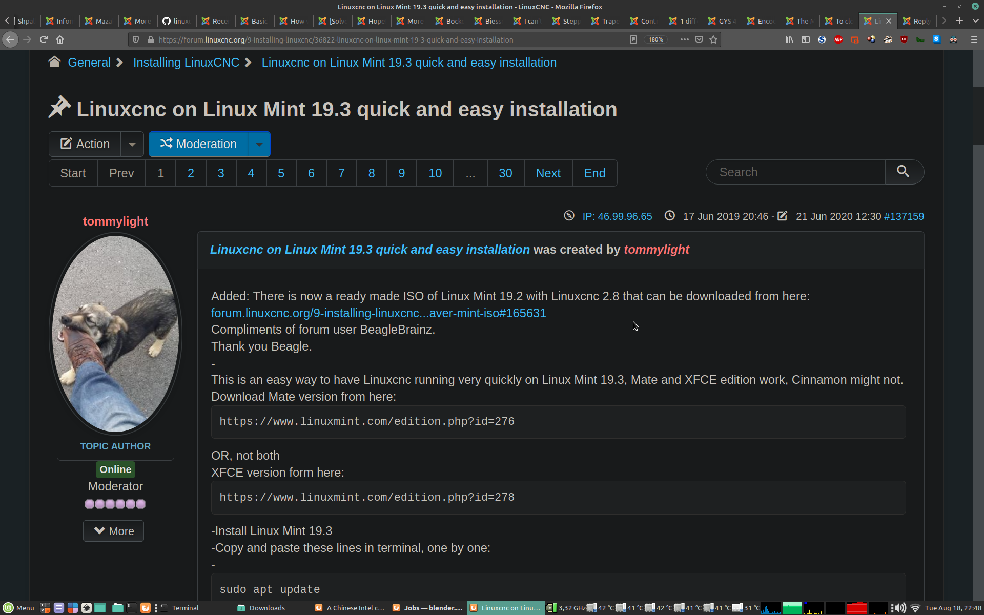

You need to be running the PREEMPT_RT kernel for the 7i96
If you follow these instructions, its pretty quick. I know there are other instructions for Mint 20 but I think there were a couple of niggles and I know this one works.
forum.linuxcnc.org/9-installing-linuxcnc...nd-easy-installation

Thanks Rod. I'm installing now...

It is literally at the top of the post that Rod linked:Is there anything wrong with the Mint 19.2 ISO or is it just because it's 19.2 not 19.3 that no one is recommending it ?
