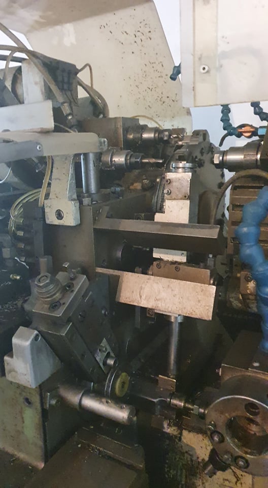

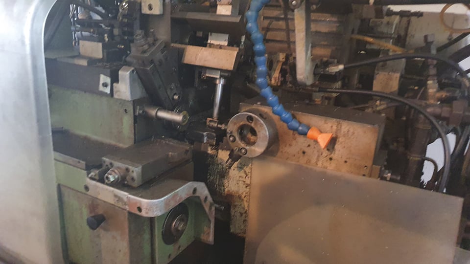

Hy. Thanks for the good suggestions. I have abandoned both of my previous ideas and have been thinking of doing 8-10 little grbl machines but I can't find any professional way to do that and cause I am doing this for someone I don't want to go there every month cause something failed. So if I could work this trough linuxcnc it would be the best. If i understand correctly i can control the speed of each spindle independently? It is not at the most important but it would be very good cause you have different sized drills and you would obviously need different speeds. If the control of the speed would not be possible the control of the 8 different z-axis movements would be crucial. The best scenario would be if I could do both. So my machine is composed of the first station that is essentially normal lathe with 3 axis and main spindle. Then a small robot arm moves that part to the turning wheel which has clamping jaws and you can then work on the piece with different drills and milling cutters. If the lathe part and the turning wheel part are on 2 separate linuxcnc machines that would not be the problem. I have made some pictures of the machine so you could imagine how it would all work. If you have somewhere documented the things in more detail, that you were talking about then that would be werry helpful. Is it in the linuxcnc document?

26 Jul 2020 17:52 #175938
Replied by tommylight on topic Retrofitting rotomat/screw machine
That looks much simpler than what i saw on the net, so might be even easier.

That would be hard cause there are no electronics haha. this machine was built before they had any good electronics for this kind of machine. It runs on a principle that you cut out oval rings and that oval rings spin and push the hydraulic fluid which pushes the spindles forward and then spring pushes them back. We are planning to mechanically disassemble the machine and put on the ballscrews and motors for the z-axis instead of the hydraulic movement. The only electronic is for the motors for the spindles, which speed you set with the potentiometer, and I think some simple logic board to control the movement of the robot arm and the turning wheel. Now the procedure is extremely long to set up the part. You have to laser cut each oval ring cause with them you set the movement of the spindles. It was only worth taking few million parts, but with this retrofit, 100,000 would be worth taking. The electronics would be changed out entirely.
