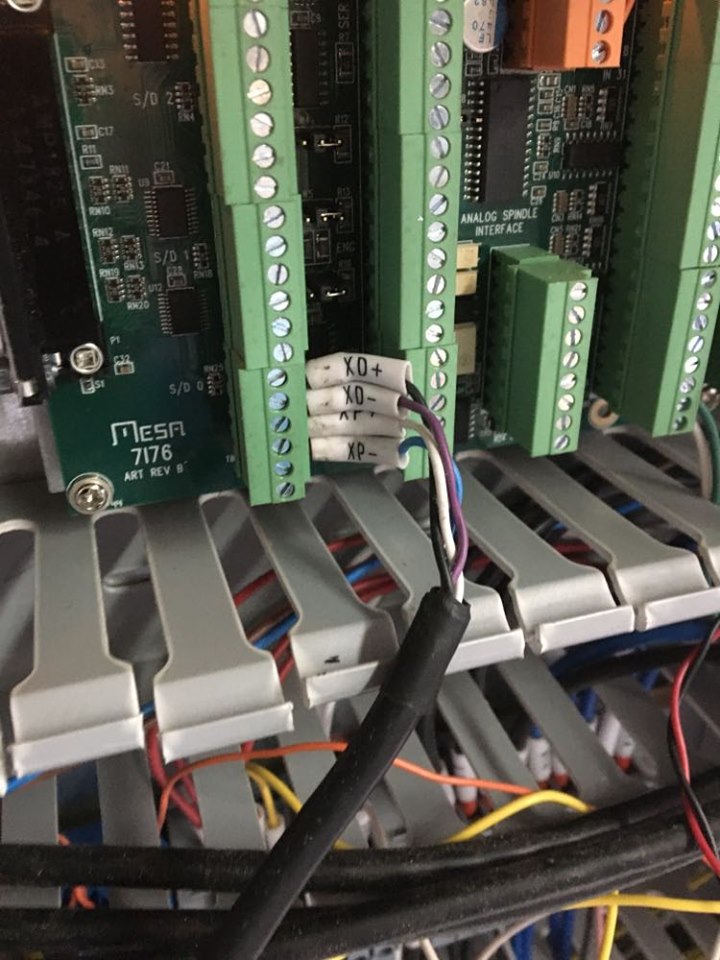

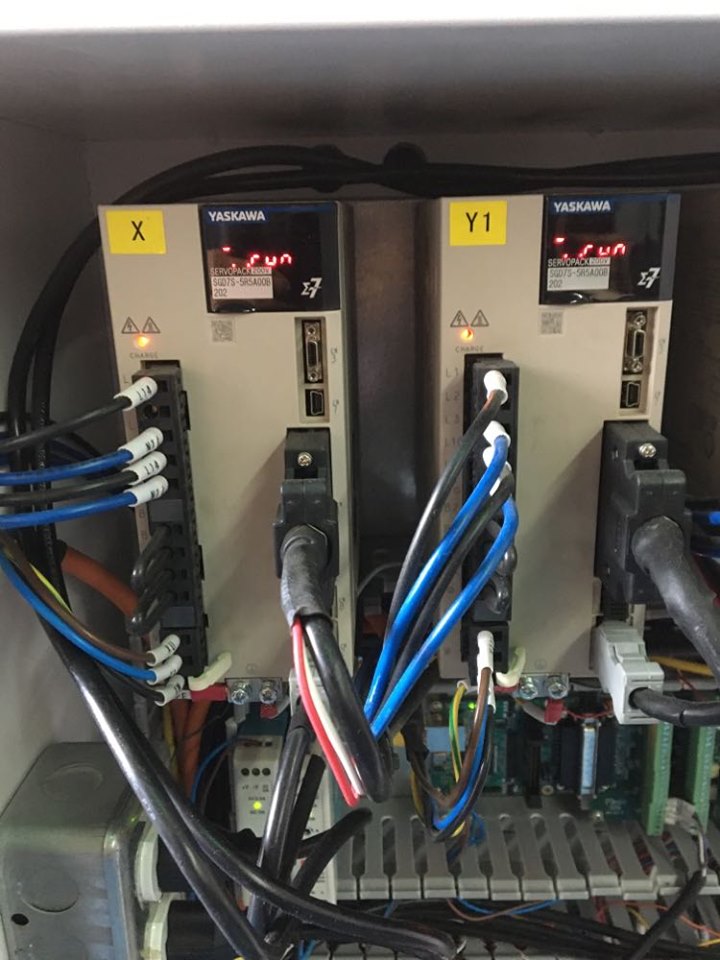

Has anyone worked with these drives?
It is not moving at all. Initial powerup.
I can see pulses output in hal config.
linux mint 18.3, linuxcnc 2.9 pre
HAL
INI

27 Jul 2020 15:11 #176085
by bevins
Replied by bevins on topic Yaskawa SGD7S drives cant get to work with 7i76
It looks like it is not connected to correct TB2 on 7i76 but I assure you it is.
- bevins
- Posts: 1947
- Thank you received: 338
27 Jul 2020 15:31 #176089
by bevins
Sorry, McStupid here.
Scale was too small. Fixed er up. She moves now....

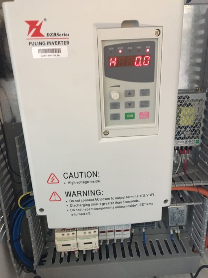

I have all the axis moving and all I/O except spindle stuff and ATC.
Chineese: Have to rewire all the home and limit switches. They put them all N/O. WTF ???
Have to tackle Chioneese spindle/driver next... ITs a Fuling Inverter DBX series. and I dont have a manual. ARGGGG....
- Posts: 22002
- Thank you received: 7488
27 Jul 2020 17:26 #176103
Replied by tommylight on topic Yaskawa SGD7S drives cant get to work with 7i76
Get us some picture of the spindle/drive, maybe we can extract some info from it.
- bevins
- Posts: 1947
27 Jul 2020 18:31 #176115
by bevins
- bevins
- Posts: 1947
